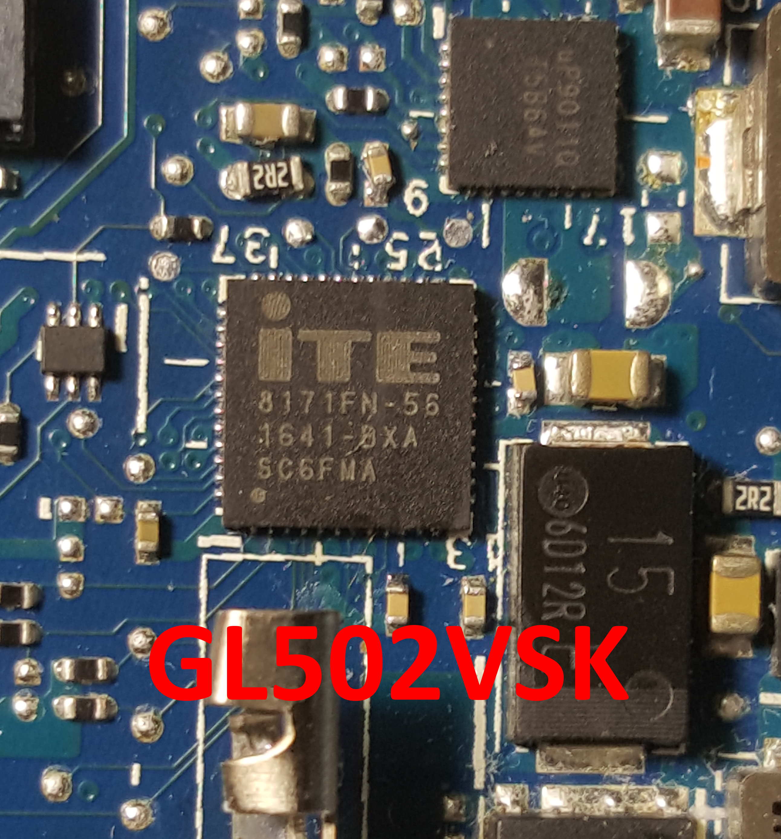

    Hi Everyone!
    I have an Asus ROG Strix GL502VM (the mohterboard says GL502VM Rev. 2.1 but it has an i7-7XXX Proc. so I think it actually is GL502VMK idk...)
    The problem is with the keyboard. The power button works but every other key doesn't.
    What I tried:
    -Check the keyboard with Vertyanov Keyboard tester (Everything seems fine)
    -Re-programmed the EC chip ITE8171FN-56. (Didn't work, flashed ok but verification failed every time at 82%.)
    -Replaced ITE8171FN-56
    -Reprogrammed new ITE8171FN-56. (It flashed and verified ok but keyboard still dead)
    I don't know if I need to check the main BIOS, maybe Main Bios is rewriting EC Section on boot to the ITE8171FN.
    Any ideas?

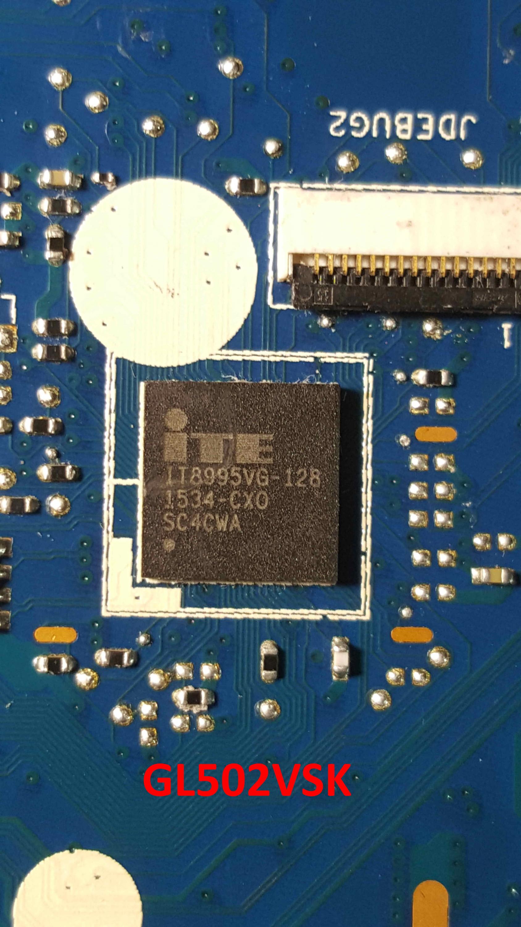

                The problem (for me) is understand how this system works.
                This notebook (gl502 series) has two ITE chips, the first is the IT8171FN-56 / BX for the keyboard and can be programmed via the keyboard port, the other IT8995VG-128 / CX has a dedicated port for its programming. I wanted to understand where its firmware is stored and if it has an internal memory, etc
                  • 21841

                    Do you mean my card compared to the GL502VM model? , this and the gl502VSK have the same chips but positioned differently, and some components have the same identifier. I think the working principle is the same.
                      I'm also wondering this. I have a board view but doesn't have an schematic.

                        I think the firmware is stored in IT8995VG-128 but I don't know how to program.

                          Its the ITE8171 that gets programmed by a vertyanov programmer
                          GL502VM IT8171 KB_pins=30 LEFT DOWN FLASH=56 PD0=29 PD1=20 PD2=15 PD3=23 PD4=14 PD5=16 PD6=12 PD7=30 BUSY=26 STB=18 AFD=28 INIT=21 SLIN=19 KSI4=22 KSI5=24

                                  Now, I'm trying to flash the EC, Trying with 8171 I only can flash 56K of the EC Dump.
                                  So, I tried programming the IT8995 (I took precautions and this time dumped correctly before flashing)
                                  I did flash the EC IT8995 with success. But I keep having the keyboard problems.
                                  I'll check the boardview to track down the connections but I really think is firmware related. Because some dumps I try with IT8171 resulted in CapsLock led always on and others shut it down.
                                  Any ideas what should I check next?
                                  UPDATE:
                                  I found out that Main Bios DOES rewrite the EC Bios after first boot.

                                    Re: GL502VM Rev. 2.1 Keyboard Problem
                                    SOLUTION
                                    I finally found a solution for the keyboard problem.
                                    I found the Asus Keyboard Adjustment tool, extracted the .exe file and inside the ./.rsrc/1028/BINARY directory are located 4 56k sized FW_NK000XXXXX files.
                                    These are different keyboard firmwares that can be flashed to IT8171fn-56.
                                    For the GL502VMK board I used FW_NK0003000B and flashed it with Vertyanov.
                                    I'll post these files as attachments for anyone that has the same problem.
