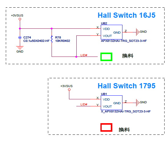

          LID# should be 3v. Try removing lid switch from mb/powerbutton board. PM_slp s3/s4 will generate only after power button press and are generated by PCH.
          By lid switch do you mean UB2? LID# is not shorted, but I applied 3.3V from my bench power supply and RSMRST# still won't go HIGH.

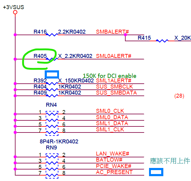

              AC_PRESENT Is low 0V find out RN9 any short this Voltage is pull up from +3VSUS
              PM_PWRBTN# = 0V is low, Missing BATLOW# will prevent PCH going out from S5

                Couldn't find RN9, had to measure R405, but it was not shorted and AC_PRESENT is not shorted either.
                AC_PRESENT and PM_PWRBTN# go HIGH (3.3V) for 12 seconds if I press power button once.

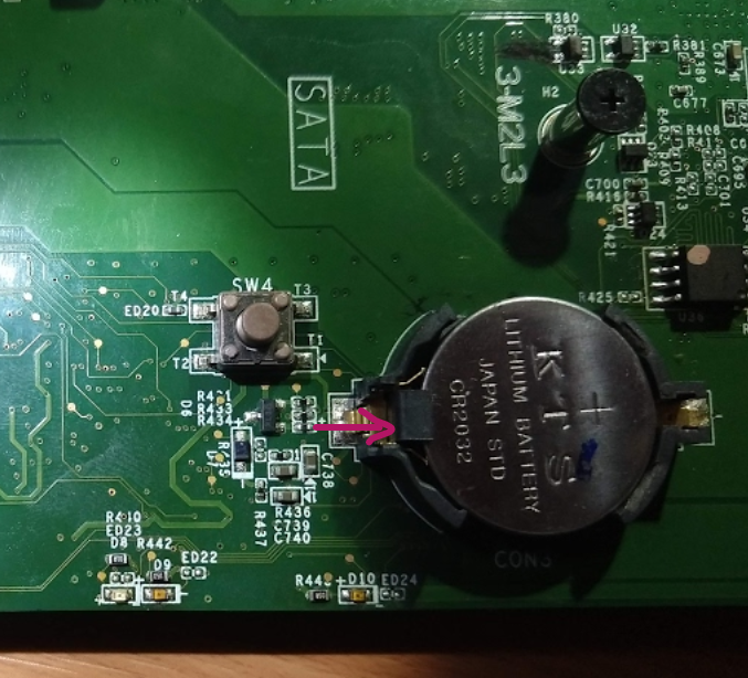

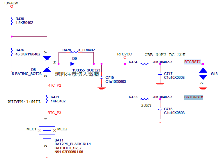

                  Find out any short in RTCVCC RTCRST SRTCRST
                  • orientalsniper
                    • Apr 2013
                    • 459
                    Re: MS-16J61 water damage
                    MS-16J61 seems to be different to MS-16J51 in the RTC circuit.
                    But R434 does not appear to have short and it's connected directly to (+) side of CR2032 battery.
