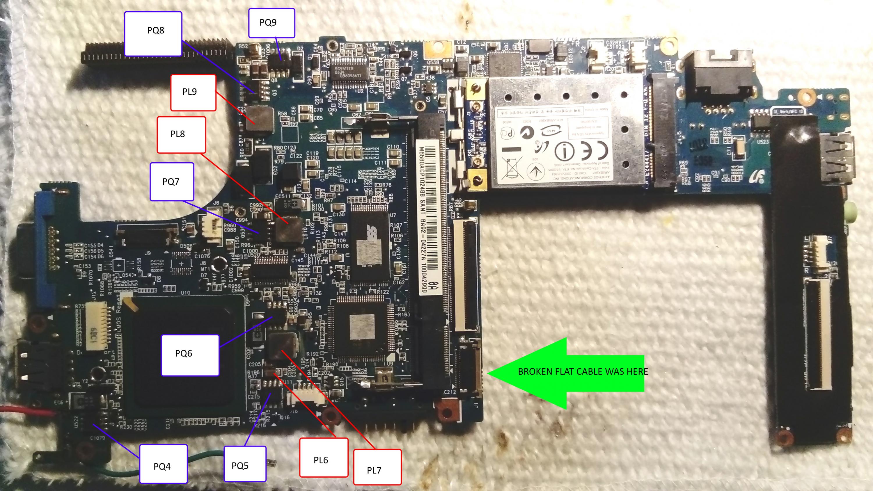

    Hello, I am total amateur - cleaning, replacing cooler, disassembling and fixing power jacks etc is what I know.
    trying to fix samsung q1.
    power jack was defective. and after successfully replaced it managed to start os on it - xp. after only minute or two laptop suddenly died.
    what was strange is that battery reported as full in windows. sound worked, display worked. that is what I noticed since I had only minute to work with.
    later, after new disassembling I found that flat cable was defective. and that is one issue. https://www.badcaps.net/forum/showthread.php?t=79007 - thanks on help.

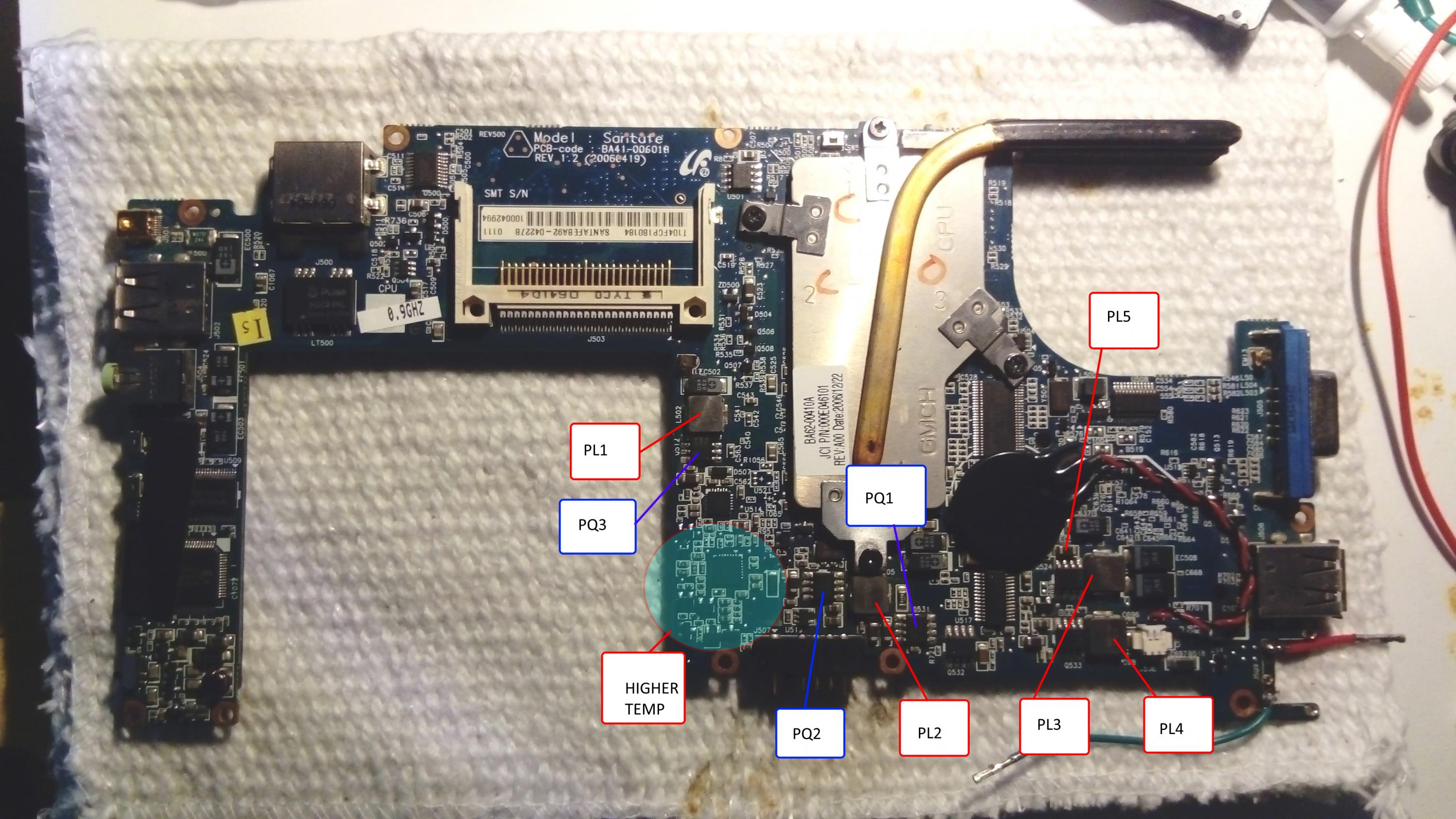

    other issues are - first and only: laptop wont turn on , not reporting anything. no lights no anything.

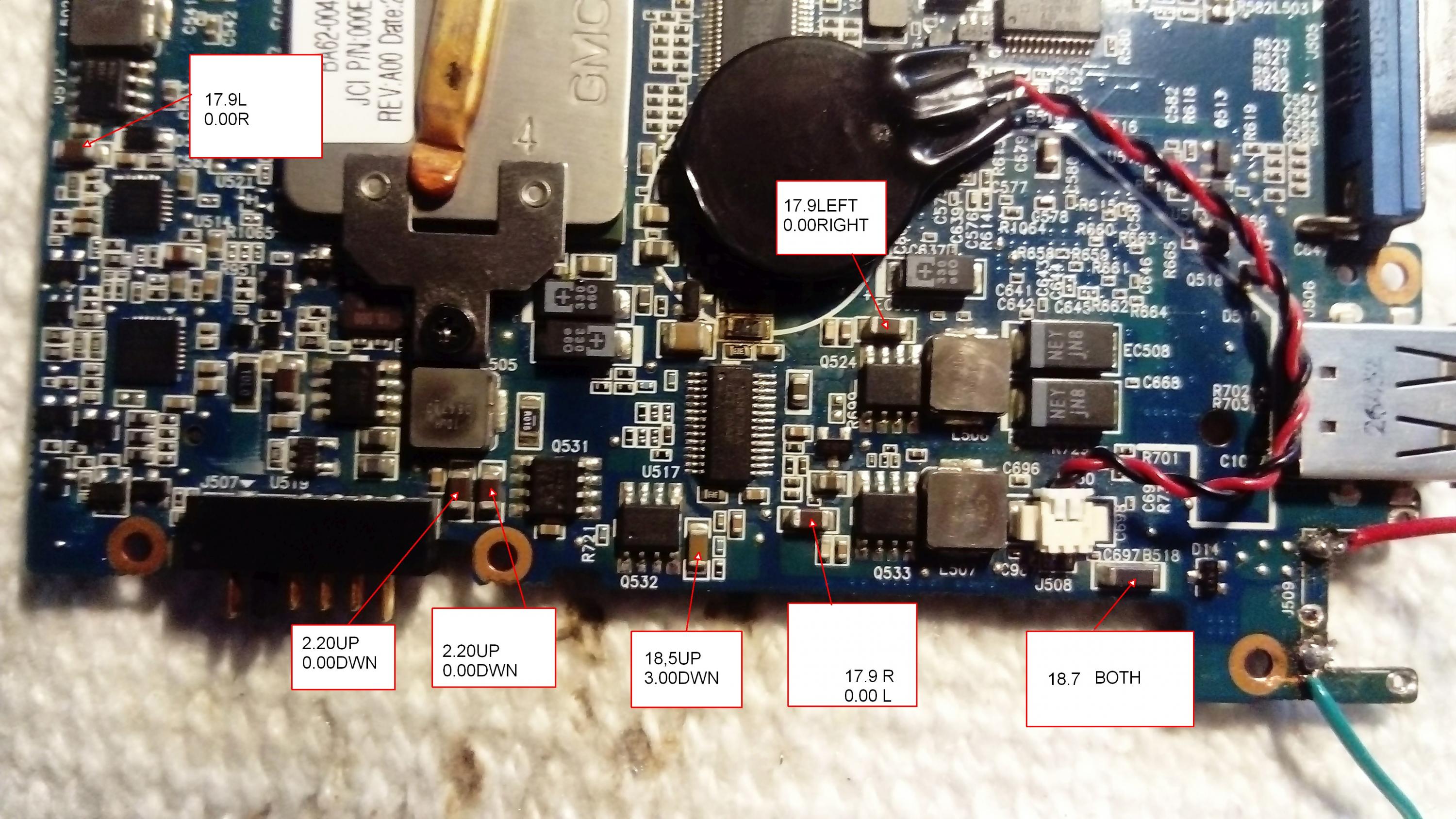

    As seen on pics I checked some components, thanks to reading badcaps forums.
    PL1 760
    PL2 450
    PL3 940
    PL4 1620
    PL7 94
    PL8 36
    PL9 15
    mosfets showing values except pq4 and pq5 - showing 1 (OL).
    one area is warmer.
    anyone have idea what to do, where to start? thank you.

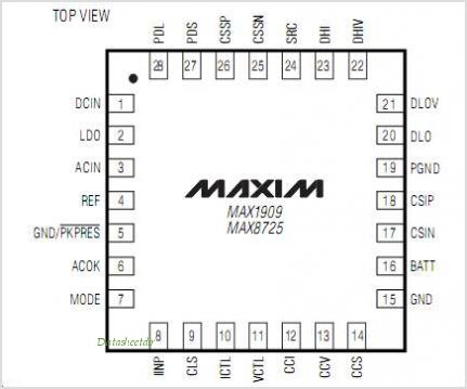

    test the voltage on P667 should get 19+V both side of this resistor in your MOB charging IC is U517 but the the Schematic U516 test the voltage pin 1 2 3 6 22 25 26

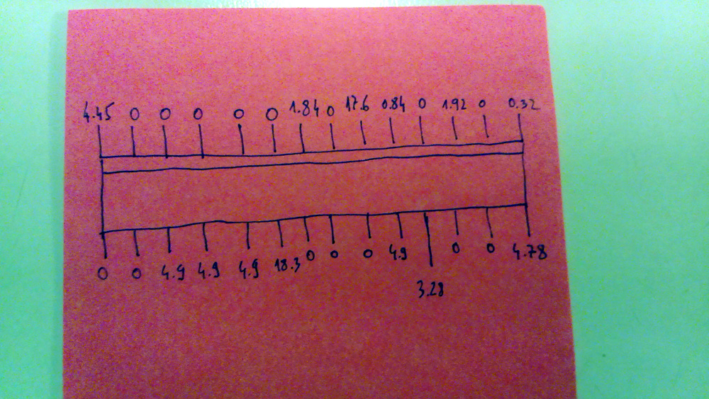

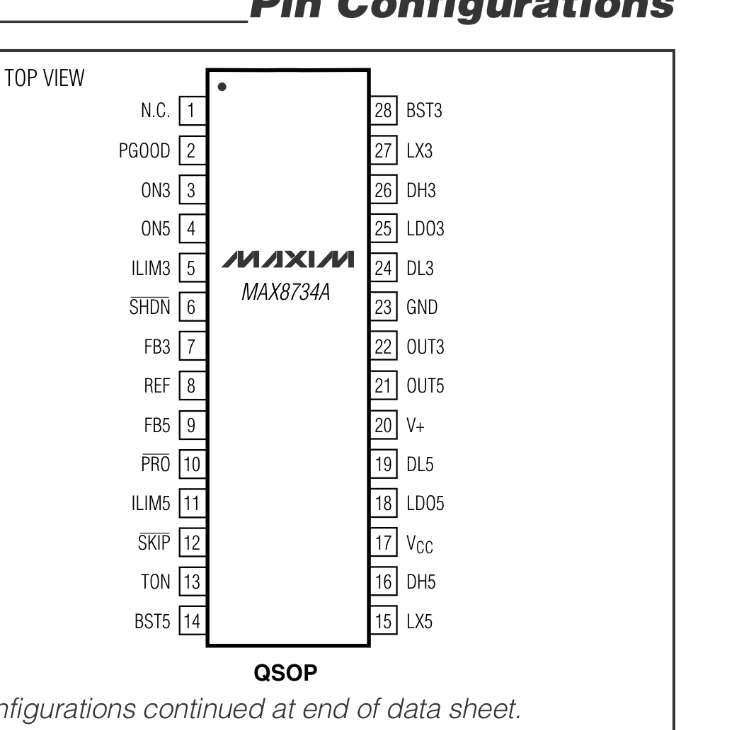

      I tried to check what you suggested. and I found .. - cant find P667 exactly on board while in schema page 14 I found C667 and on page 27 is R667
      (btw, how to read that stuff,lol)
      U517 - (in my case it is MAX8734AEEI 0648) I added attachment with all readings I wrote down.
      I added pics with some resistors and caps readings. maybe helpful. (there is C697)
      also, my power adapter is 18.7V - hope it is enough for this device? I have another which shows 19.9V. It is for HP saying 3.5A while for samsung is written 3.18MAX. Maybe I can use Hp?

        My mistake find the U516 IC U517 is the 3/5V Regulator

          Your power pin mesurent on MAX8734AEEI is bit confusing, are you using a original charger 19+, most probably 19+v passing through

              Here is what I managed to read -
              1-12.56
              2-17.3
              3-18.2
              4-18.2
              5-18.2
              6-17.6
              7-17.9
              8-18.70
              9-14.52
              10-2.49
              11-4.16
              12-0
              13-0.1
              14-0.1
              15-0
              16-1.75
              17-0
              18-2.55
              19-0.02
              20-0.02
              21-0.02
              22-0
              23-2.3
              24-2.3
              25-2.3
              26-0
              27-0
              28-14.4

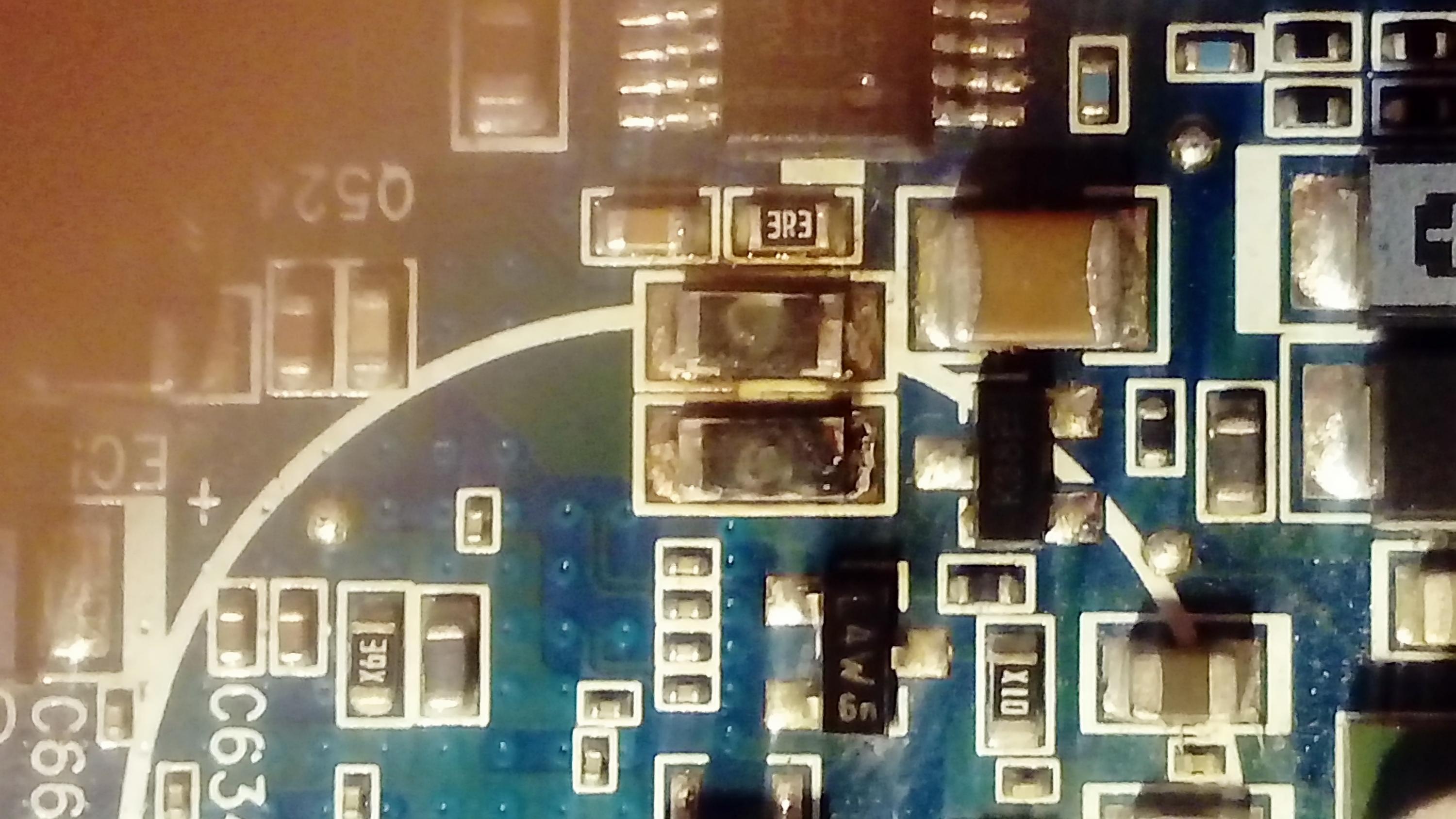

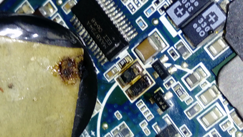

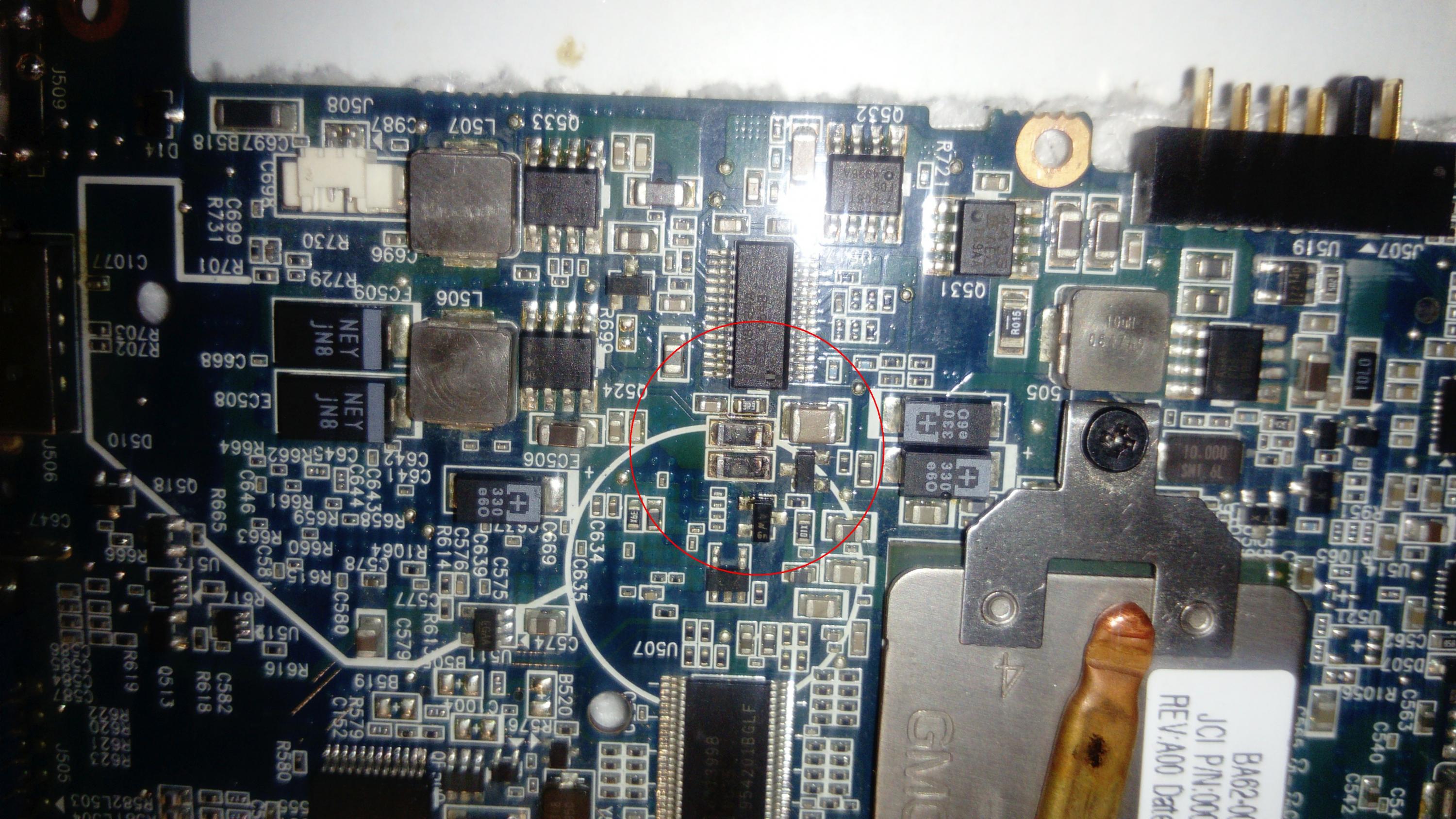

                also, I found possible additional problem: these two are roast hot. they are under battery - presuming cmos battery.
                how to test them? they are burning hot, but cant find are they look roasted because of battery foil or they are grilled...
                • Techtiger
                  • Oct 2014
                  • 1601
                  • france
                  Re: Samsung Q1 - no power no charging... anyone with will and time to help
                  1-12.56
                  2-17.3
                  3-18.2
                  4-18.2
                  5-18.2
                  6-17.6
                  7-17.9
                  8-18.70
                  9-14.52
                  10-2.49
                  11-4.16
                  12-0
                  13-0.1
                  14-0.1
                  15-0
                  16-1.75
                  17-0
                  18-2.55
                  19-0.02
                  20-0.02
                  21-0.02
                  22-0
                  23-2.3
                  24-2.3
                  25-2.3
                  26-0
                  27-0
                  28-14.4
                  There is a short in the MOB short to GND or Short SMD component like you have pointed out
                  Pin 1 19+
                  Pin 3 2.63+
                  Pin 2 5+
                  Pin 6 3+
                  Pin 25/26 19+
                  And the rest is not correct the components burned maybe Coil & Register try to clean the area with alcohol and with the help of a magnifying glass try to read code

                    Remove the bios Battery and Clean the area and send a clear snap around the area
                    • selfrepairing
                      • Aug 2019
                      • 18
                      • serbia
                      ok, cleaned and focused. tested with multimer. showing resistance, different, on both side.
                      • mcplslg123
                        • Jun 2015
                        • 7262
                        • india
                        Remove both of them and try to trace where the connection goes. That way you might find out the values of burnt components.

                          yes, already removed them. looks like this mobo is never ending problem. maybe bad power adapter causing all of this. thanks.
