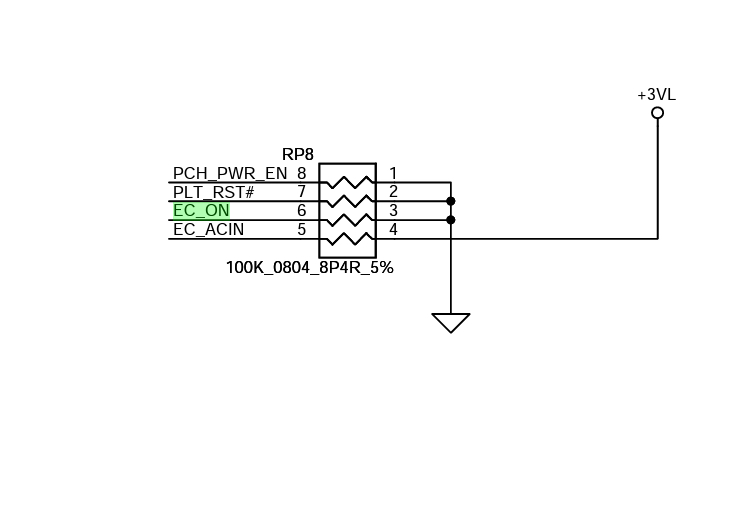

    I have this mb LA-A993 REV 2.0 and its not turning on. Dc jack light present. EC_RST# & EC_ACIN present but no EC_ON signal on KBC9012. EC_ON is the enable signal for RT8243A(PU301,pin 13) and hence i dont have +3VALW and +5VALW though +3V LDO and +5V LDO present on pin 15 and 14 respectively.
    I have replaced KB9012 and programmed it with a known good dump, flashed main bios with HP virgin bios with correct BID. Still no EC_ON. Replaced PU301 also-same no result.
    Impedance on all coils/jumpers checked and there is no short.
    How to proceed further? Why EC_ON signal is not generated by kbc??

        Have you looked at +3VL, RP8,DK1 etc

          Maybe the PR8 is faulty or PR315

              Thanks for replies to all. PR8 is not faulty and PR315 is ok as per schematic. I know EC_ON is active only after power button pressing. I have already mentioned in my description that its the enable signal for 3/5V regulator ic and hence i dont have 3/5V ALW signals. Power button drops to zero and rises on pressing-so its fine. +3VL is present and i have looked on DK1 and found nothing wrong.
              Btw, i wouldnt have posted here if it was very simple thing or if the schematic can explain the fault. I have probed thoroughly but couldnt find anything wrong in my analysis. Hopefully, someone here has encountered it and knows how to rectify it.
              PS: I have another LA-A994P mb with exactly the same fault and this mb was tested ok but was lying unused for almost a year and now when i tried to turn it on , it too have developed the same fault-NO EC_ON. So , most probably, it should be a minor fault and there may a trick too rectify it. I came across ayoutube video with same problem but it didnt disclosed the solution as its a paid video by some indian techie.

                          The EC_ON works on a seperate power plane in the KB9012. Pin 112 is GPXIOD02,its ALW_PWR_EN in the datasheet,and EC_ON in the schematic.Page 232 (KB9012) has the power latch logic.Now, i`m a bit lost on the next bit on page 234 with the comparison behaviour,the best i can make out of all that VCDAC, VCCR,PA0_REG stuff is it needs VCIN0,VCIN1 to work on Pin 102 and 109.Those are VCIN0_PH , VCIN1_PH in the schematic.There are 2 references to them on page 44 .Check PR 25,26,27 .
