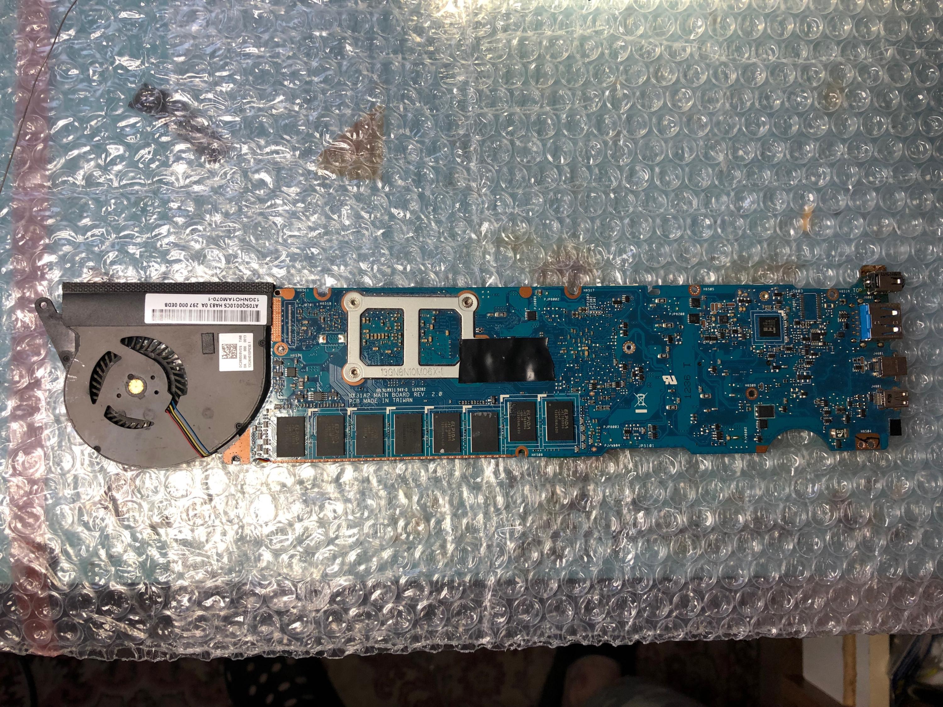

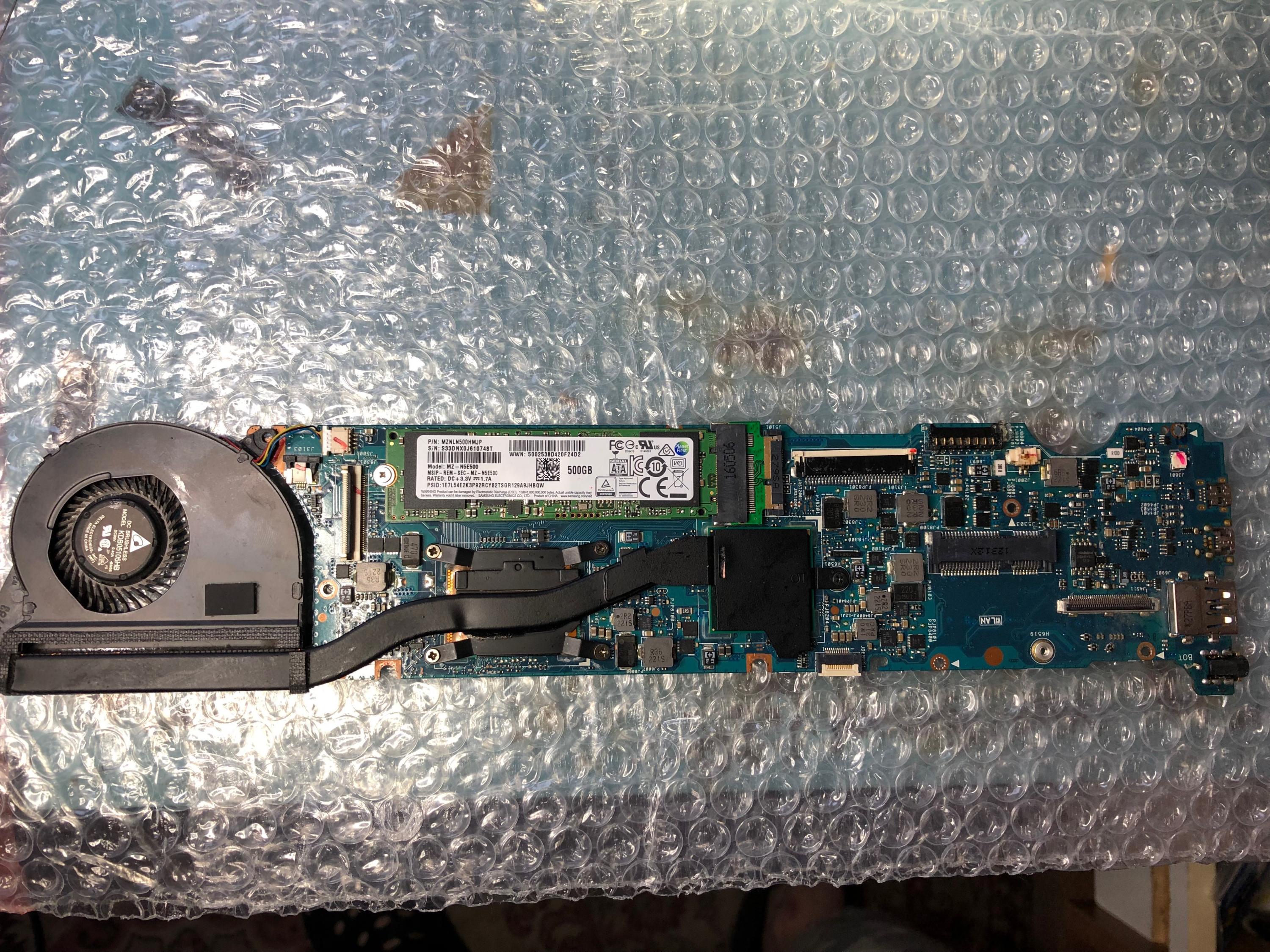

    I have problem with this laptop. Works normally on charger but not work with battery. Battery isn't detected in windows - new battery. Battery connector was damaged, I resolder all pins, but pins 4,5,6 aren't connected to PCB because of pads are lifted from board.. I mean my laptop should work on battery, other pins + and GND are ok, maybe there be problems with charging..

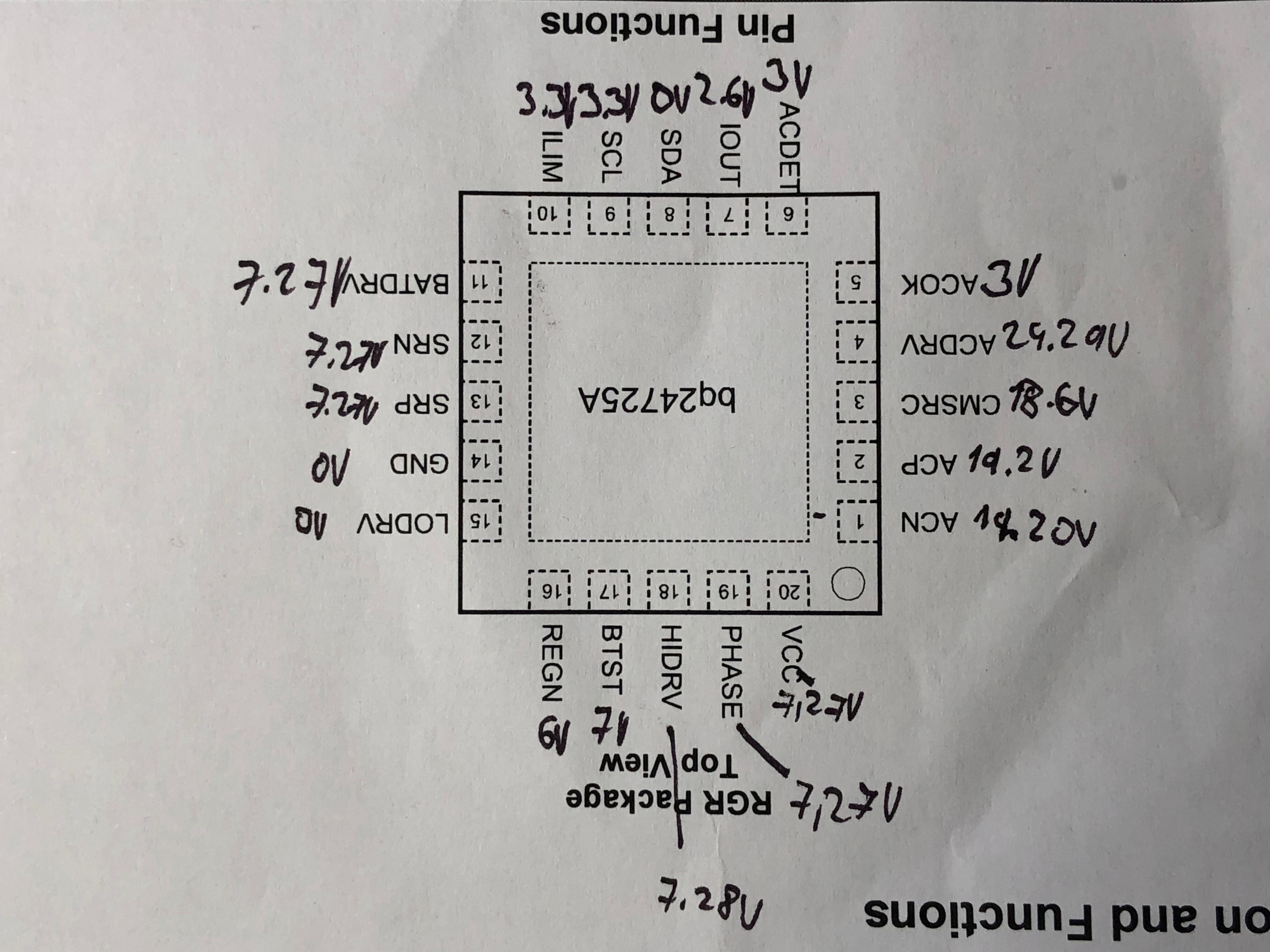

    After PQ8803 I have battery voltage, I tried replace charger IC BQ24725a. Still the same.Can someone help me with this? And have someone the Boardview? thanks.
    I attached measurement on charger IC with charger and battery connected.

    Re: ASUS UX31 not work on battery
    Run jumper wires from the connector to the associated resistors.
      I can't find the resistors PR6000, PR6001, PR6002 do u have boardview?
        What motherboard version ?
        The resistors you are searching are in bottom layer
          jasko_jacker - version 2.0 as you attached. I found those resistors thanks.. and all works fine now. Thanks for answers.
