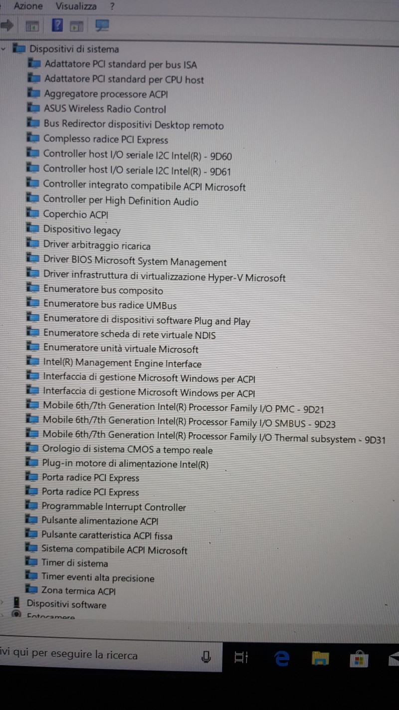

    Are you sure its not a driver issue .Any problems in device manager
    UX510UW ATK,ASUS Wireless Radio Control,Qualcomm or intel wifi driver,Intel Serial IO I2C Driver
    Intel Serial IO GPIO Driver (for UX510UWK)
    Intel Wireless Lan Driver (for UX510UWK)

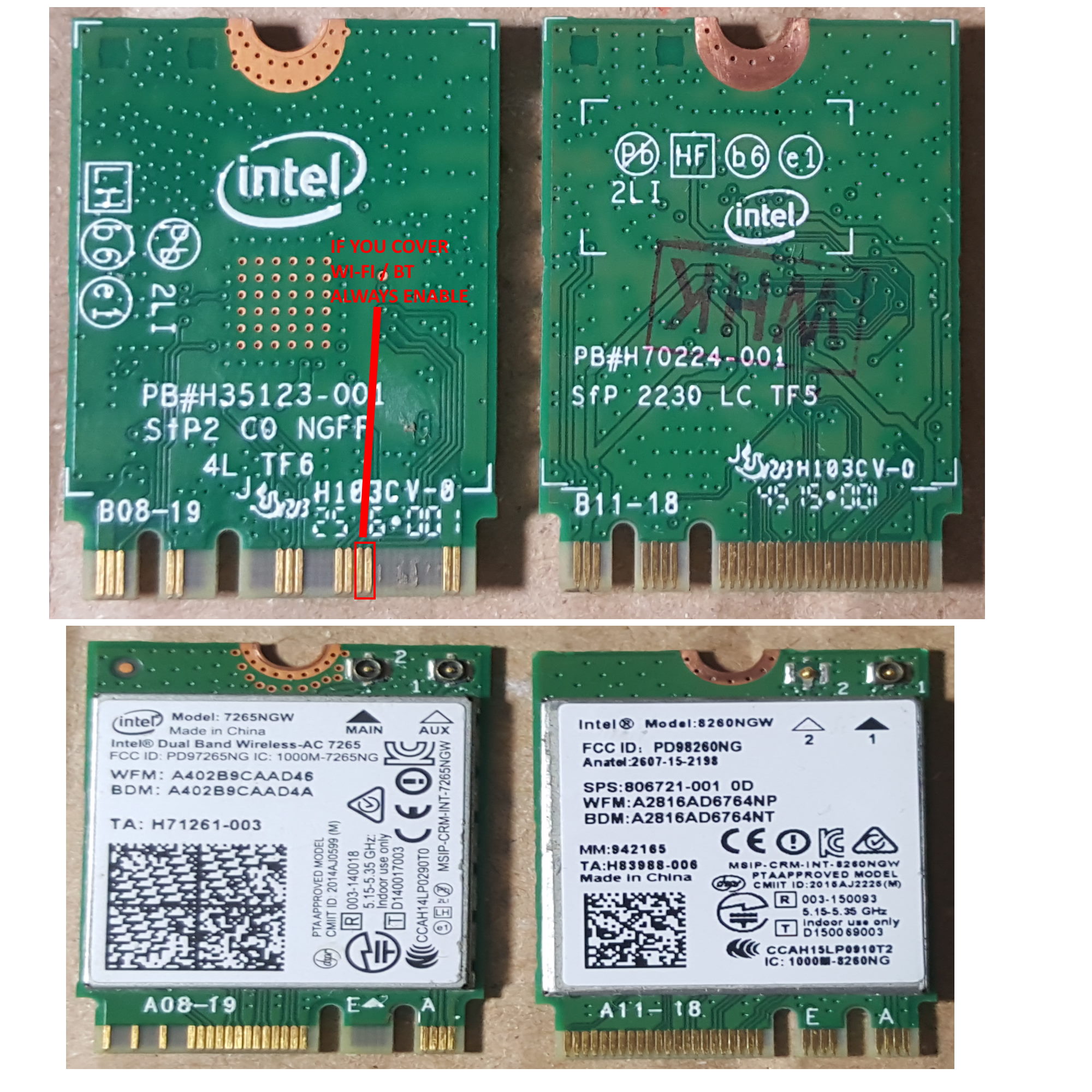

          Re: asus ux510uw wi-fi disabled by hardware
          Just to consider all option, the pic show the three card I tried. The intel 7265 is the card I supposed original.
            • 20781
            8260NGW and AC7265 are the original intel cards. Does LAN work ok,are you getting a MAC address.
            EDIT: The UW model has an AC7265 and the UWK has the 8260NGW .

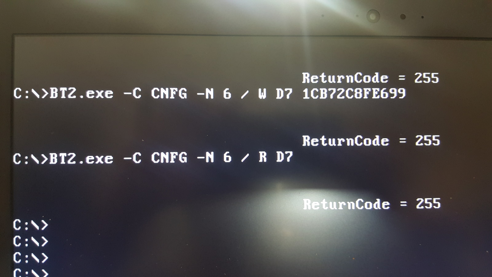

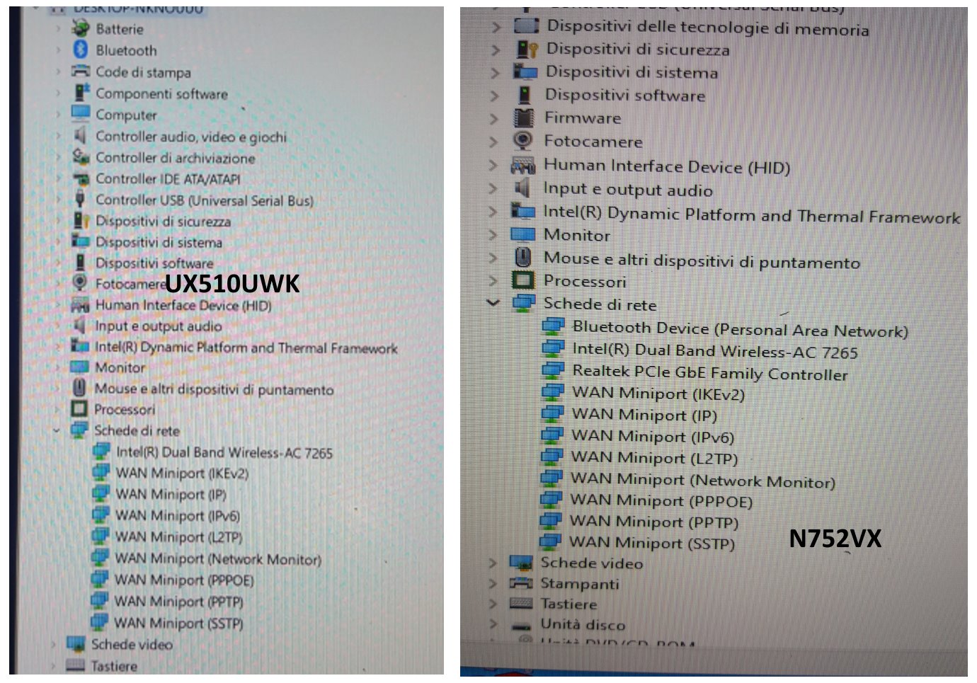

                      The LAN is missing in your pic on device manager. Do you have the MAC address on a sticker on the ram slot. I could try adding the mac to the bios manually but its easier to use asus bt2.exe tool .After adding a mac and getting an ip address through the lan ,the wifi may start working.
                      EDIT: i`ll post a bios to try. bios moved to - https://www.badcaps.net/forum/showthread.php?p=966610
                      EDIT: Added bt tool, zip password in pm .

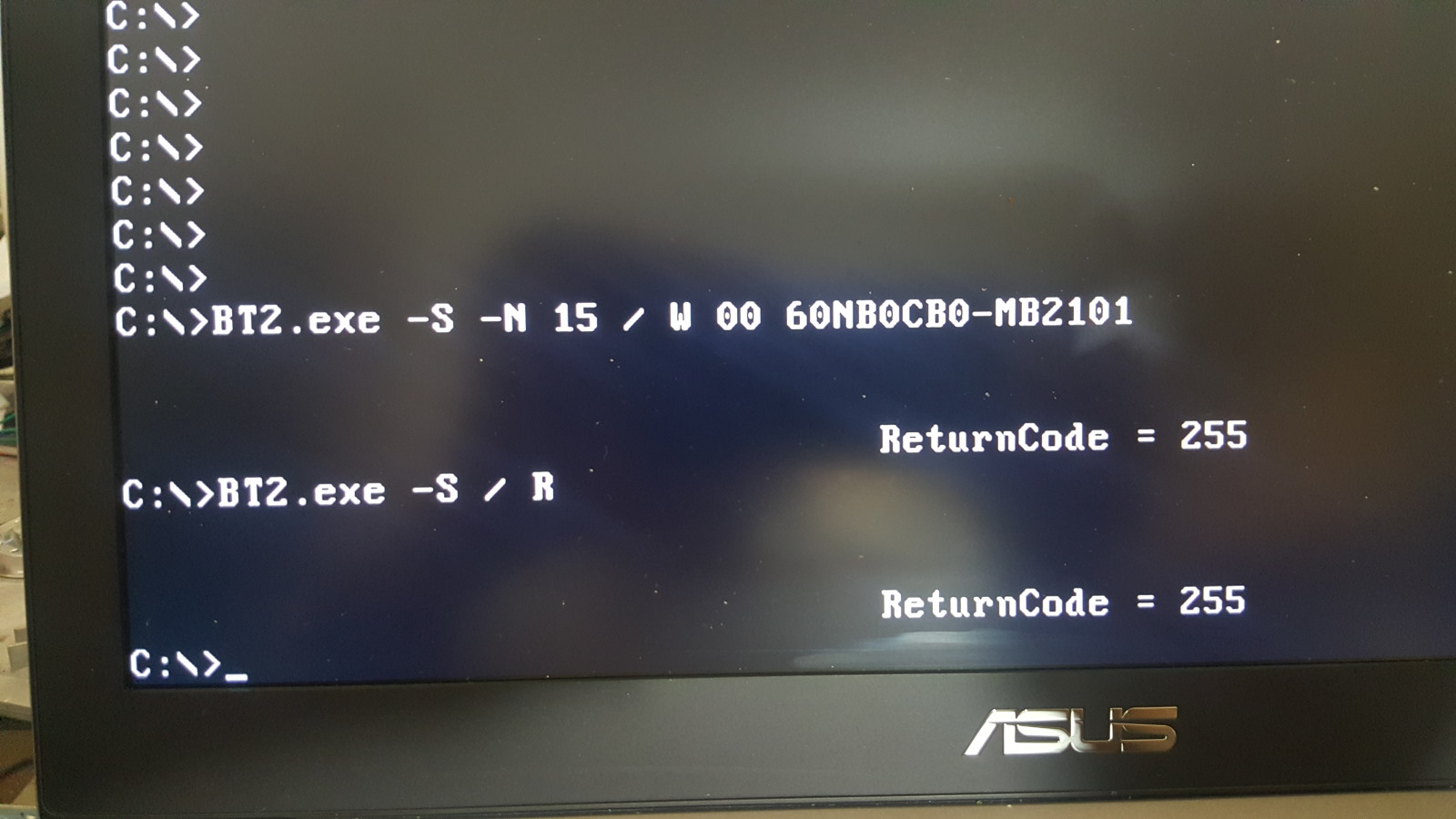

                        BT2.exe seems don't work , no change mac , no serial
                        I'm trying your bios
                        thanks

                          With HEX editor I found the MAC location (2301C2h) on the old UX510UW bios, if the location is the same, I can put the same MAC on UX510UWK bios. Unfortunally the chinese guy has remove all labels on board so I don't have the original mac.

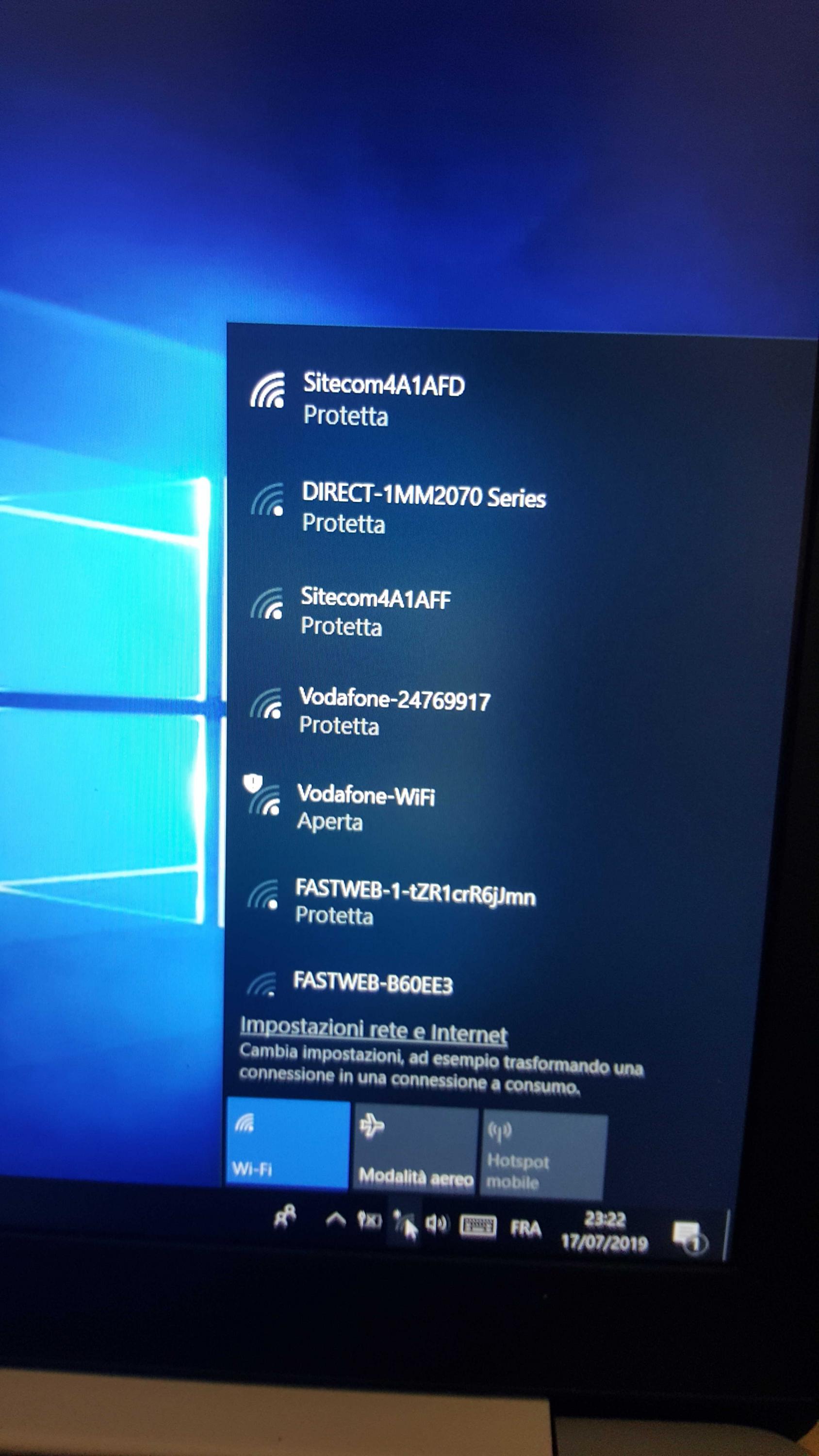

                            Last news,
                            I followed the instructions of the link, posted by @gabiz_ro,
                            and indeed wi-fi is on.
                            At this point I don't know whether to deliver it to the owner with this change. I also bought the original wi-fi card, Tuesday should arrive.
                            • jasko_jacker
                              • Oct 2014
                              • 1137
                              • italy
                              Good news,
                              I learned something else, this notebook accept only intel 8260 wifi card, otherwise it is necessary to cover two pins to enable wi-fi and BT.
