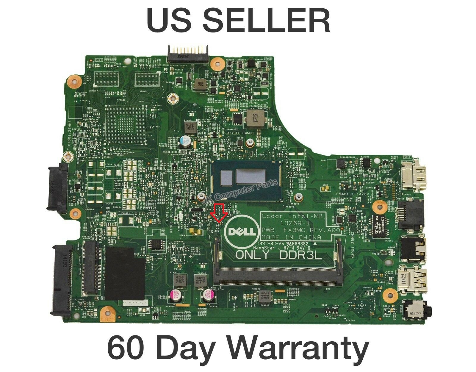

    dell 3542 laptop no display power on but 2 beep error. Ram is good. Ddr3_dramrst# signal not coming how to fix this error

    DRAMRST should be 1.3V approx it's upll done by R410 test it both sides

      Can't find r410 (have a r409, r401,403 but not a r410

        Re: Dell 3542 2 beep error
        Pics copy for internet.

          Thanks i's found it. Now 1.3v ok but same error (2 beep) ram is good

            Check all requirements Ram section

              Hmmm... All voltage are ok. (vtt, spd, sda, scl, dramrst, o.v ) but 2 beep

                you are saying you found R410 and now you have 1.3V whereas on the other hand you are saying dramrst 0v. Do you mean you have 1.3V on one side of the resistor and 0V on the other side??I beleive Dram_RST signal is supposed to be from PCH(single die in this case)

                  i'm R410 resistor replace. before 1.3v come ram 30 pin. but 2 beep.

                        test the RAM slot Pin 1 126 203 199 75 200 202 voltages ?

                              Pin 1 = 0.67v, 126 = 0.67v, 203 = 0.67v, 199 =3.39v, 75 =1.36v, 200 = 3.39v
                              202 =3.39v

                                OK now test VCC CORE, SYS PWROK, PLT RST ,(LPC FRAME, LPC AD you need a oscilloscope) try with the multimeter CLOCK X1801 XTAL 24.Mhz
