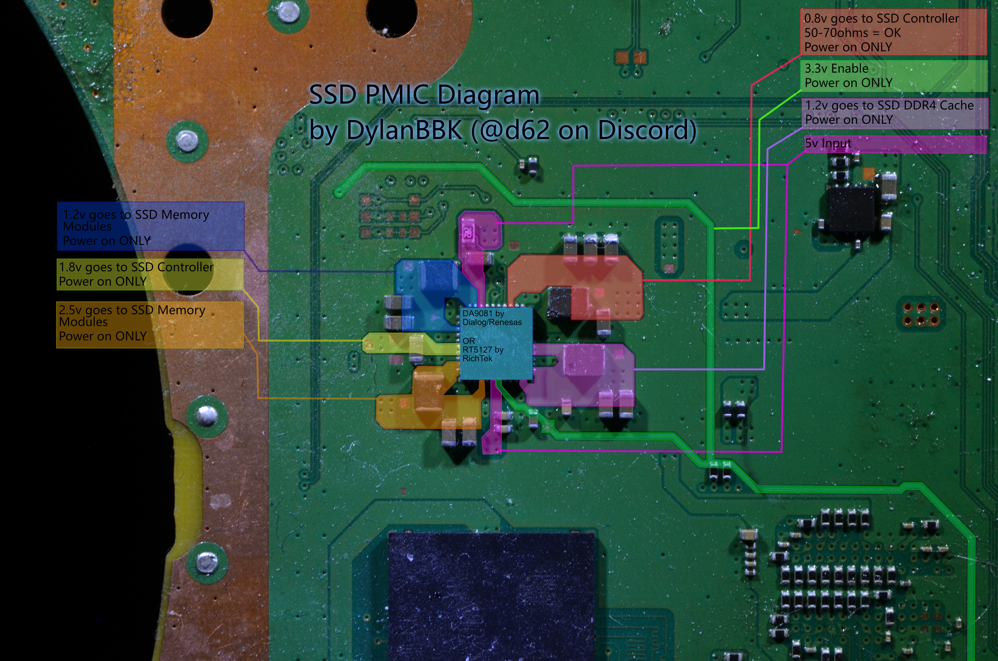

      Originally posted by ongobongo
      measure the ram power rail for shorts first. If there is no short, measure the rail in voltage mode when powering on and post the results here
      I'm getting all the correct voltages according to the picture below. I also get the 1.2v on the side with the DDR4.

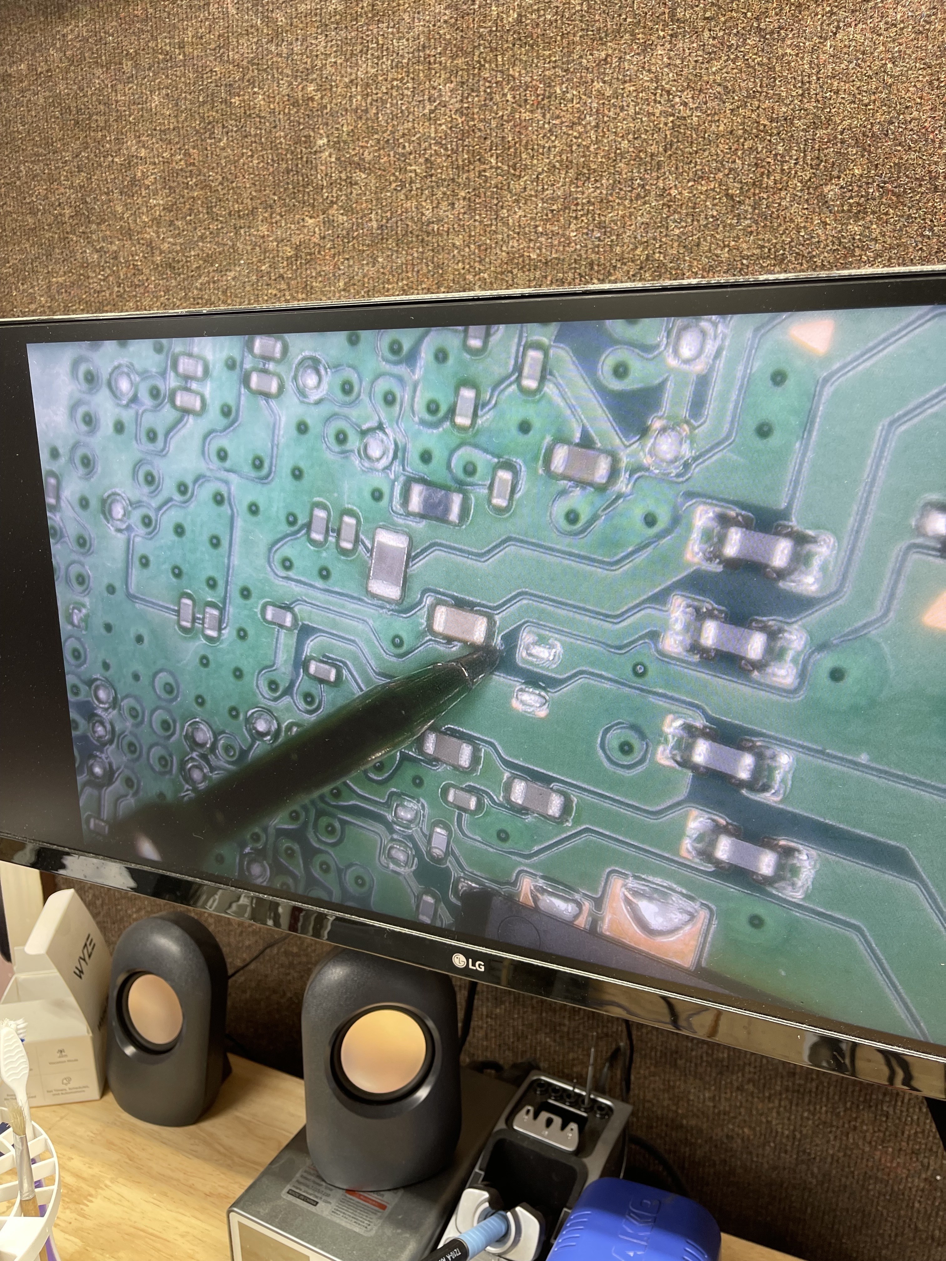

            Check for shorts underneath the southbridge.
            Also check for voltages underneath southbridge, those rails will come up when you hit the power button
            Found a short on this cap. Going to remove and see what I get.
            • ongobongo
              • May 2023
              • 63
              Desoldering the cap will change nothing.
              If you have a short underneath the southbridge it's 99,9% a faulty southbridge.
              Desolder sothbridge and check for shorts again. If short is gone, you have your fault
