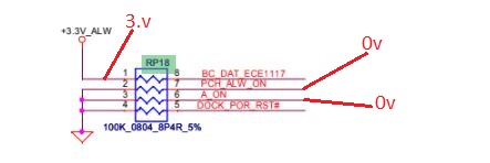

                  Re: Dell E5440 does not turn on
                  U43 and U45 aren`t being swithed on,you need PCH_ALW_ON and A_ON from RP18 .Check RP18
                  • poweron
                    • May 2019
                    • 371
                    • italy
                    #29
                    the RP18 resistance measures 100k each resistance, the voltages are as in the attachment

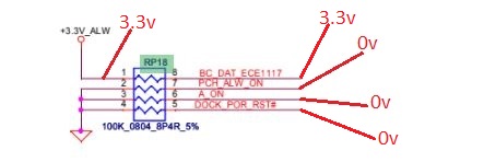

                    • poweron
                      • May 2019
                      • 371
                      • italy
                      #30
                      this is complete
                        • 21948
                        #31
                        You should have voltage for PCH_ALW_ON and A_ON from the EC U38, GPIO053/PWM0 and GPIO054/PWM1. U43 and U45 pin 3 is active high
