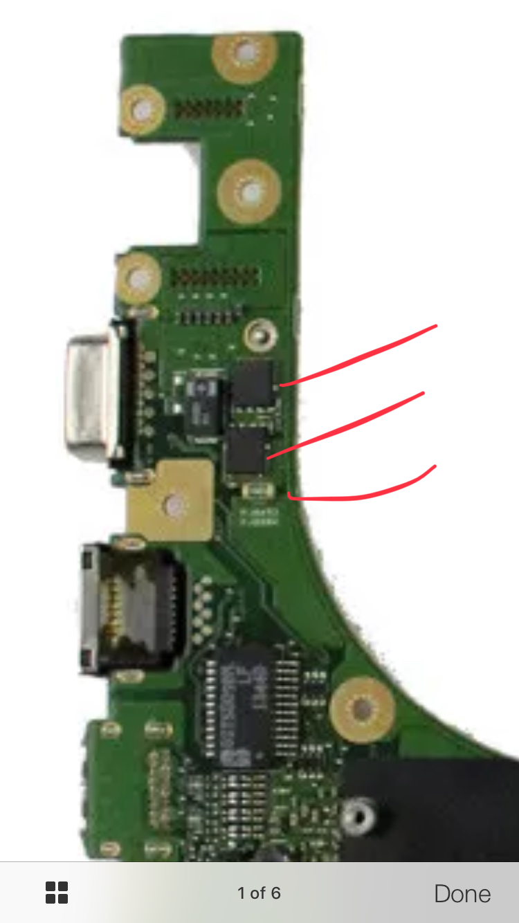

    Hello guys,
    A friend of mine tried to replace his thermal compound and i don't know exactly what he did but PR8842 (10ohm resistor on the charger line) was burned. I replaced it but still doesn't turn on charger only.
    After the resistor is the charging ic, any idea how to check if it works properly?

    that 10 ohm resistor have high amperage so u must have short after him

      Since it works on battery only i assume the problem is somewhere with the charging circuit. After the resistor comes directly the charging/power management ic.
      Any idea where should i look for short?

        Since the Mob Working on Battery first check your first 2fets and the CLR Resistor Voltage, for the Fets test all legs Voltage May be your are not getting the Gate pass for the moment don’t change any components unless your sure, request the board View in Schematic Section

          PQ8801 -
          pin 1-3 0.5v
          pin 4 - 5mV
          pin5 - 19.7V
          PQ8802 -
          pin 1-3 0.5v
          pin 4 - 5mV
          pin 5 - 220mV
          Charger only connected, no battery
          *I have boardview, i don't have the schematics though

            charging line did not comes directly to charger ic. it comes THROUGH that resistor to main 19V line. charger ic is just connected to that resistor to measure current by measuring voltage drop on him
            did u check resistance to ground on that resistor?

              Upload the boardview pin 4 must be the Gate, Voltage on the Gate is too low

                    now test voltage on PU8800 pin 4 ACDRV 20 to 25V ?
                    voltage PR8809 both sides ? PC8805 both sides ?

                      PR8809
                      Pin1 - <20mV
                      pin2 - <10mV
                      PC8805
                      Pin1 - 19.7V
                      Pin2 - <20mV
                      PU8800 pin4 - <10mV
                      I checked for short to ground on both sides of the resistor before replacing, no short.

                        PU8800 pin 4 volage must be +20V ok now test same IC pin 20 1 2 5 6 16 and pin 4 Ohms

                          PU8800
                          All resistance measured directly on the pins to gnd
                          Pin1 - 2.46k
                          Pin2 - 2.46K
                          Pin4 - 0L
                          Pin5 - 0.66M
                          Pin6 - 17.2K
                          Pin16 - 135K
                          Pin 20 - 0.484k

                            Same pins Voltage's expect pin 4
                            • alekk89
                              • Nov 2015
                              • 32
                              • United Kingdom
                              Re: Asus G750JW Rev2.1 works on battery but not charger
                              PU8800
                              Pin1 - 350mV
                              Pin2 - 350mV
                              Pin5 - 20mV
                              Pin6 - 2.6V
                              Pin16 - 11.5V
                              Pin 20 - 18.9V
                              • Techtiger
                                • Oct 2014
                                • 1602
                                • france
                                pin 1 ACN 20.3
                                pin 2 ACP 20.3
                                pin16(regn) should be 6V
                                pin 6 ACDET@2.87
                                pin 5 ACOK@0V
                                pin 4 ACDRV should be 19v+6v approx
                                second DC-in MOSFET (towards the system side) test for shorted (gate/source/drain) with the help of multimetre

                                        No short on either of the mosfets (PQ8801, PQ8802)
