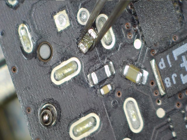

            MacBook Pro A1989 trackpad and keyboard not working
            by biosdi
            Hi guys.
            I Just replaced battery on my MacBook Pro A1989. Unfortunately doing that, I’ve broken the trackpad flex cable (821-01701-a), and I’ve already ordered a spare one. At the same moment I’ve noticed that also the keyboard it’s not working anymore and I’ve found an SMD chip unsoldered and moving freely inside the backplate. I can read L20L on the chip. Is something could explain the keyboard not working or the keyboard doesn’t work due the unconnected trackpad?
            thanks...
