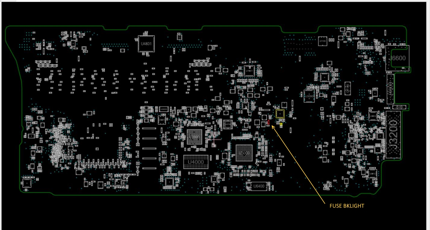

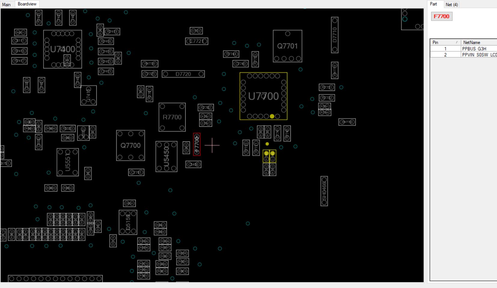

    Macbook Pro 2015 A1502 - No backlight / fuse location?
    Hi guys, backlight on macbook pro early 2015 (A1502) is not working. Mac still works can see display when shinning a torch on display or using external display.
    I've been told to test the backlight fuse but cant seem to find it anywhere on the front side of the board?
    Can anyone help with the location of the fuse or is it on the reverse side of the board (meaning i would have to take the board out?)
  • jasko_jacker
    • Oct 2014
    • 1137
    • italy
    Re: Macbook Pro 2015 A1502 - No backlight / fuse location?
    You shouldn't have to disassemble the card, the fuse is on the visible side
