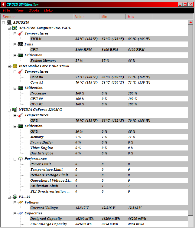

    So: my old Asus laptop which I've used for the past 10 years and I dearly love started acting up some time ago...sounds boring, but it's actually more complicated than you might think. A while back, it would randomly shut down whenever I was watching something on Youtube in Firefox - yes, it's pretty specific, which further adds to the issue..aand it did it again....and again...and again...I thought for sure it's a heat issue (which it might be), so I checked and triple checked my heatsink, paste, fan all that jazz, even went out of the way to order a second fan and heatsink, thinking perhaps the heatpipe lost some of its properties and no longer dissipates properly...never solved the issue. It delayed the crashes slightly but it would still do it nonetheless.

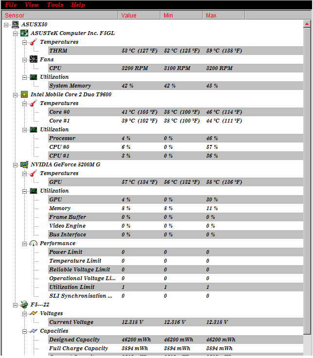

    I then began monitoring my temps more closely, so I grabbed HWMonitor and ran some Prime95...nothing too out of the ordinary to report here: around 40C on the CPU and 57C on the GPU when idle at an ambient temperature of 27C and 70C on both at full load for 5 minutes. It's worth noting that it never once crashed when I stress tested it - THAT's the main issue here: you'd think it's a heat issue, but I'm skeptical about that, as it only seems to happen with Firefox and Youtube, never under clearly heavier loads - not even a different online video platform, say Dailymotion, causes the issue...it's ALWAYS YT. To confirm, I started using Opera for the past weeks or so and it solved the problem - no crashes at all. I thought for sure it's some sort of bug and I'd have to live with Opera, which is not terrible, but it all turned to sh!t today when it crashed once again and inspired me to write about it. It was on YT too, of course >_> The log indeed returns an "ACPI Thermal Zone has been enumerated" event every time this happens (don't have one on hand right now since I cleared it), but it always reports some trip point of 90+C (converted from K) which is clearly impossible for it to reach even at full load...don't know where these numbers come from.

            Right, forgot to mention I also tried FurMark to stress-test the GPU and the same thing happened: temps went up and stabilized but never actually crashed. Also, like most laptops, it uses an in-line heatpipe design, so some heat from the CPU will invariably go back to the CPU die and vice versa.
