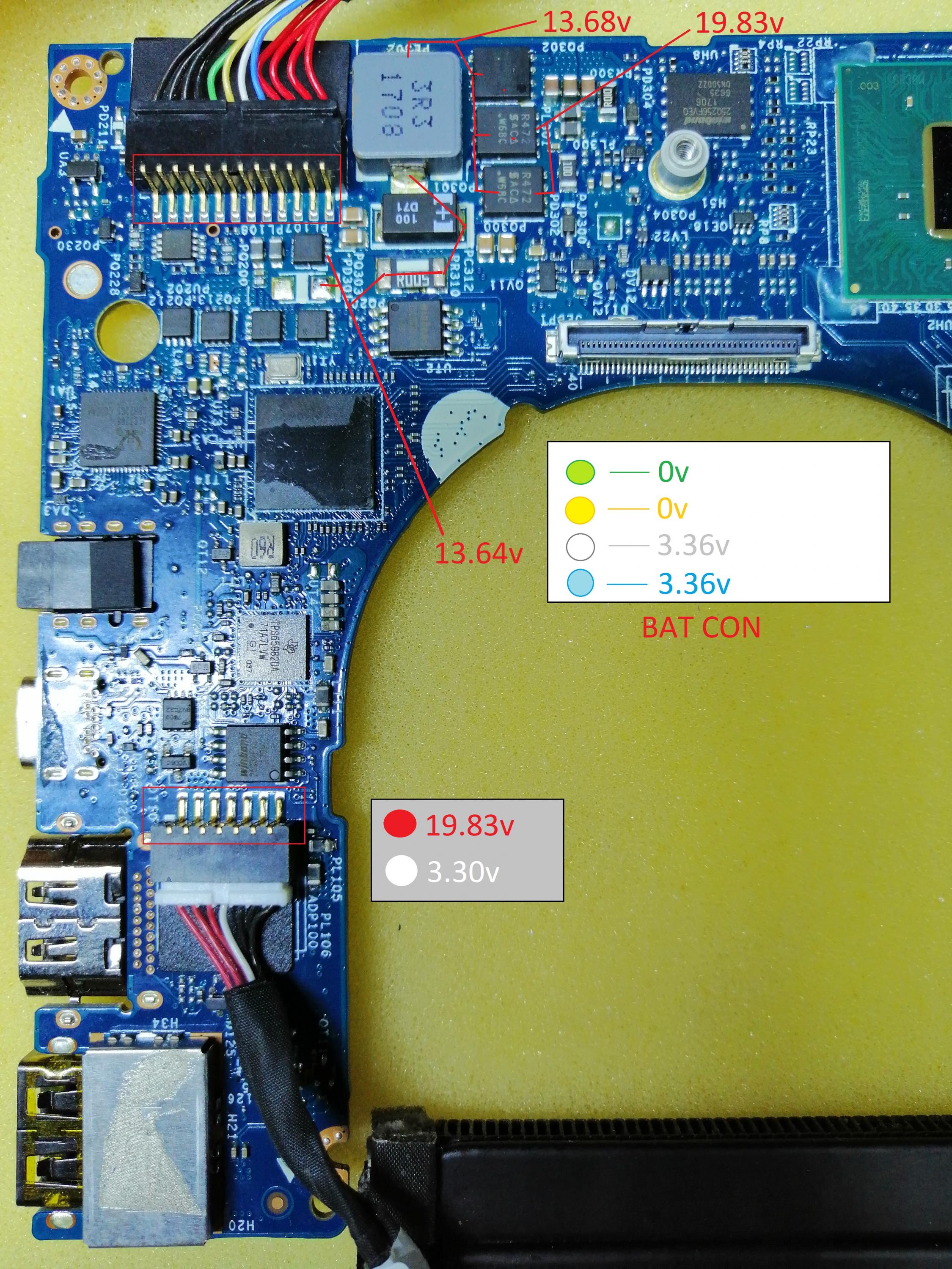

Dell XPS Battery not detected
  • medinfo
    • May 2016
    • 331
    • Morocco
    Dell XPS 15 9560
    problem batterie not detected
    any help ?

    Re: Dell XPS Battery not detected
    It will help if you mention the tests you have done so far on this laptop and battery.
      Like what ?
        Check batt discharge fet and caps connected to this line.
          no problem in the battery, i tested with two batteries
