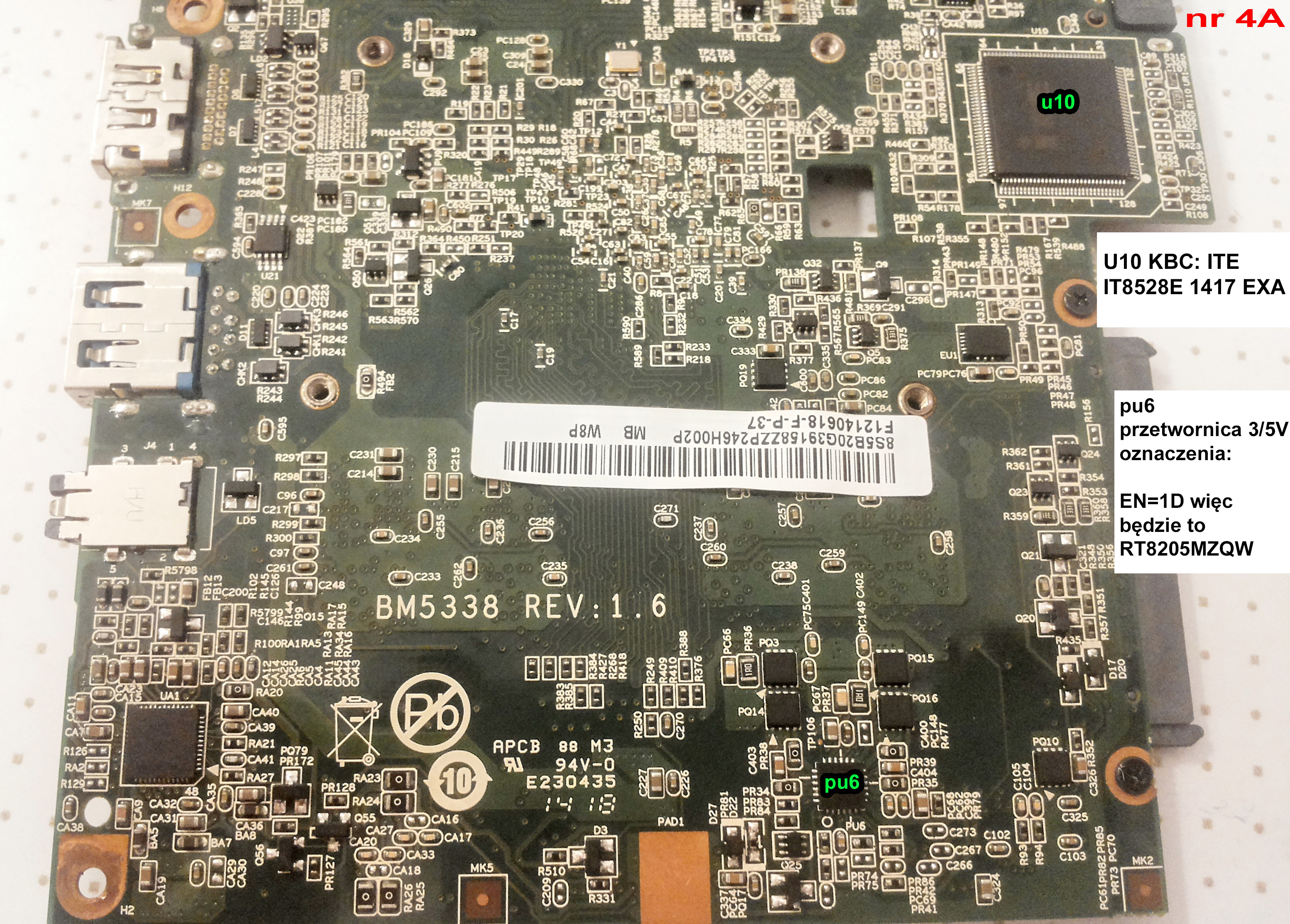

I have laptop lenovo Flex 10
Board: BM5338 rev 1.6
no power come with broken connector
change with new one press power nothing...
before i remove the connector id pin and v+ are shorted.... the laptop turn on with black screen and all voltage there 20v... 5v.... 3v... 1.8v... 1v...0.78v
when i replaced the connector the laptop wont turn on
please guide me...
i can't find schematic or bios dump for this board
