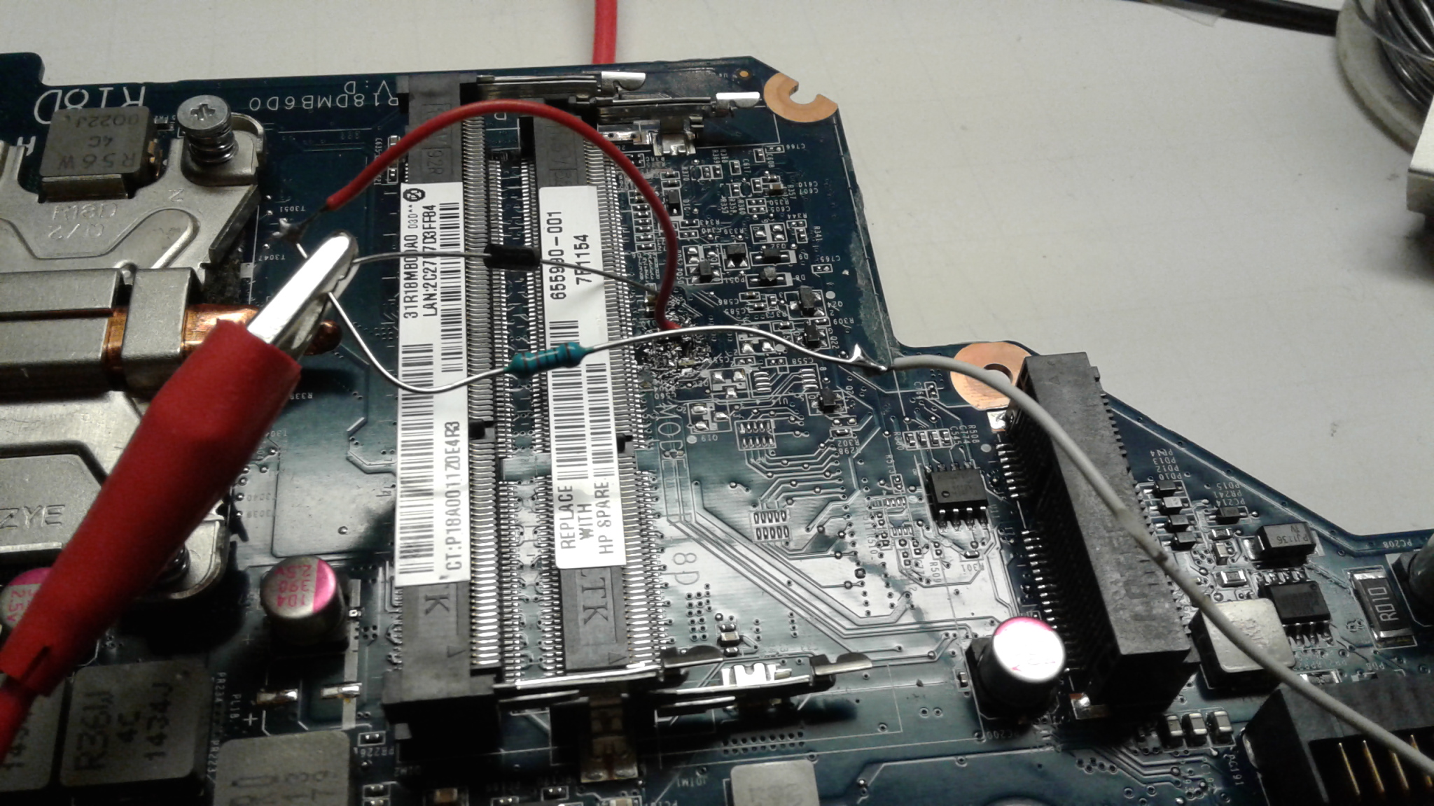

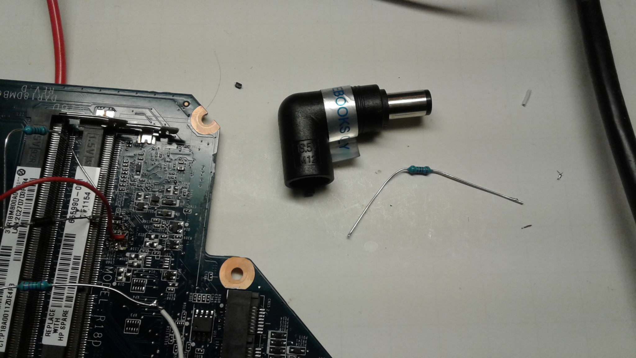

              I think I confirmed that it's the adapter's barrel. This is actually a replacement adapter with an adapter head that goes on the end of the cable from the brick. My measurements were done by removing this head and measuring the pins on the exposed end and the center pin.
              I think something must have frayed inside it. One end of the multimeter is on the center pin of the barrel and the other is on the pin of the other end which corresponds to the positive connection. When I squeeze or apply pressure to the adapter head, the resistance between the two changes a lot. I got it to go as high as 240 ish ohms and as low as around 8 ohms. Cheap adapter killed the motherboard. It seems.
              I still don't get how this over voltage protection works if we're sending it towards a critical line that I can't see any shunts on. I'm almost curious about replicating the fault yet again to see how far the voltage goes on +3VPCU and find out if it's being shunted at all.
              R304 definitely took a good part of the beating. As I said in my edit it appeared oxidized though not charred. I see a lot of stuff feeding off +3VPCU, why are we sending the over voltages there?
              Anyway, my little modified adapter ID circuit with a shunt regulator circuit using a diode is giving us 0.5V which is telling U5 (if it's still alive) that we have a 90W regulator and still no power. If it's still worth checking around what else would be your next move? I'm willing to go at it for a bit longer just for the learning experience and for curiosity's sake.
              Attached are pics of the adapter head and the shunt regulator I have going to emulate the ID voltage.

                Try not to overthink it. Go back to the basics of how resistors and diodes behave:
                - Resistors: Constant resistance. Voltage drop and current depend on the circuit.
                - Diodes: Constant-ish voltage drop. Resistance and current depend on the circuit.
                A diode can basically be thought of as a variable resistor that tries to keep its voltage drop constant by lowering its resistance. The voltage drop does increase a bit as current increases, but we can usually consider it constant when trying to analyze a circuit in a general way.
                So what do we know about this circuit? Well there is 3.3V on one side, then a diode and a resistor, and then 18V on the other side (assuming the 18V was measured with the AC adapter connected). We also know the forward voltage drop (Vf) of the diode. Therefore, we know the other side of the diode must be 3.3V+Vf. It cannot possibly be anything else as long as there is enough voltage to forward bias the diode (or reverse bias a zener). That is a fundamental characteristic of diodes. The entire rest of the voltage between Vf and 18V is therefore dropped by the resistor.
                So when you work it through like that, you see that the problem disappears. Very little current goes onto the 3.3V rail after all, and its voltage never changes. The power is dissipated by the resistor. For example, if the 100 ohm resister were dropping 13.5V, then the current flowing would be only 13.5 / 100 = 0.135A. But that would still be 0.135*13.5 = 1.8W of heat for the poor resistor. The diode has a much easier time due to the lower voltage drop across it.
                If something happened to lower the resistance of the resistor (like burning up and carbonizing), then the diode would pass so much current trying to get its voltage drop correct that it would fry itself too.
                As far as what to try next... I would increase the voltage on AD_TYPE a little bit. 0.5V should identify it as a 45W adapter. You could go as high as you want really, as long as you're not forward biasing the diode. Going to 1V should confirm it nicely.
                But the EC could certainly be bad. Or there could be an additional problem elsewhere. If the board still isn't happy with AD_TYPE sorted out (though it won't be 100% happy with no RAM installed), then check my first post for things to measure.

                                        Ah that's good news. Things make more sense with that out of the picture.
                                        I suppose a non-contact probe would be the best way of all to test the clock signal. There was actually a recent EEVblog video about how to make your own for cheap.
                                        Anyway, we seem to be left with the EC issue. If you have good AC adapter voltage and a good voltage on AD_TYPE, then it's really up to the EC to take the next step. So, replacing it seems like a good idea. It's not a sure thing, but nothing is.
                                        Corrupted firmware can cause the power-up sequence to stall there, but since there are actual fried components, I wouldn't bother messing with that.
                                        Can't think of anything else right at the moment.
