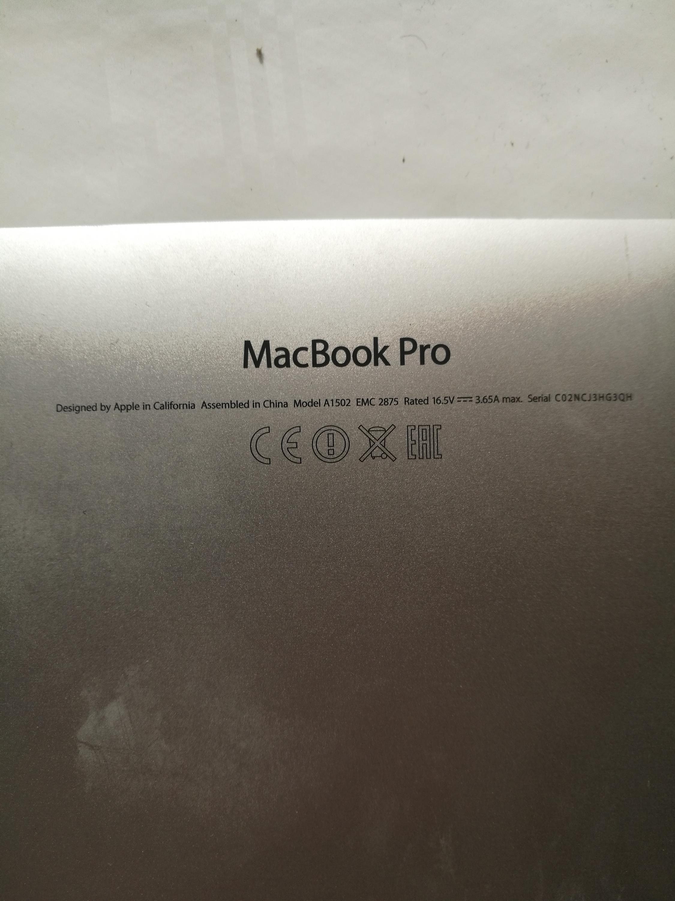

    I have MacBook Pro A1502 that was in contact with liquid on the keyboard side. I found that keyboard backlight connector is burned so i pluged it out and cleaned connector on motherboard side. Present state is next: when i turn on laptop after 1-5 minutes screen freezes, but the strange part is that if i plug in second monitor on HDMI port, both monitor and laptop screen work and nothing is freezing. Can you please help me?
    I am thinking that there are two circuit or two ic. When i plug in second screen second line (that was not affected by burned keyboard backlight) takes over and all is fine.

    Whats the board model? 820-xxxx? Is GMUX area affected?

      A1502 is 13" so iGPU only, no GMUX. Logic board can be 820-3476 (2013 8GB), 820-3536 (2013 4GB), 820-4924 (2015).

          If this helps...
