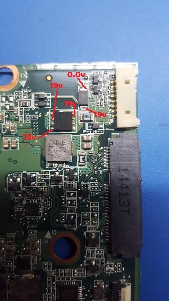

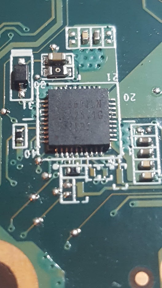

    Hi got this hp laptop in for repair on inspection when u plug in the charger the white light next to charger port lights up thats it on inspection of the mother board i have no voltages on any power supplies i only have power at the first mosfet and i think its a diode next to it on one side i have attached a pic with the voltages .Any idea where to go next with this motherboard .
    Thanks Guys

    check the voltage PU6 pin 1 3 20 19 23 24
    Voltage PU5 pin 6

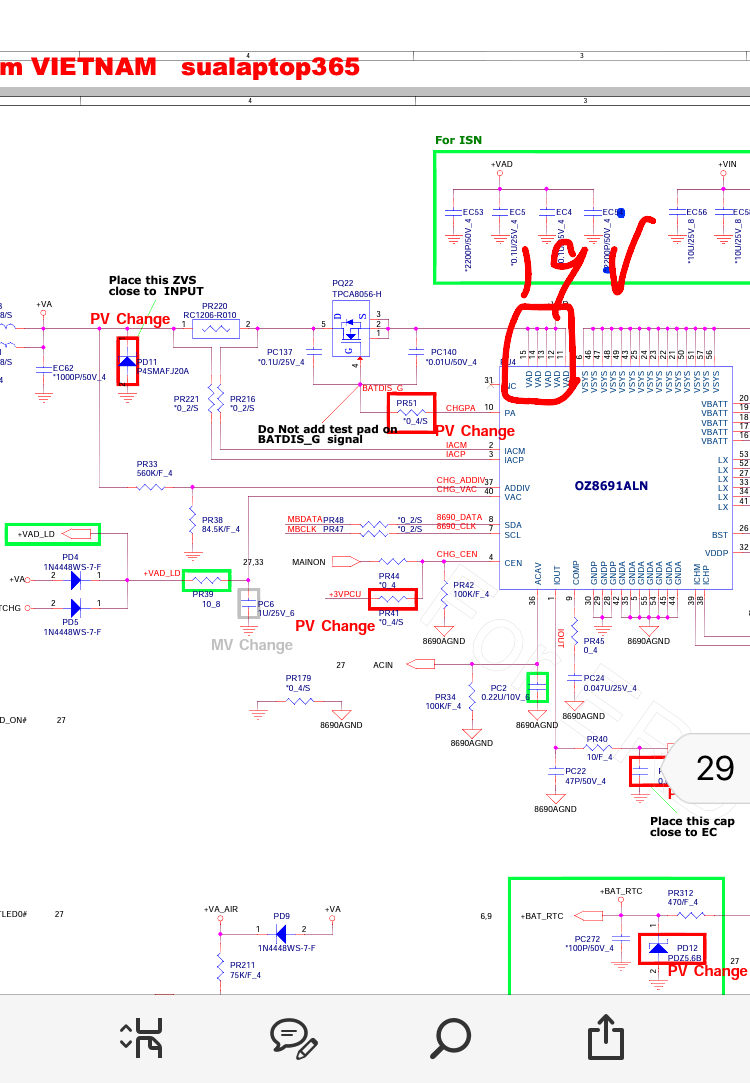

      Thanks, techtiger but I'm kinda lost according to the schematic pu6 should be ISL6251A but on the board its a OZ8691LN and I can't find anything on it will I still take the measurements from the same pins. Thanks

        I believe your motherboard wasn't Quanta AX3/AX5, since no PCB marking or labeling for component on whole board. So definetely newer Quanta's motherboard, try search Code of mobo near RAM socket.

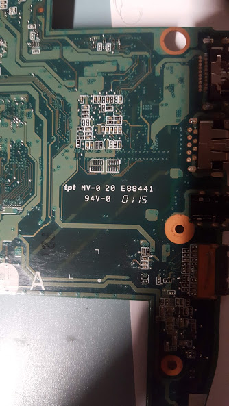

          Cheers on/off i think i have found it TPT MV-0 20 E88441 this more like it
          Your never to old to learn
            • 21936
            Re: hp Stream ( No 19v on power supplies )
            No thats not it .

                Hi guys Downloaded the boardview but i can't find pu6 on this boardview and also the boardview is different from the motherboard layout. Thanks

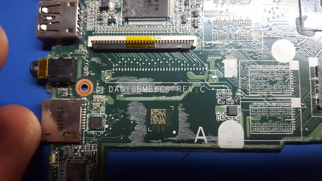

                  Try to find the board id it will be similar to DA0Y0AMBC60
                  HP Stream 11-d: - Quanta Y0A
                  HP Stream 13-c: - Quanta Y0B
                  HP Stream 14-z: - Quanta Y08
                    Found it

                      Sadly, seem the bv doesn't match. Use schematic just as reference.
                      Charging chips should be PU4 OZ8691ALN page30

                              Cheers guys downloaded the files will i still check the same pins on OZ8691LN charging ic

                                Right guys i can't find the datasheet for oz8691ln i was using the schematic but its a oz8691aln on it and it has 10 pins on the left side but on the schematic it has 9 so i don't know where pin 3 is but for the rest
                                pin 1 iout =19.73
                                pin 3 ?
                                pin 19/20 on same pad vbat = 0.352
                                pin 24/25 vsys on same pad = vsys = 19.72

                                  Also on vcc pin 9 on RT8172A CPU/GPU Core Power Supply i have no power but i do get charging light on power adapter connector

                                    Pin 11 to 15 is your 19V in pins for the Chip, test pin 10 2 3 37 40 36

                                      OK here are the voltages for those pins on oz8691ln
                                      10- pa = 5.804v
                                      2- acm = 0.380v
                                      3 - acp = 0.00v
                                      37 - addiv = 3.320v
                                      40 - vac = 2.583v
                                      36 - acav = 0.001v
                                      Thanks for the help much appreciated

                                        Anyone ? are these voltages ok or can someone tell me what the abbreviations stand for ie (acp ) and i'll try and find out...Thanks
