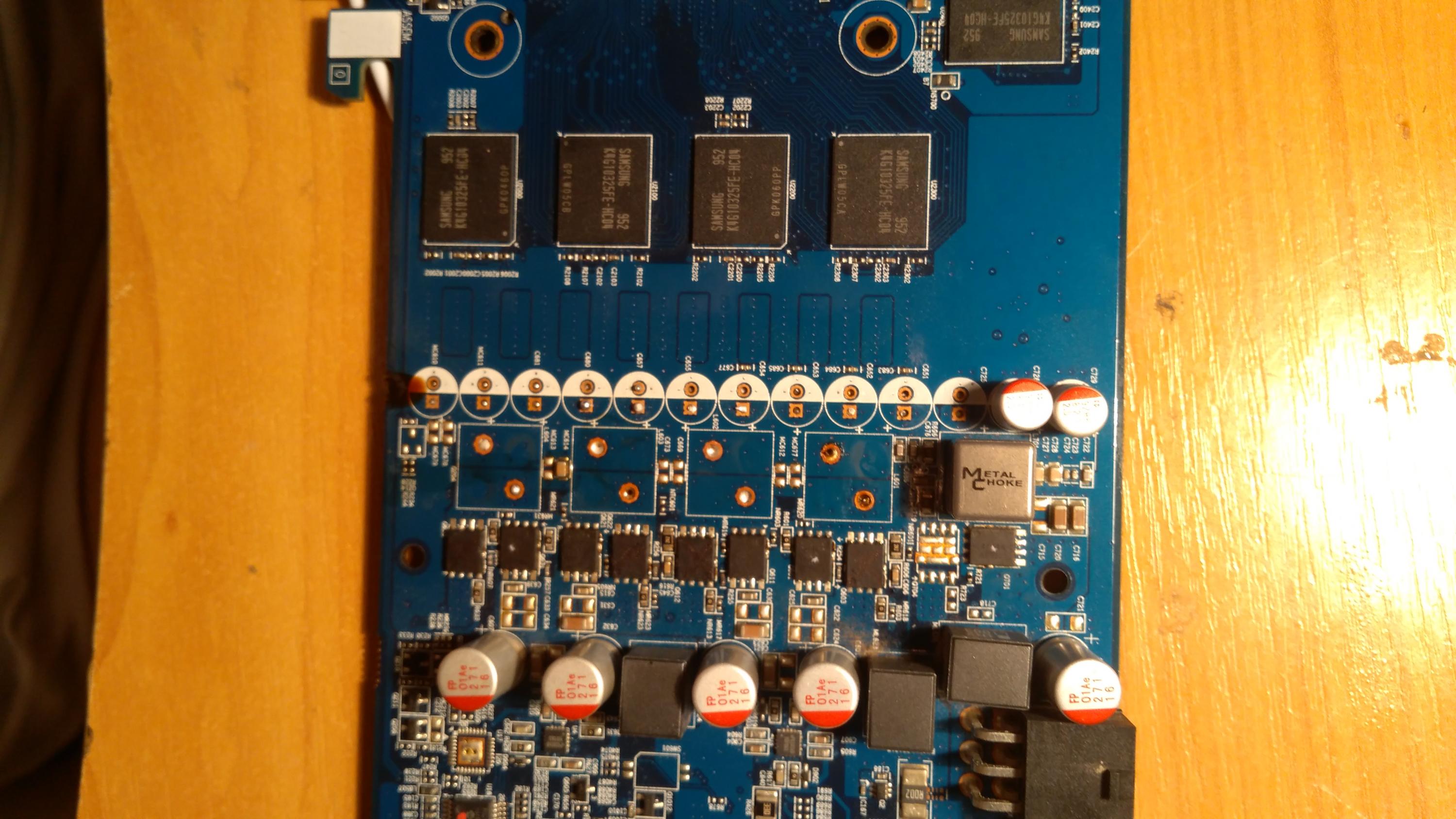

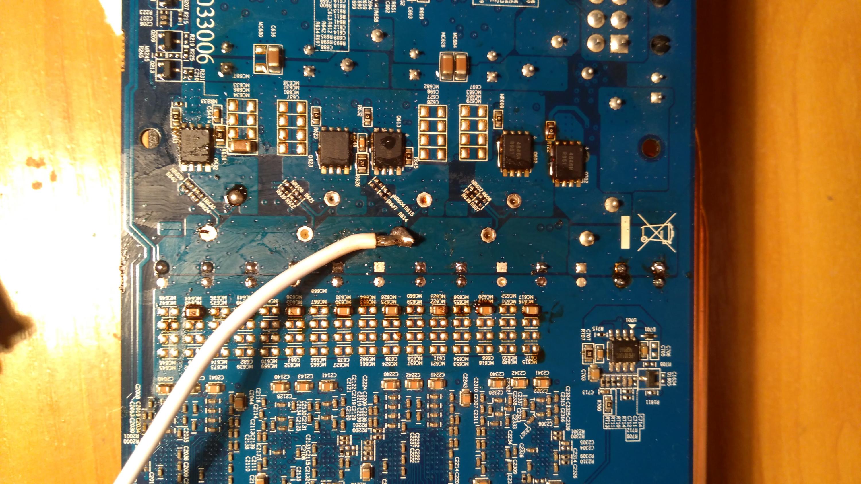

    Hello.
    Have this Gigabyte GV-R587UD-1GD graphic card that not work and give a bad smell when in PC. i remove all main coils and have 0.3ohm on GPU side. no short on mosfets side. But when i inject 1V 5A to that 1.1ohm side the only thing that heats is GPU
    Do u thing that GPU is burned?
    Does anybody know what max voltage i can inject to this side?

      short is on GPU phase but now i dont have PSU that gives more than 5A so i can give max 5W
      removed coils and caps to locate short

          i think i removed 4coils on GPU phase. where do u think is a memory phase?

              What resistence you have on coil pads?
              Memory phase its on the other side of gpu.
              Less coils. Not the one behind.
              Holding the video card in front of you with pcie connector down on the left side of bag the coils are for memory(90%)
              Right side gpu phase.
              Check the ohms on all.

                no short on that side. even on right side is one coil with two caps that is not on short/on picture still not removed/
                on gpu phase with removed coils and caps/on picture/ is resistance 1,3ohm
                right on GPU IC is no small caps on short, but found that 1,3ohm short on small caps on the other side of board under the GPU IC

                      i was wrong about power of this card. it is even weaker that card i bought for 25euros
                      i dont care about it and remove GPU ic and short is gone
                      so i think the GPU was burn because all caps on it was without short
