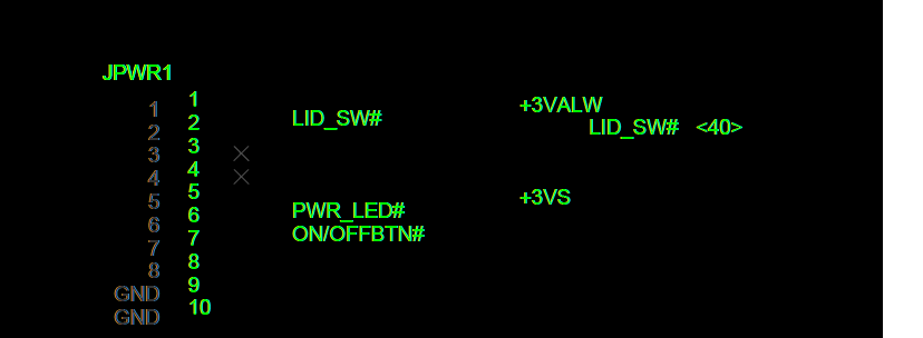

    I have acer laptop motherboard
    Model Name :Q5WV1/Q5WS1 LA-7912P.
    I want to turn on the laptop without power button
    U find 3v in pin number 1 and i want what is short pins make laptop on
    Re: Acer aspire power on!!!
    Usually 3.3V to Grd to turn on. I don't have the schematic for your device, so can't say exact pin#. There might also be a couple of exposed pads/jumper near the power button connector on the motherboard that you can jumper
      Pin#7 is pwrbtn and pin8 is gnd. So shorting between these two pins should turn the mb on if everything else is ok.

        i try to short pin 1 with 2 some times turn on and some times no

          • When use search, easy to find schematic on badcaps.net forum.
            https://www.badcaps.net/forum/showpo...34&postcount=1
            Want to repair SMD devices without schematic, till you know pin out kbc in your head (expert), then try check contiunity which pin goes to power conn.
          • pin 1 3valw
          • pin 7 on/offbtn#
          • pin 8 gnd

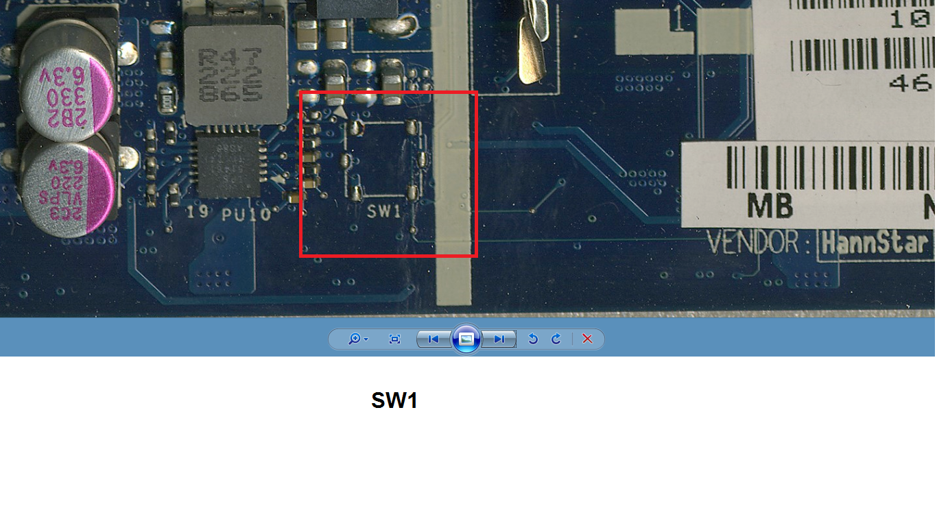

            So you want to make shorted +3valw power rail with LID, lucky you no hurt to mobo. follow suggestion post#3
          • Usually I made an on/off power button from scrap board (touchpad click L/R---or ex power button) and connect to SW1 for help when I'm trouble shoot motherboard. Twizzer NO
            [/QUOTE]Maybe your problem on LID IC, check that IC on your power button's board.
            IC package SOT-23-3
              thx for helping problem resolved
              thx badcaps legend <3
