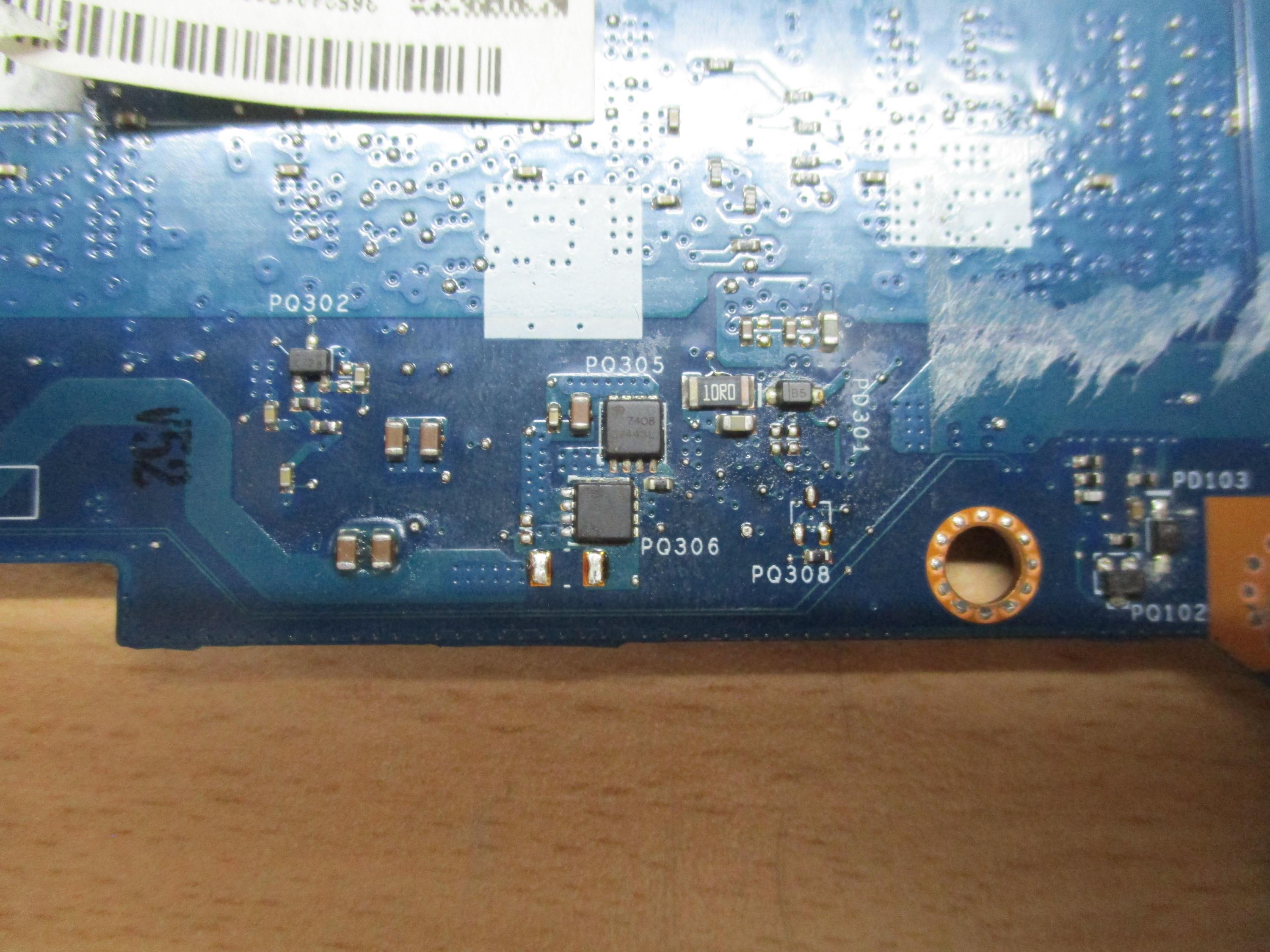

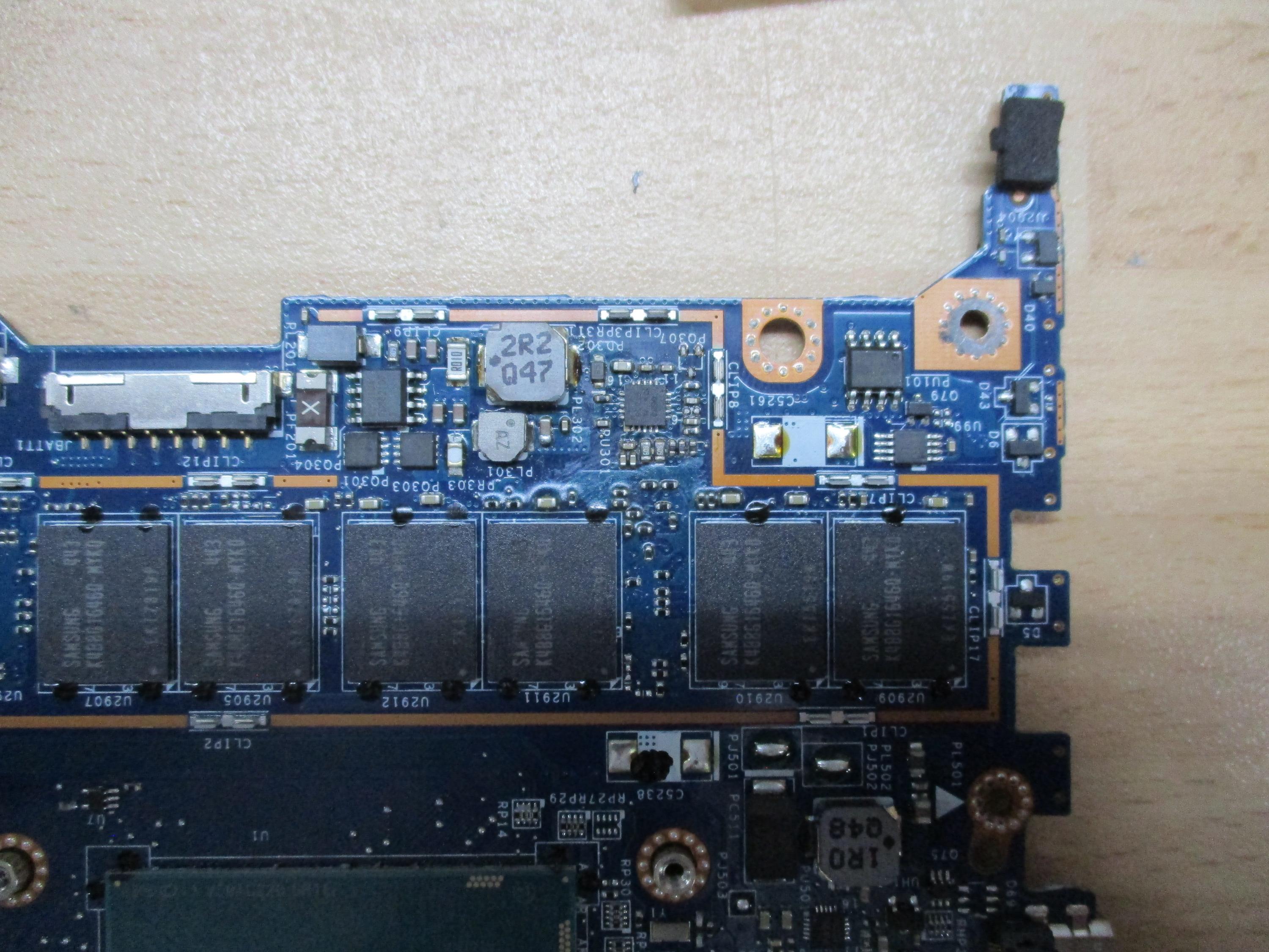

                          Re: lenovo yoga 2 13 Check this Out?
                          got the same notebook, same problem.
                          Faulty parts replaced so far:
                          - this blown cap (replaced by 10µf 25V)
                          - PU301 BQ24715
                          - PQ306 AON7508
                          All of them were clearly faulty. Now, notebook runs on battery but does not charge. If I disconnect the battery and try to power on with charger only, power light comes on for around 1sec but goes off again. So clearly the 20V power rail is present also on charger only. MOSFETs all fine, also resistors around PU301 have right value. Any more suggestions?
                          Thanks!
