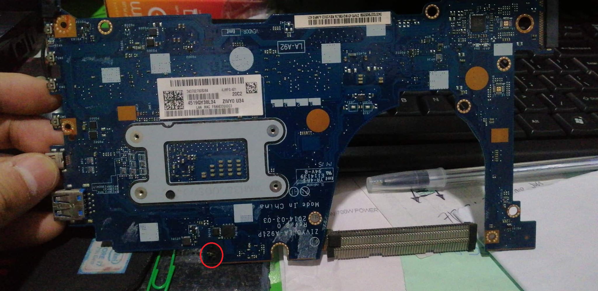

    Hello to all.
    Unit Model: Lenovo Yoga2 13
    Mobo P/N: ZIVYO LA-A921P REV:2.0 2014-03-03
    Status: No Power w/ Voltage on Adapter Drop
    Action: First i dismantle the Laptop and Check the Mobo (Mother Board). Then i saw one capacitor Burn.
    Here is the Picture
    you see the red circle?
    identified it is a Capacitor,burn but I do not know its location part number...
    Action : 2nd I Remove this Capacitor then i checking and test using ohmmeter for resistance. Positive 0 Ohm (Shorted). Badcaps...
    Action: I check the area where the capacitor is connected. may there be any broken parts?i check for short using Ohmmeter. i plug the adapter
    result now the adapter is giving the correct voltage. but "No Power"

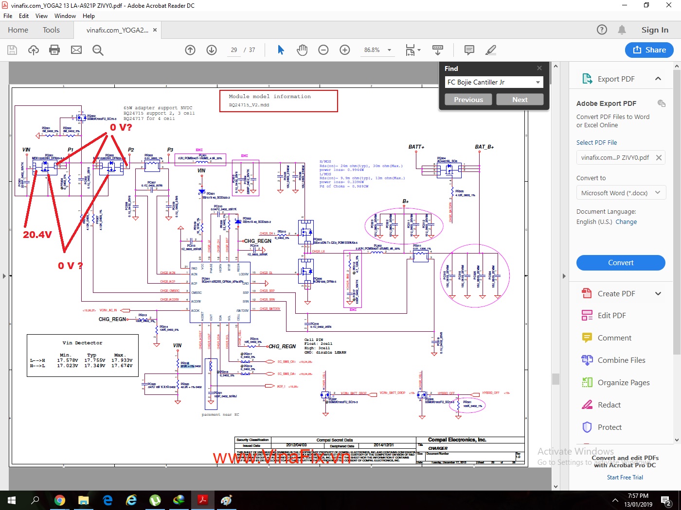

    Now I Used the Science Discovery hehehe (Tuklas Agham in Filipino language) hehehe
    Read the Schematic Diagram.
    I tracing the rails of 20V Start On DC in to Fuse PF101 to PL101 Have 20.4V then to PQ301 Drain= have 20.4 using Digi tester but Source and Gate 0V
    S= 0V?
    G= 0V?
    D = 20.4
    Here is the Picture
    Even The PQ303 Source, Gate and Drain. there no Voltage "0V"
    I need your Advice For that
    Other i Check the PQ301 and PQ303. i test - remove to PCB Negative for Shorted. both Mosfet are Good.
    also i change Both Mosfet No Luck .Still Same as Problem
    Again I need for Advice... Thanks

    What are the Voltage PU301 1.4.5.6.20?
    Upload the Schematic

      ACFET & RBFET (PQ301 and PQ303) can be turned on the System by ACDRV pin 4 it should be higher than Drain

        Also should be checked PU301 pin 16 LDO REGN since acok signal tied with it.
        Maybe if that can flow with super slow motion VCC (pin 20)>>>ACDET (pin6)>>>REGN (pin16)>>>ACOK (pin5)>>>ACDRV (pin4)
        Make sure B+ not shorted.
        Originally posted by lorins_core
        Here is the Picture
        The shape seem 10uF/25V caps.

          But I curious About This Part Of PQ301 and PQ303.
          In Actual Parts installed it is AON7430_PQ301 Same on PQ303.
          On Schema Diagram is ISMDV1526URH_PQ301 same on PQ303.
          anyway i think it is Same?
          Also I update. i check and trace the the PQ304_AO4407A has been open the Source to Drain?
          Action: Replace them same 4407A.

            the 1st 2Mosfets are N-Channel if any short change them check Ohm with out power
            What are the Voltage PU301 1.2.3.4.5.6.12.16.20?

                    Voltage is not correct
                    Pin 1 = 0V +19V
                    Pin 2 = 0V +19V
                    Pin 3 = 0V +19V
                    Pin 4 = 0V +24V or more
                    Pin 5 = 0V +3.3V
                    Pin 6 = 2.7V
                    Pin 16 = 0V +5V or 6V
                    Pin 20 = 20.2V
                    if you have no short in 1st 2 Fets then reflow the IC & see or change the BQ24715
