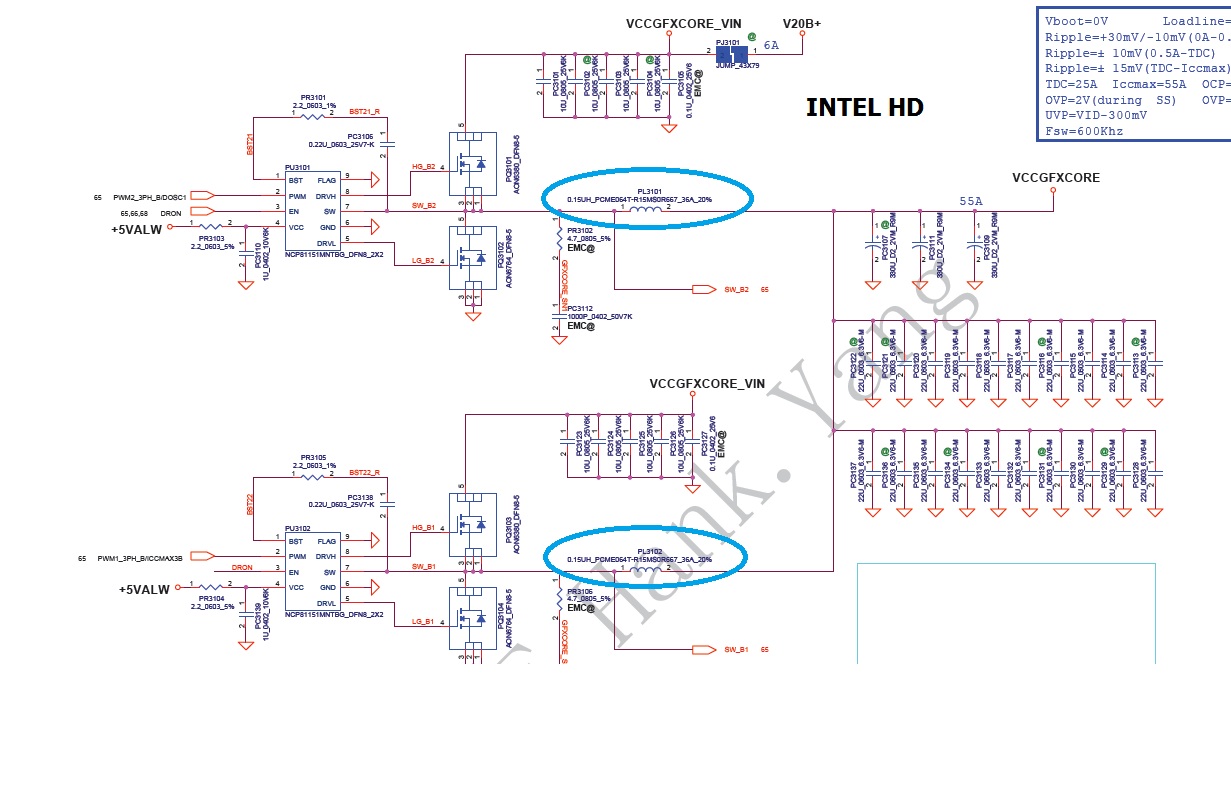

    Hi, i have legion y520 nm-b191 motherboard with no display, blank.
    Fan is keep spinning but no display.
    Voltage 3.3v and 5v regulator present. Led power light white when power button pressed.
    Found the IC card reader controller UW1 very hot, remove the ic but still the same.
    No voltage on PL3101 and PL3102 cpu vccgfxcore.
    Cpu core has voltage.
    Vccsa has voltage.
    Any suggestion?

        If you have extracted main+ec from lenovo update-then perhaps not a bios issue. Check ram slots and ram stick as if ram is not reset-no gfxcore.
        Btw, i have not seen the schematics but gfxcore coil should be 1 only. So you are likely having missing gfxcore plus something else also.

            Ram slots checked and voltage rail ddr4 checked fine.
            It's indeed 2 gfxcoil because there are 2 pwm controller in a parallel stage....and resulting 1 vccgfxcore.....and then feed to the intel hd inside cpu.
            The nvidia gfxcore is just fine. I found the nvvdd and nvvdds outputing voltage correctly.

                pl3101- pl3102 not voltage , what could be the problem, I can't see nvidia

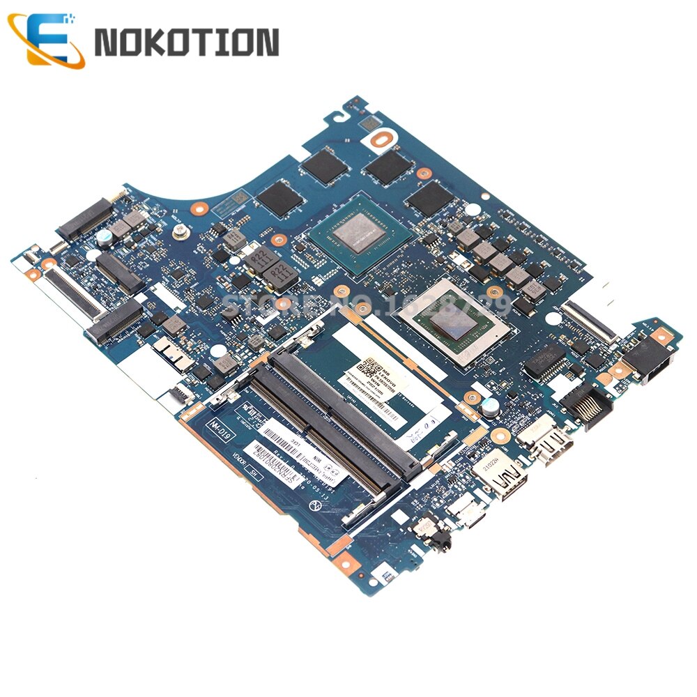

                              Originally posted by rares01
                              this version of main doesnt have the separate chipset near ram slot. only gpu and cpu
                              are you talking about Y520 nm-b191 ? post picture please...
                              • rares01
                                • 19
                                • romania
                                Re: Lenovo Legion Y520 nm-b191 NO DISPLAY BLANK Help ?
                                • myth77
                                  • Feb 2017
                                  • 380
                                  • Croatia
                                  that is not the same board although markings are similar. your laptop is Lenovo Legion 5-15ARH05 and this on the subject is older y520.
