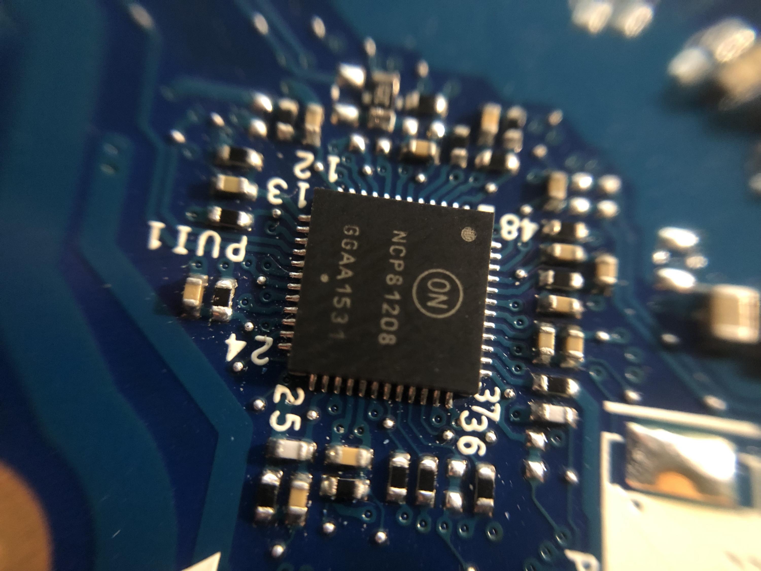

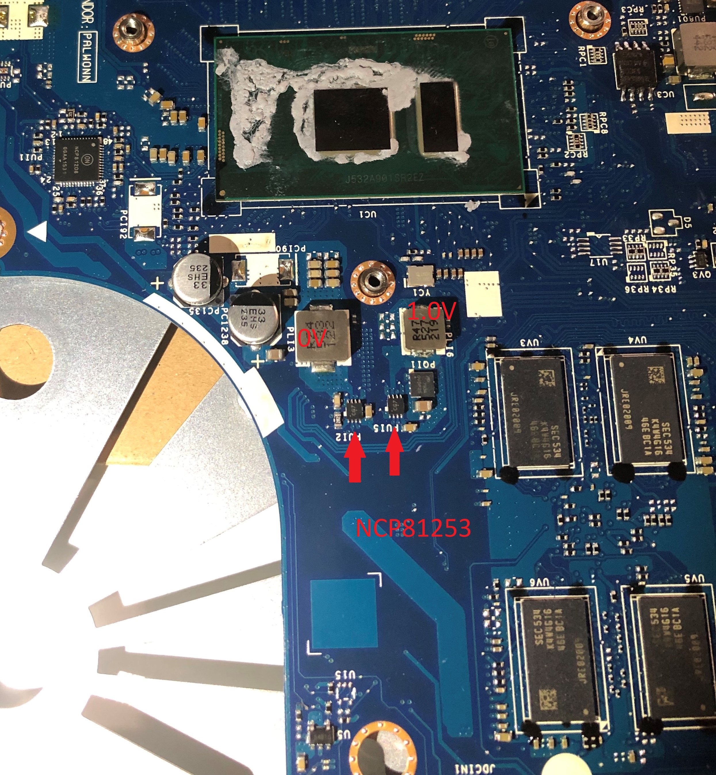

    i measured all voltage, only cpu dont work

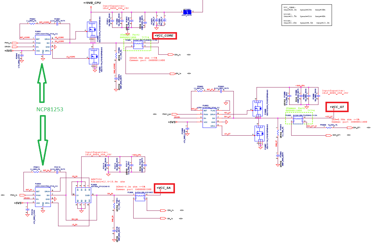

    there is NCP81208 chip for three rail voltage :
    VCC_core VCC_GT and VCC_sa
    only one of three voltage working .ist 1volt
    two voltage ist null . i replaced 81208 chip ,but dont change. also i chnaged two NCP81253 together, one have voltage another ist null. also dont change
    So i think 81208 and 81253 not defect and problem ist another place.
    i can see three pin Communication (SOC_SVID_CLK ,SOC_SVID_DAT,SOC_SVID_ALERT) that connected direct to cpu .
    any person have idea for my problem ?
    How one of three voltage rail working , because all enable pin ist same but with seperate PWM ?
    i dont found datasheet for 81208 but i thinks ist similar NCP81243

    Chek all your pgood pins

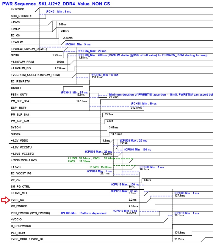

      i checked
      i am sure that +VCC_SA(one of three Rail voltage for NCP81208) ist ok ,plus VR_PWRGD
      Also i think +VCCIO is good.
      Have an idea?

                  VCC_GT here refers to GFX Core ?? If so , it can be missing coz of many reasons like Bad bios, Bad ram stick or slot, PCH, Vcore ic(i rule it out as you have already replaced it) and missing DRAMRST# signal.
                  I'll suggest to check DRAMRST# signal on pin30 of Ram Slot. It should be 1.3V approx.
