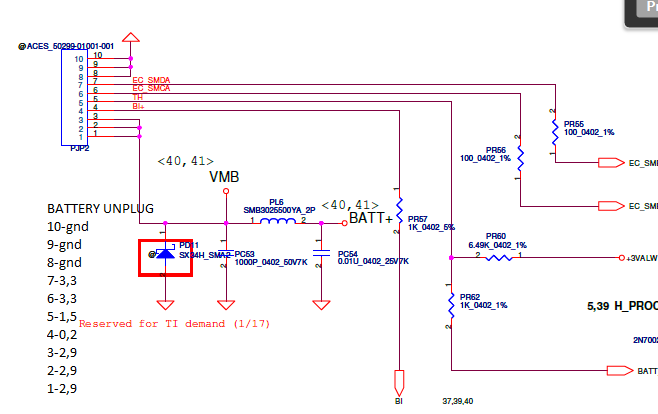

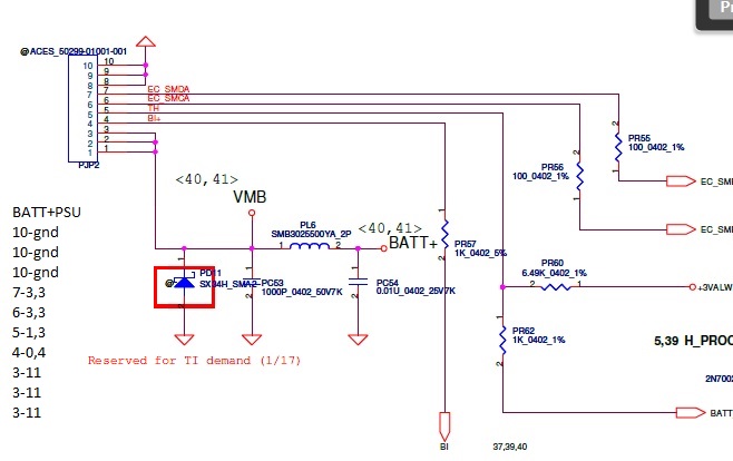

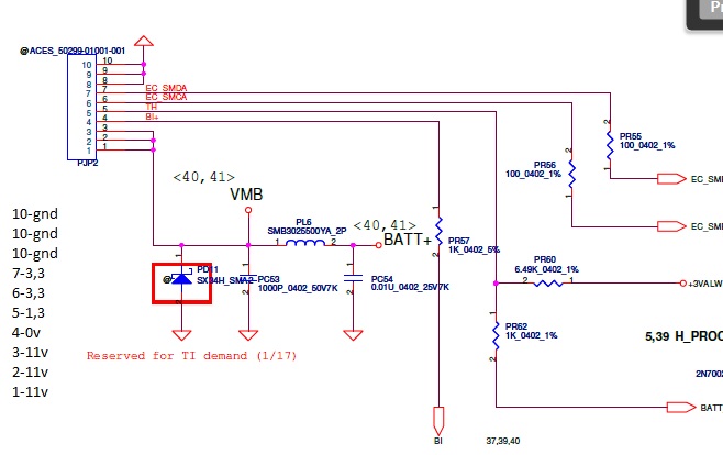

    Hi to all,
    I have a problem with a ACER TIMELINEX 5830TG with MB LA-722.
    He wont power up and no led are present.
    I have found that the battery was 0v and probably put the MB in protection.
    MB won't turn on also without the battery unplugged and fan don't spin.
    I already change the battery and discharged capacitors hold on the power button for 30sec.
    The alw power rail are present and power button work (3,3v to 0v when pressed).
    The problem appeared after that I repair the hinges of lcd: I disconnect and reconnect lvd cable with battery plugged; I don't know if the problem is connected to this.
    In attachment a photo of pjp2 with the tension and schematics.
    Hope that anyone can help me.
    Thanks in advance

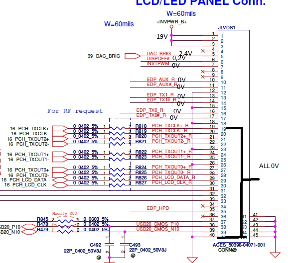

    The measurements seems ok. Charging light glows?? Look for damage near lvds connector or kbc gone bad probably.

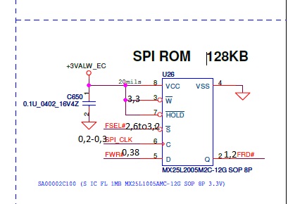

      thank you for reply.
      -no charging light
      -no visible damage on lvds conn
      in attachment voltage of LVDS conn without display connected, and SPI rom (maybe is useful for understand if kbc is good)

          Re: ACER TIMELINEX 5830TG no led no power alw present
          KBC is already powered +3VALW_EC is present. I don't know where are the enabling signal of KBC and at what state of power sequence it will be present.
          With the voltage on SPI rom FSEL# SPI_CLK FWR# FRD# seems that is at list partially enabled (but I really don't know if this voltage are correct or if these are input output or bidirectional).
          Because of power current are ok and i don't found short don't think that desolder it can help me.

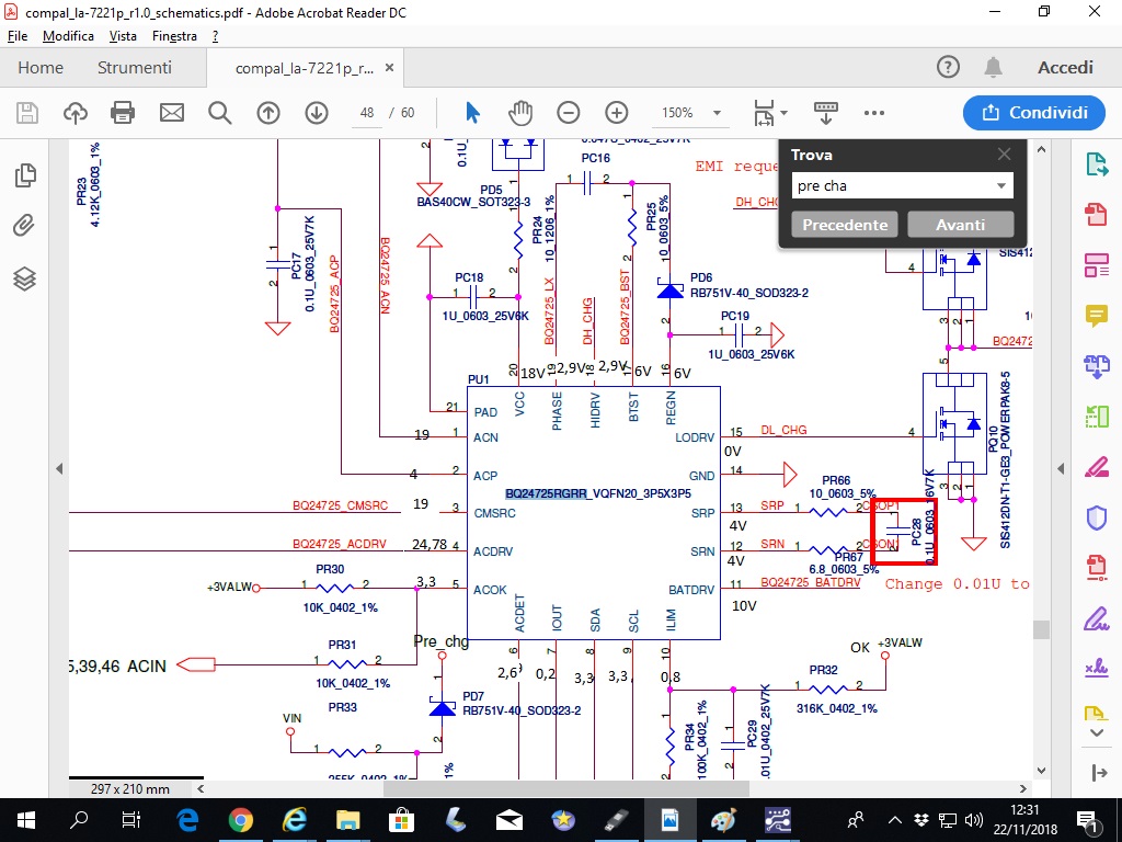

                Hi and thank you for your patience.

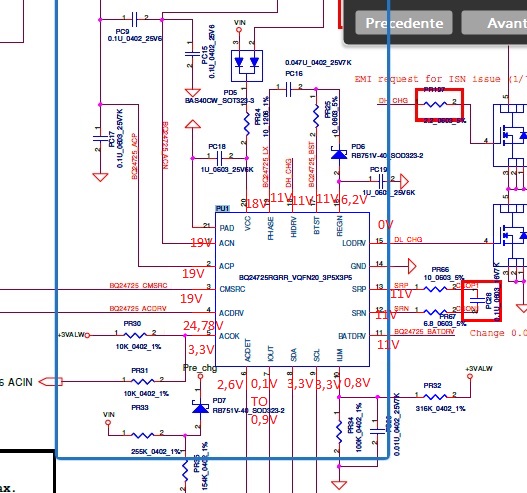

                In attachment the voltage on pu1 with only adapter connected, only battery and both. In all case DL_CHG on pin 15 that open pq10 mosfet is off.

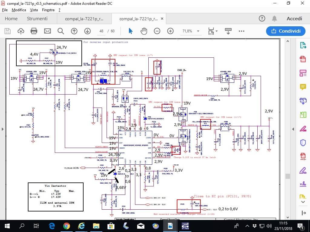

                  With psu only, ACP you have mentioned 4v. Should be 19V. Lets check from the beginning. Voltage on PQ6/PQ7/PQ9/PQ10 fet-all pins??
                  • aniki4177
                    • Nov 2018
                    • 14
                    • italy
                    Ok I noticed that sometimes the 19V goes to 4V and I must disconnect and reconnect charger for correct voltage.
                    In attachment the power charge circuit with the correct voltage.

                      • dellxps15
                        • Feb 2014
                        • 1598
                        • italy
                        i cant read the values, but looks like something is wrong with b+ side. 2.9 v should be 19 volt.
                        could be bad pq9, short in b+ side,
                        also i see 25v... are u using proper psu ? how can 19volts become 25 volts ?
                        ao4466 mosfets are n channel . that means that to open gate volt need to be 5-8 volt to open 19 volt line.
                        maybe also a defective BQ24725RGRR
                            Hi to all,
                            according to SMDFlea post ACDRV and BATDRV works good.
                            -powered with Battery only BATDRV 17V BATT+ 11V
                            -powered with adapter+battery BATDRV became 11V() BATT+ 11V
                            I don't understend if or when DL_CHG (pin 15) go up. BATT+ must be always 19V?PQ8 must be close when powered by adapter?
                            How can I test PU8 in circuit? (it seems always closed).
                            The 3rd photo on post #8 (PU1_PSU_Only) have wrong value, please refer for this case at post #10; the other 2 are correct.
                            For read value enlarge the preview and save on PC, the resolution is good.

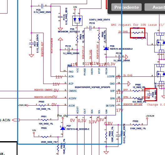

                                Maybe I don't understand what do you need;
                                I have already posted pin to pin readings of the fets on post #10 photo:
                                PQ6 1-3 19V
                                4 24,7V
                                6-8 19V
                                PQ7 1-3 19V
                                4 24,7V
                                6-8 19V
                                PQ9 1-3 2,9V
                                4 2,9V
                                5 19V
                                PQ10 1-3 GND
                                4 0V
                                5 2,9V
                                Only for clarity For B+ side you intend BATT+ line?
                                Do you know how to work DL_CHG on pin 15 with pq10 mosfet?
                                  Yes B+ is also known as BATT+
                                  Have you checked PQ8 as its gate is BATDRV on pin11 of bq24725 and here i see 2.9V which is wrong?? Check PC14 and PR21. You can also try removing PR28 and then putting ac power. Observe voltage on PQ8/9 & PQ10 after removing PR28.
                                    • 21968
                                    "Do you know how to work DL_CHG on pin 15 with pq10 mosfet?" LODRV works by PWM .
                                    Do the tests as @mcplslg123 said, also check PR66,PR67 and PC28 .
