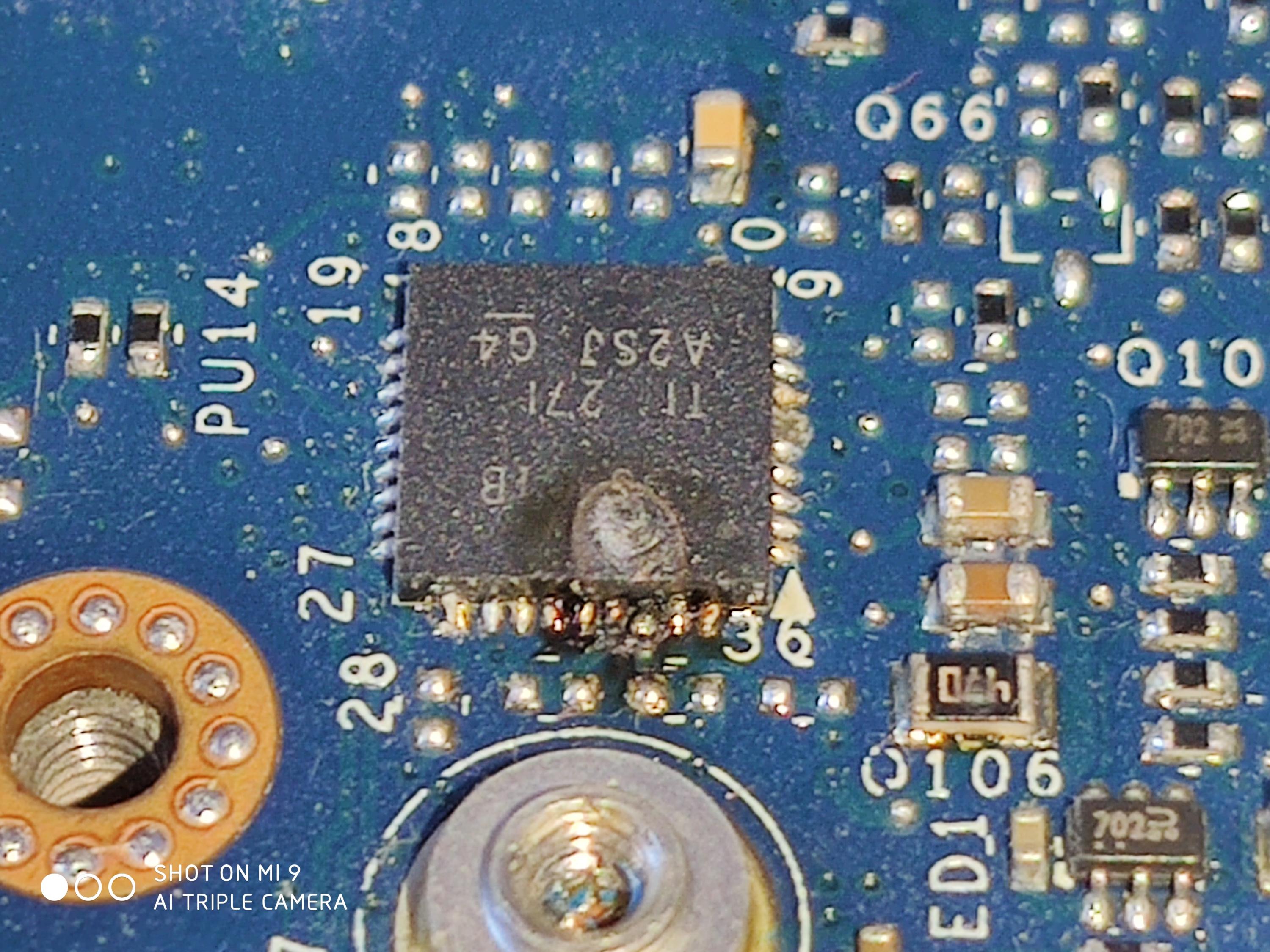

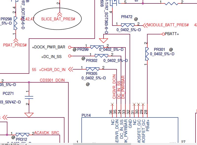

    Hi All
    I have a laptop what does not charge anymore, it won't go on without battery.
    But even with a "dead" battery it will go on and works fine, aslong there is a battery in. In the dell bios it show no adapter installed, also with a universal adapter same, but does boot, but does not charge and won't go on without battery.
    Now I have read: https://www.badcaps.net/forum/showthread.php?t=44259

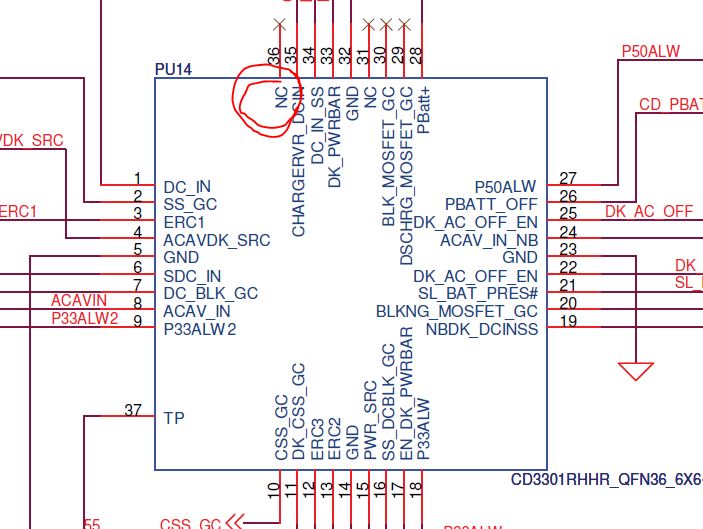

    and it points to PU14 / CD3301 CD3301RHHR_QFN36_6X6 and indeed that chip has some burn marks on pin 34.
    According to the schema it should be DC_IN_SS, I could try to replace the whole chip but:
    is it also possible to bypass or make a wire to pin 19 (+NBDOCK_DC_IN_SS) ?
    so the laptop thinks it is docked (but is powered by adapter plug) and will charge ?
    thanks in advance.

    Re: Dell Latitude e6320 charge circuit broken, bypass ?
    CD3301-This should match, rest is irrevalent as they are date codes etc.

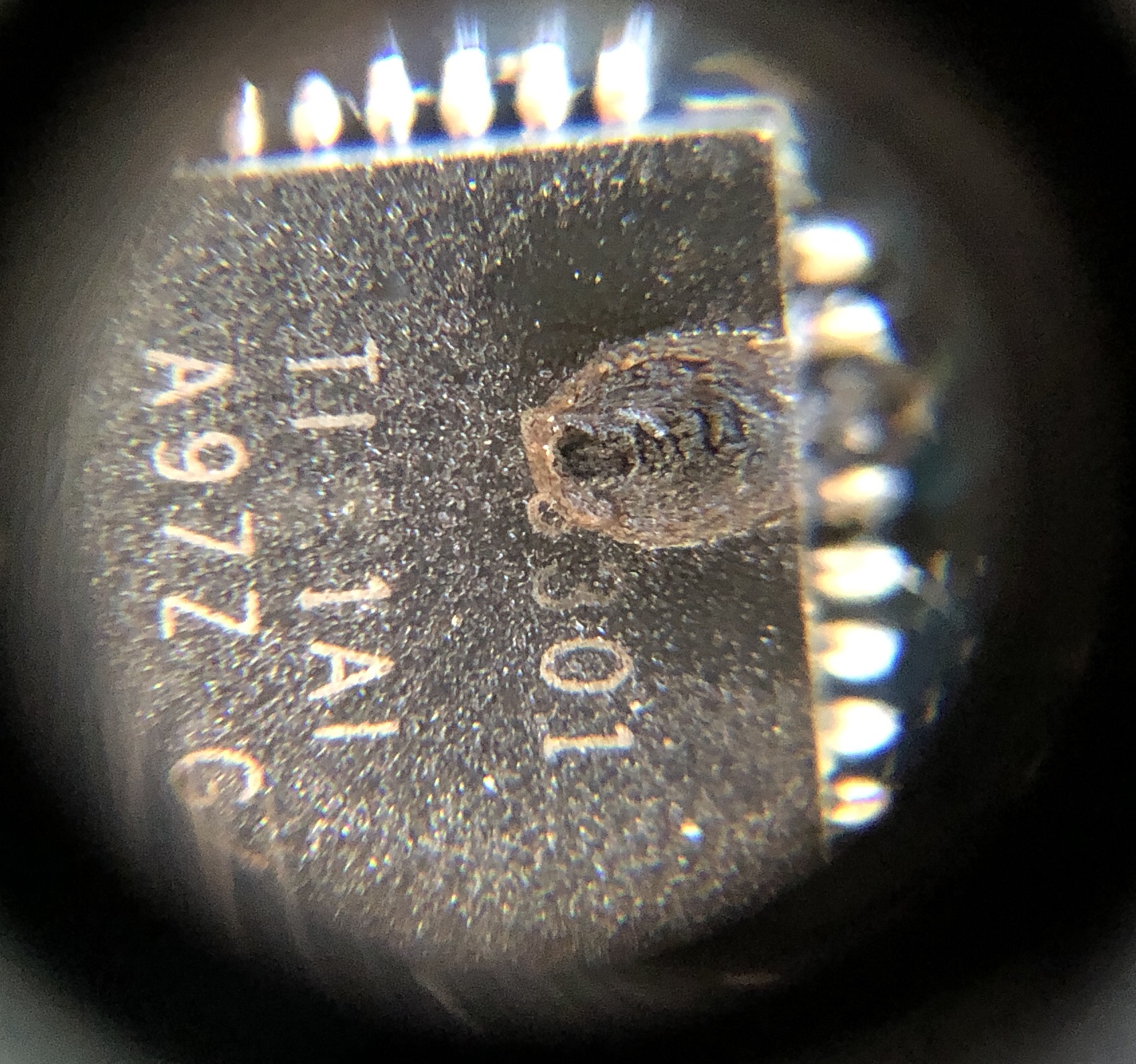

    • Jeroentje
      • Dec 2017
      • 82
      • Nederland
      maybe a stupid question but if I google on CD3301RHHR I see multple chips but the lower numbers does not match or is that the serial of the chip besides G4 ?
      • mcplslg123
        • Jun 2015
        • 7262
        • india

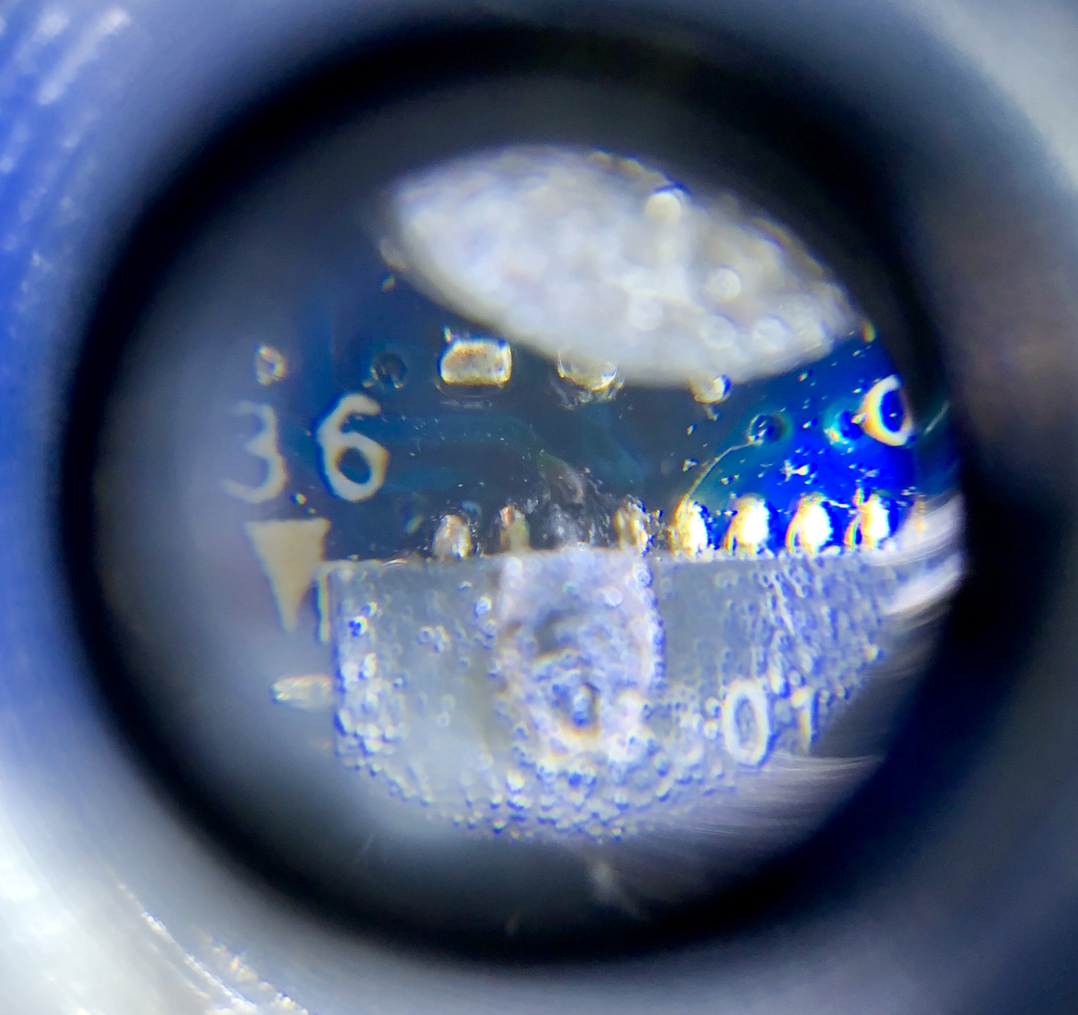

        • Computerbastler
          • Oct 2019
          • 3
          Have Brocken Pin 36. 😅

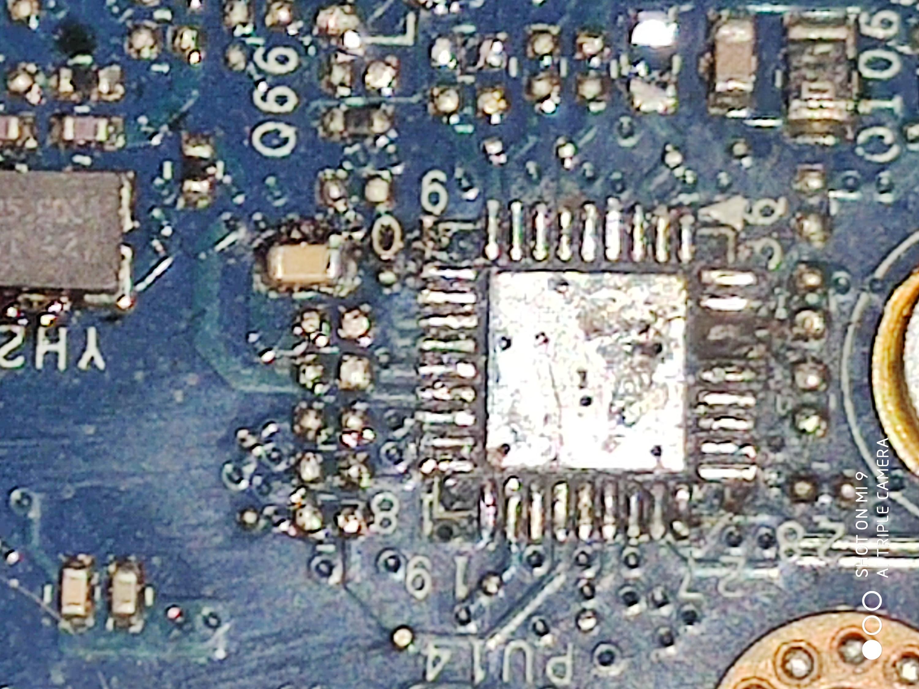

          • Computerbastler
            • Oct 2019
            • 3
            Help my to find new Pad for cabl to Pin 36
            • digitalpc
              • Jun 2016
              • 305
              • .DLL
              Check this pic, solder chip without this pin is Ok
              • Computerbastler
                • Oct 2019
                • 3
                Not Pin 36 sry Pin 34 and 33
                • digitalpc
                  • Jun 2016
                  • 305
                  • .DLL
                  Make a wire to this 2power rezistor
                  pin 34 - PR302
                  pin 33 - PR299

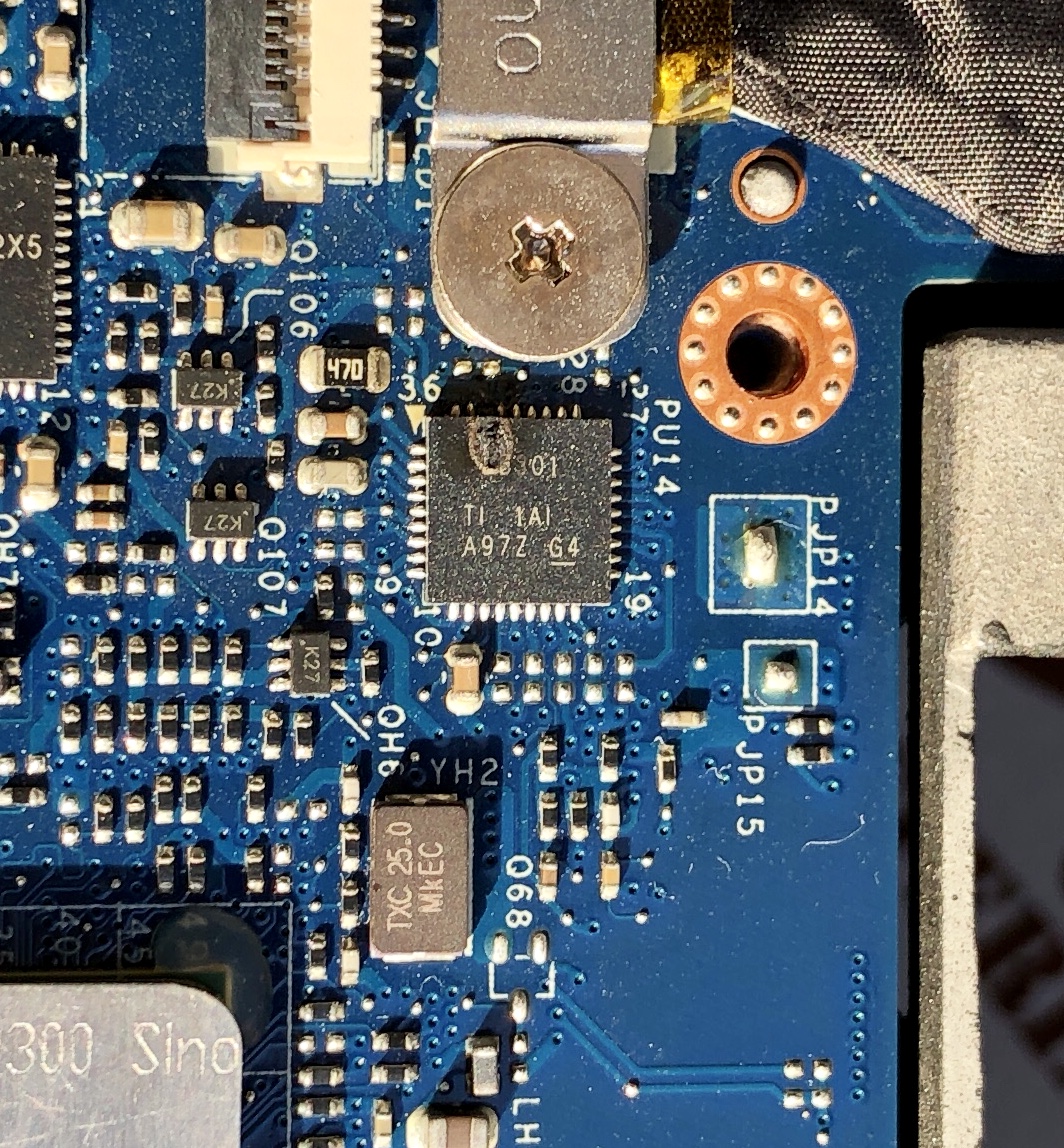

                        • TECHO TN
                          • Jan 2024
                          • 67
                          • algeria
                          to bypass the CD3301B ic power controller in the dell latitude
                          1- remove the ic
                          2- remove the two mosfet pq401 and pq402 then solder to connect between drain and source
                          3- remove the mosfet pq505 then connect between drain and source also
                          • Jeroentje
                            • Dec 2017
                            • 82
                            • Nederland
                            Fun after quite a while still some updates, I replaced the chip and all ok (years back)
