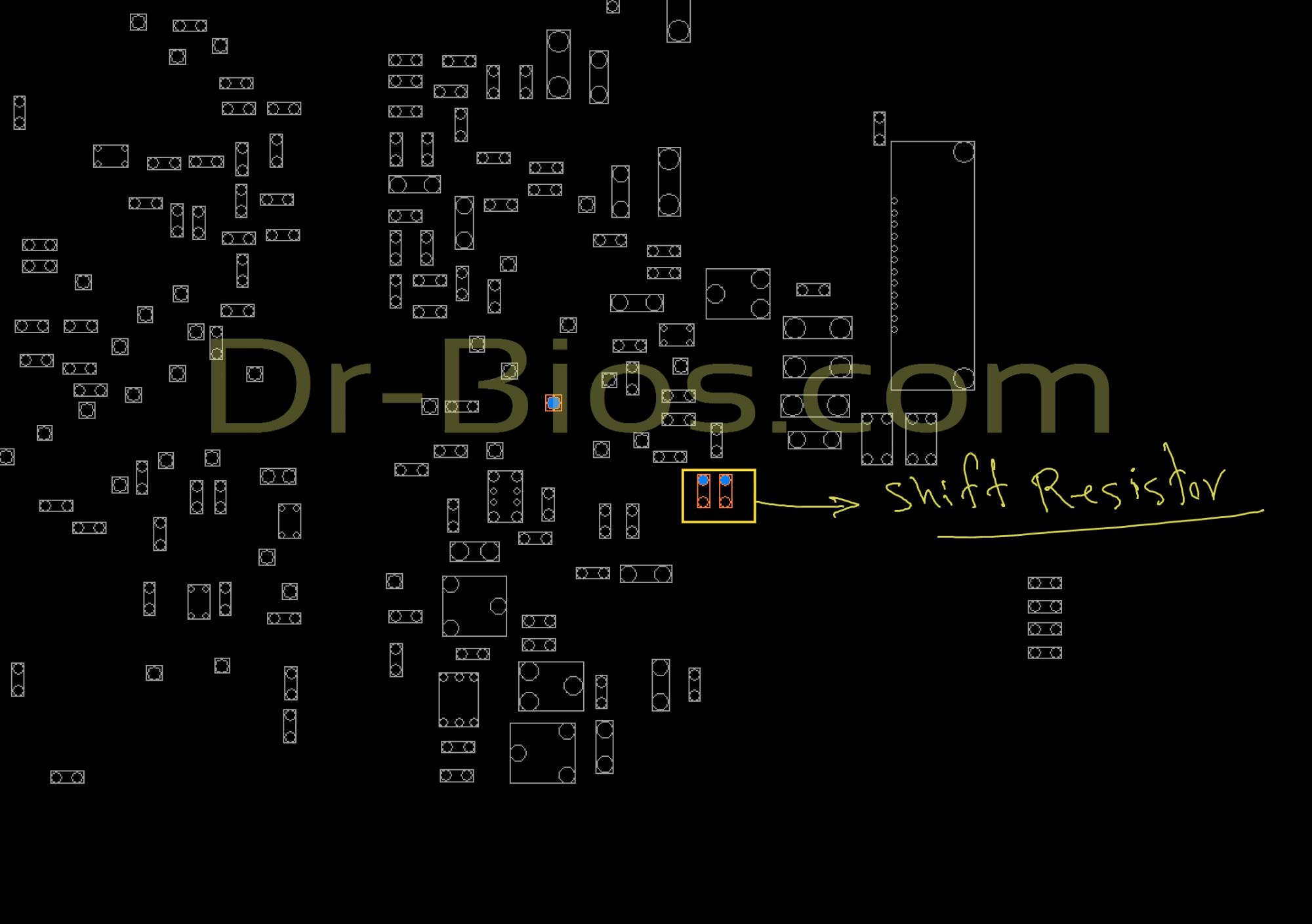

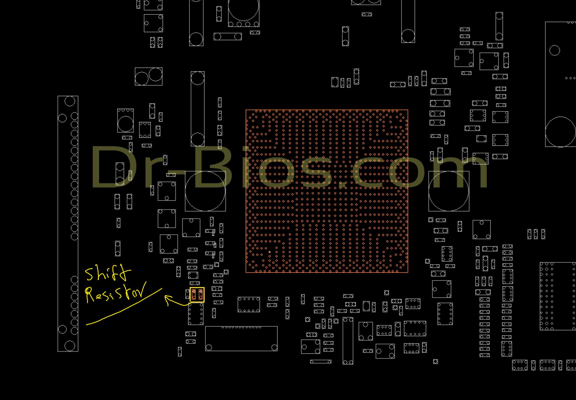

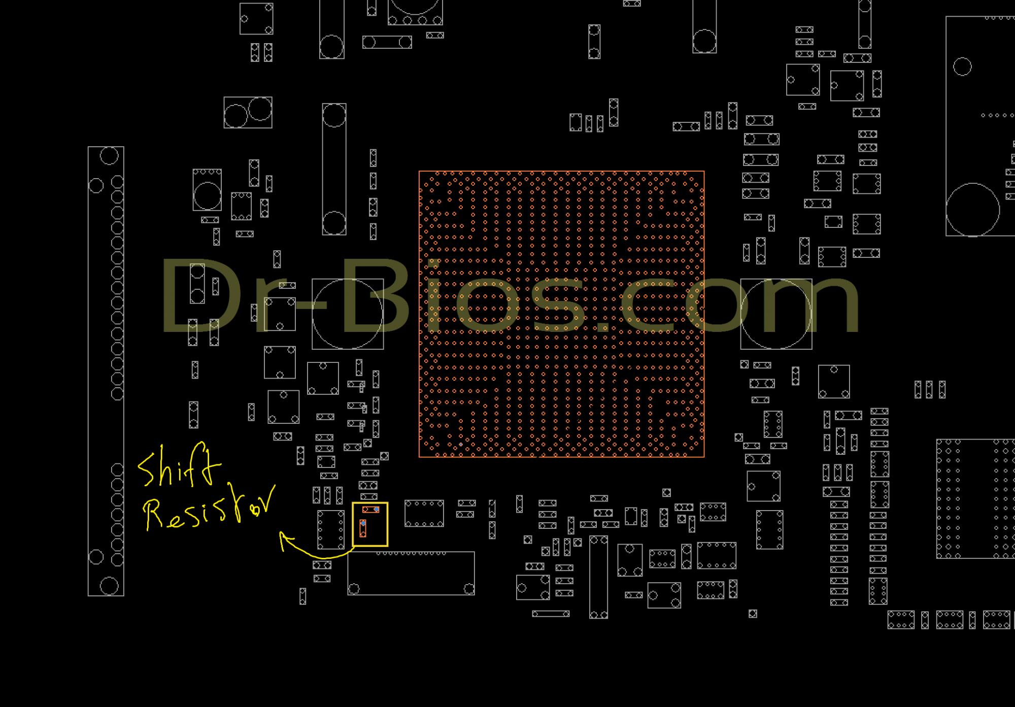

        Re: Asus X550c Black Screen And No Fan Spinning
        Morning.
        You can try disabling the on board RAM following the images attached, no idea if it works, I haven't tried it yet just keep every change in mind so that you can revert back to the current state with ease... I mean don't do it if you aren't comfortable...
        Found it somewhere on this forum.
          I tried to disable the ram by removing the resistors, I still have the same problem: turn on not showing anything on the lcd / external monitor, the power & numlock leds remain fixed when turning on, 1min after turn on the fan, and everything is like this
