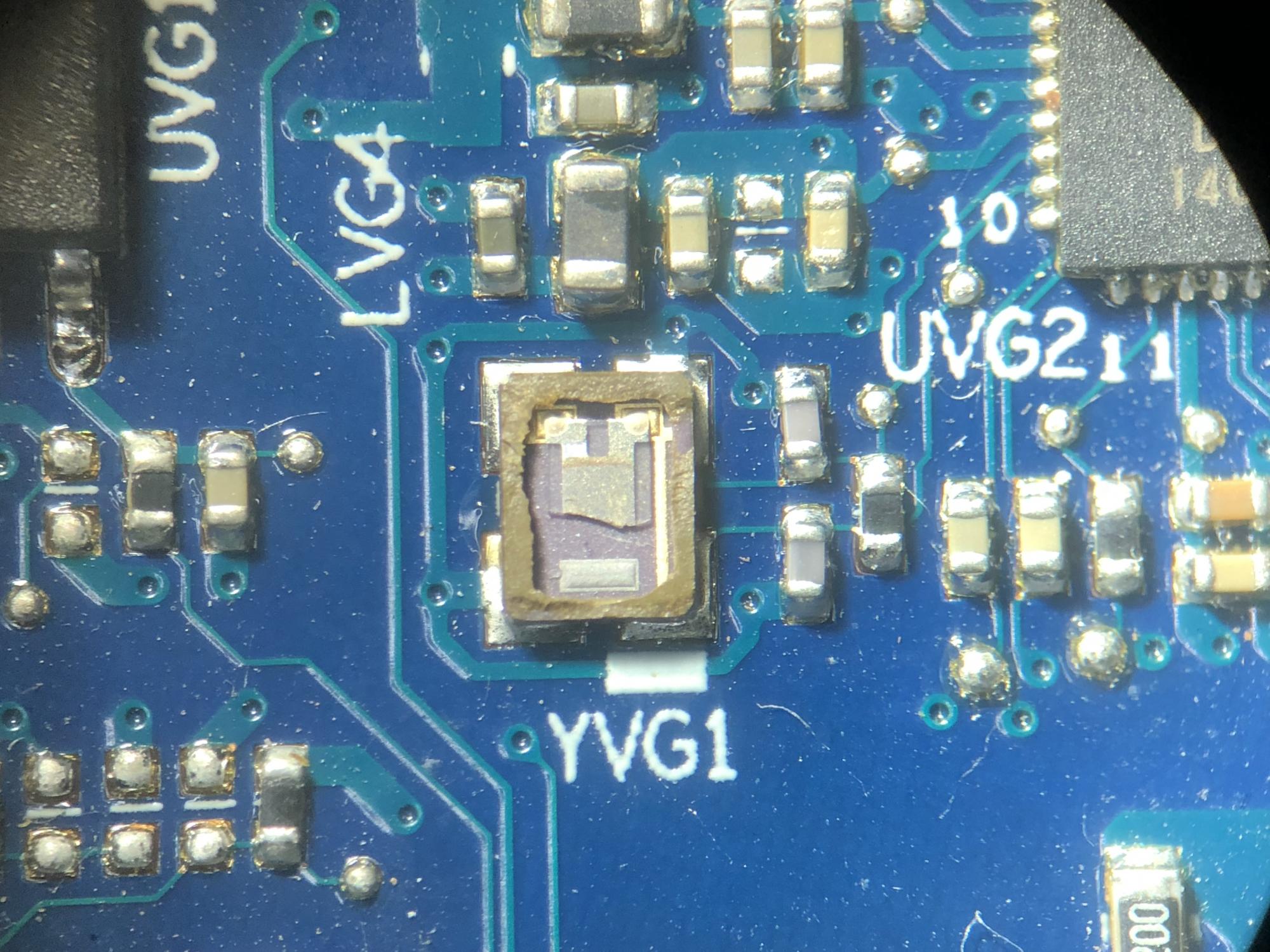

    Re: Lenovo G50-70 - power on problem
    why did you find the crystal faulty? what was wrong with it?
    • DeniS182
      • Jun 2014
      • 328
      • Slovakia
      I take photo of the crystal.
      • caspian
        • Oct 2015
        • 1591
        • Laptop
        If the crystal is faulty, replace it. Only after that, you can decide on other components.
            I replaced crystal with one from another board. Nothing changed.
