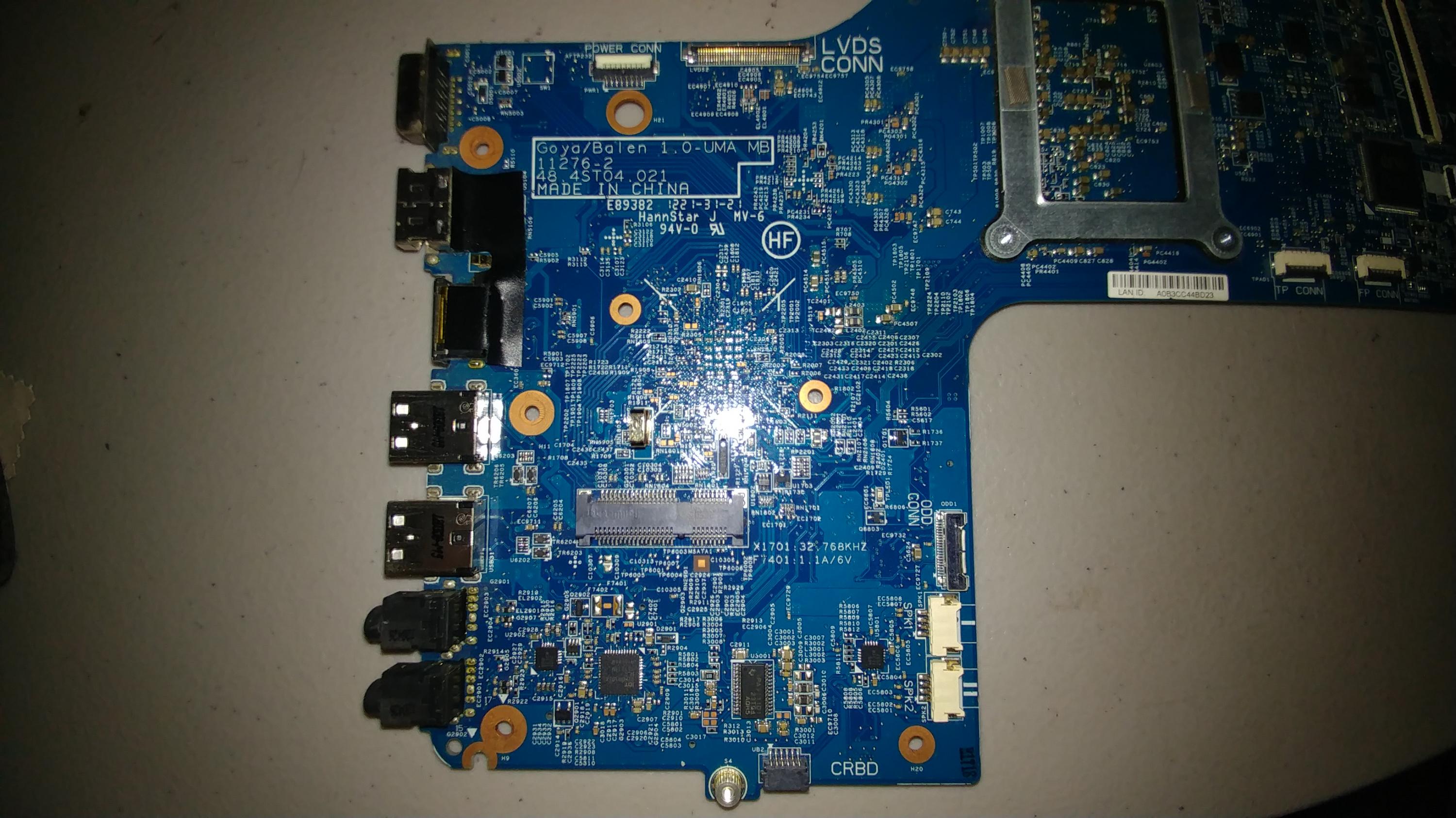

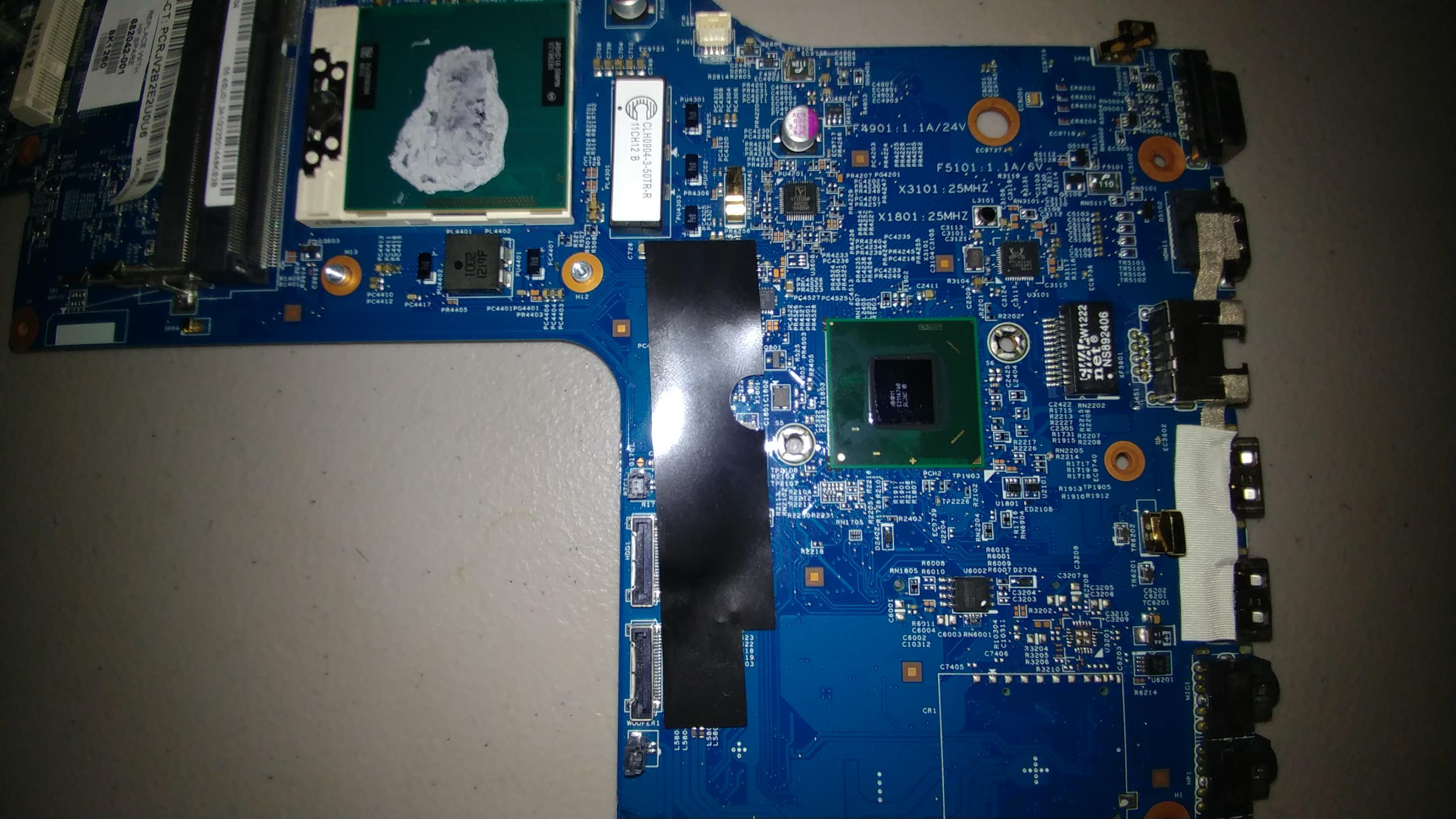

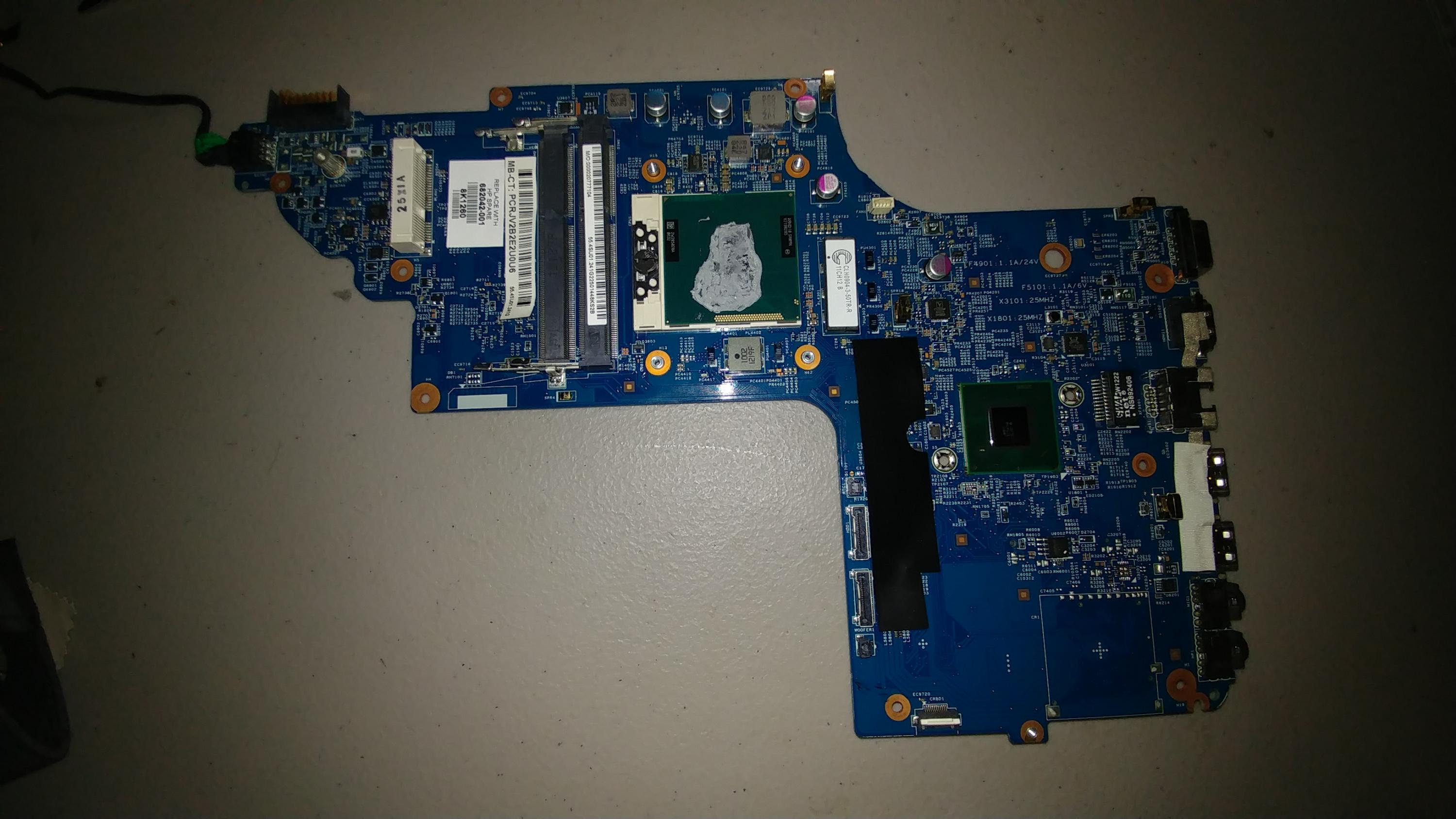

    I have a hp Goya Balen motherboard, I am a beginner to repairing motherboards. The motherboard turns on but no video, also this motherboard does not have a GPU. The question I would like to ask is what do I have to look for? It seems to me like most people would think that the problem would be the GPU, but I know it would not be that. I have checked the capacitors under the CPU and some appeared to be shorted to ground, but to make sure it wasn't I took it off the board and they were not shorted to ground. I am curious if this would be a resistor or a bios issue? I did find a schematic for Goya/Balen, but the schematic is for motherboards with GPU.
    • 21883

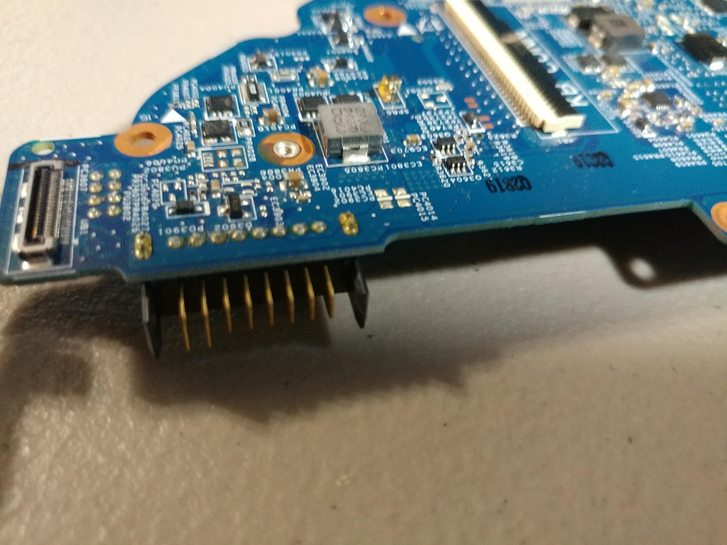

    Re: HP dv7-7133nr No Video Problem Goya/Balen

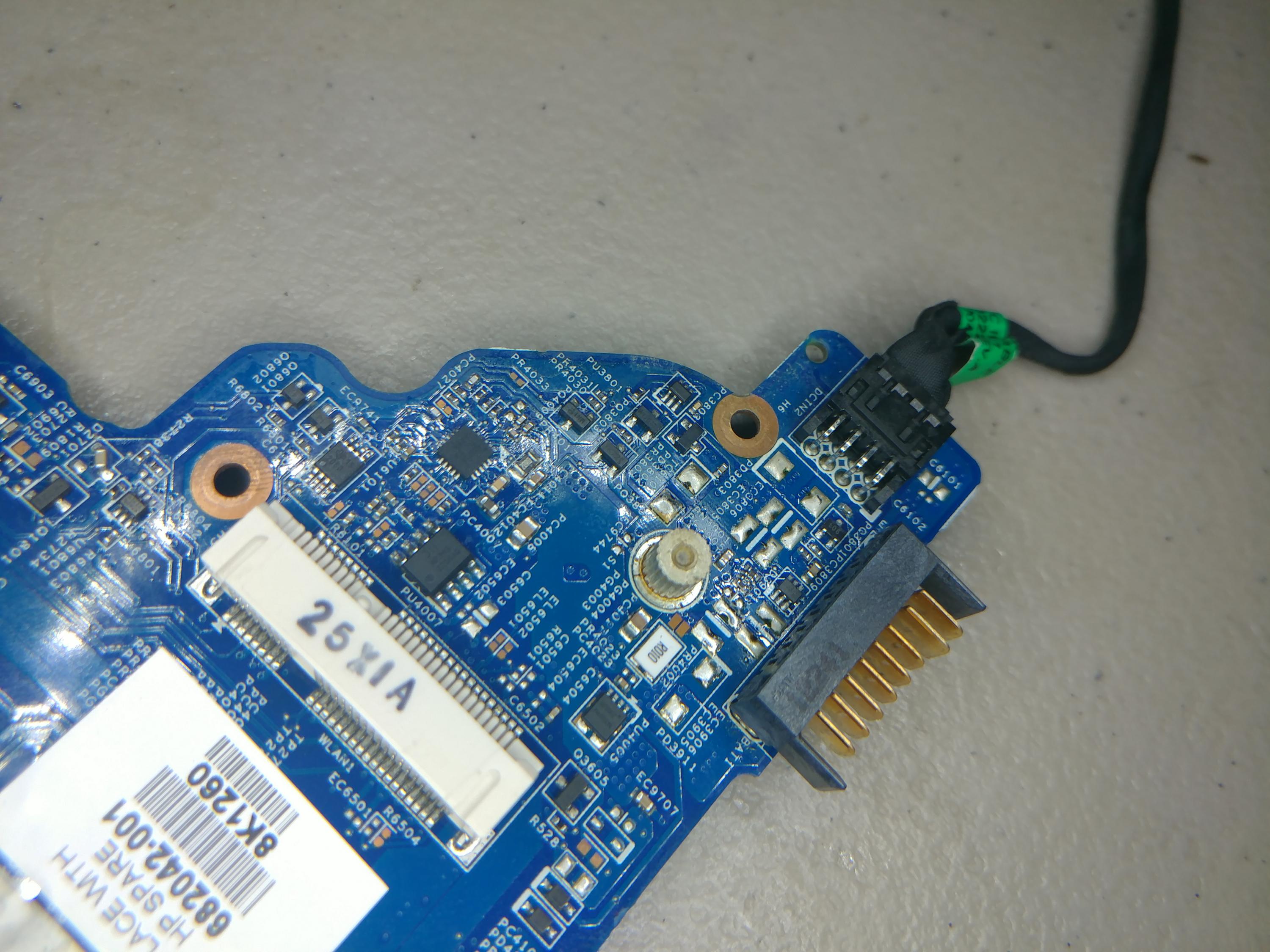

    Post a close up picture of the area around PU4002 ,SPR5,PL4001 , and a second picture to the right of PL4001
    • alextech
      • Oct 2018
      • 38

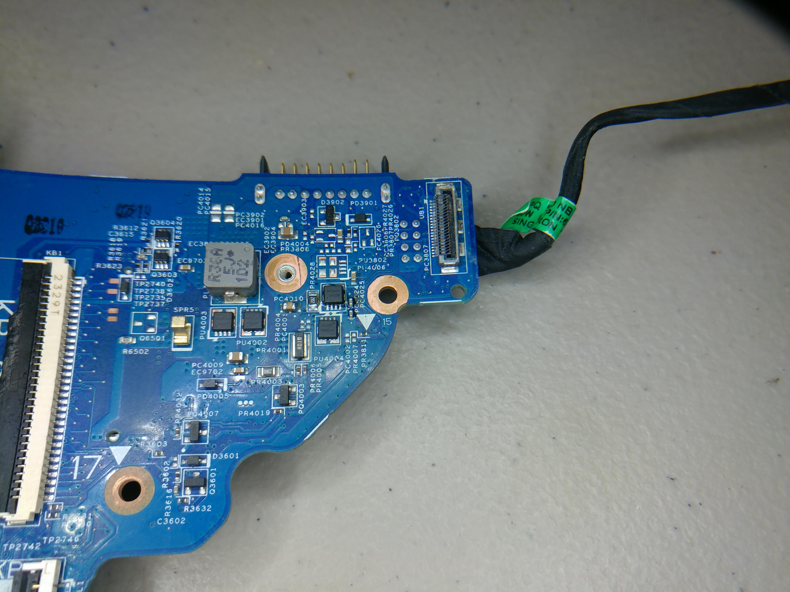

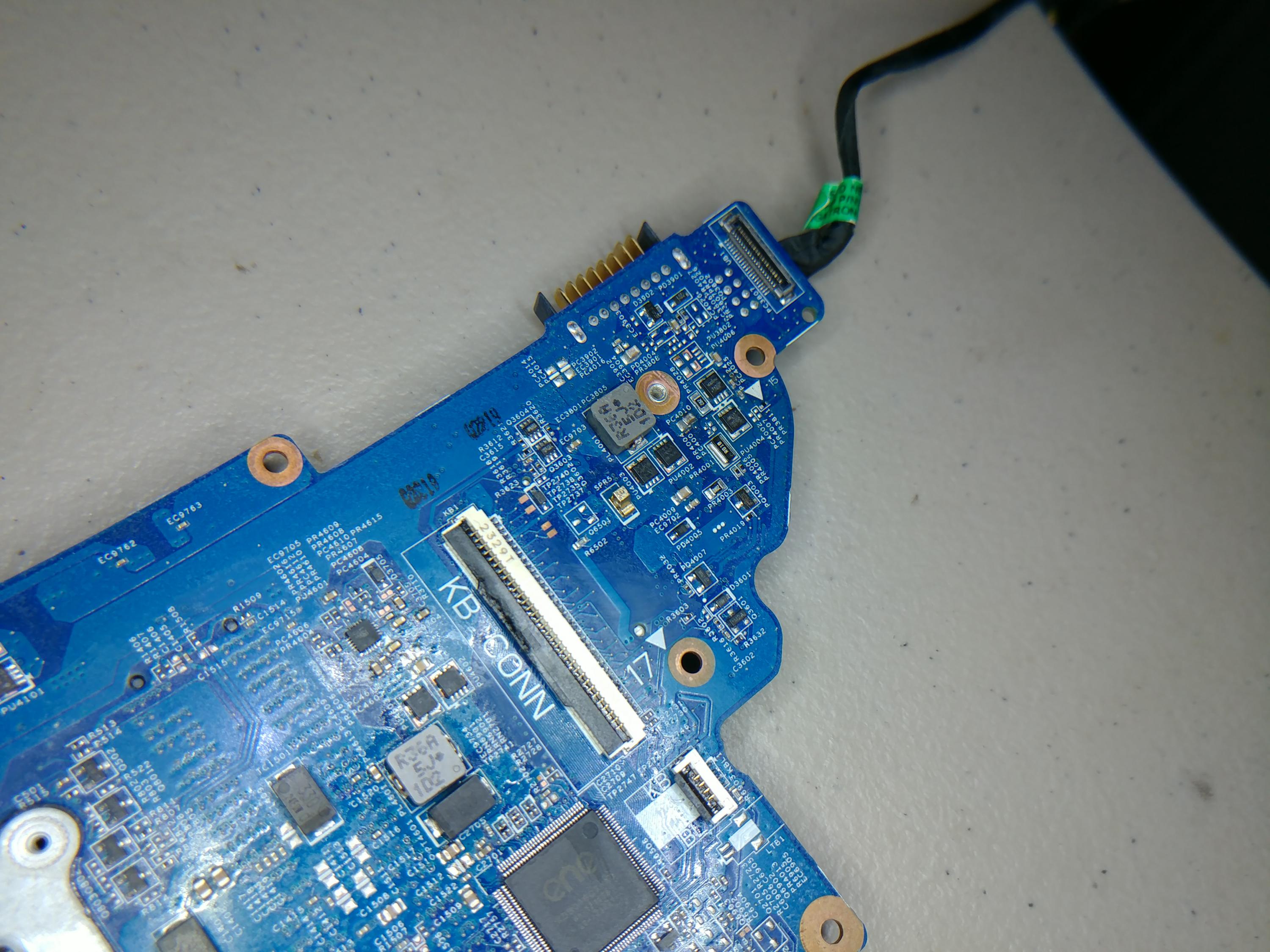

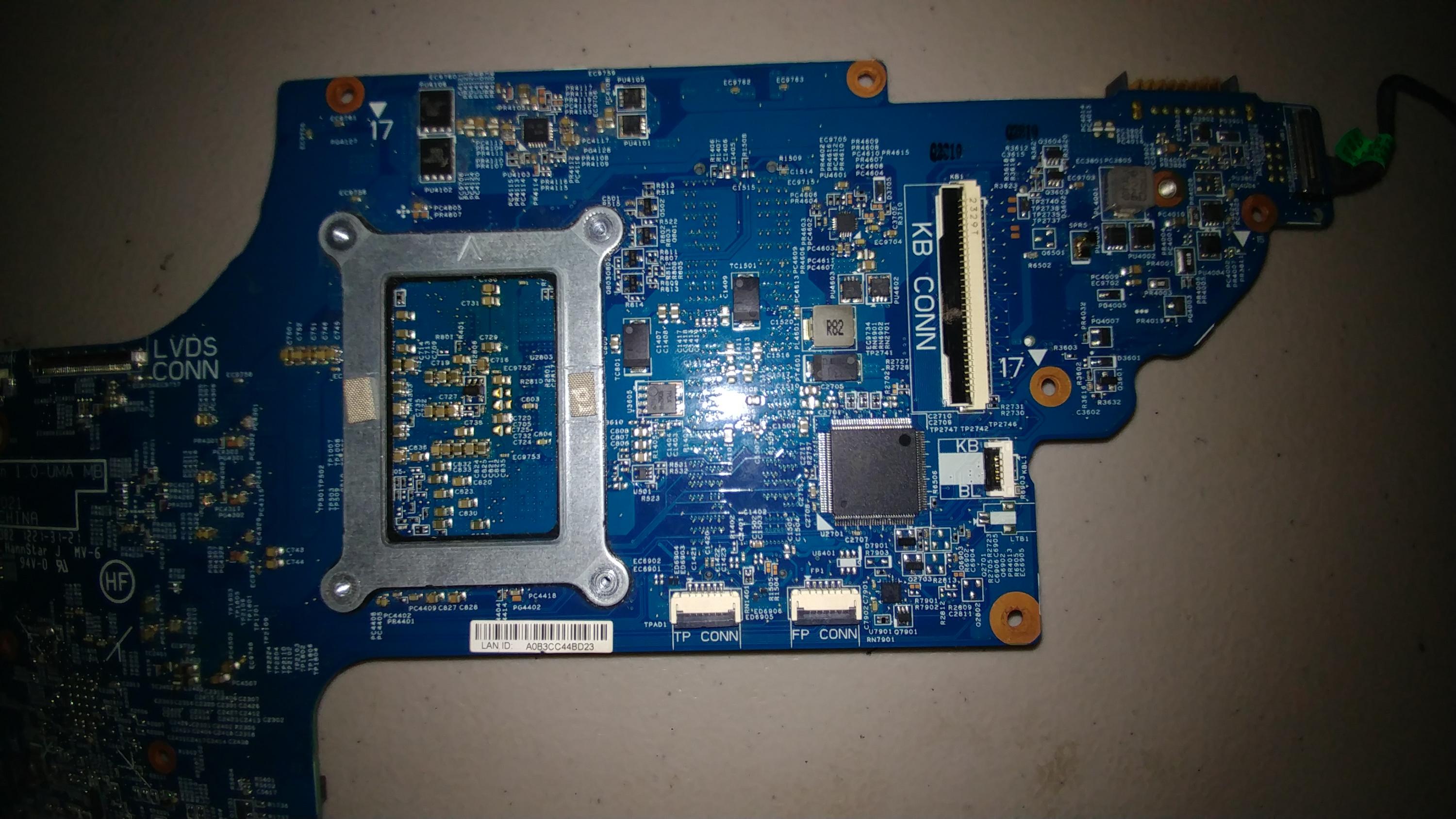

      It was kind of hard to get a focus when getting close, is this good enough? I checked the coil and there is open line and no beep on that coil. I do see like a little black dot between PU4003 and PL4001, not sure if its a burn or not.
        • 21883
        Clean up that whole area with a brush and 100% IPA alcohol. Check voltage on PU4004 and PU4006 pins 1,4,8 . Use the attatched schematic for reference

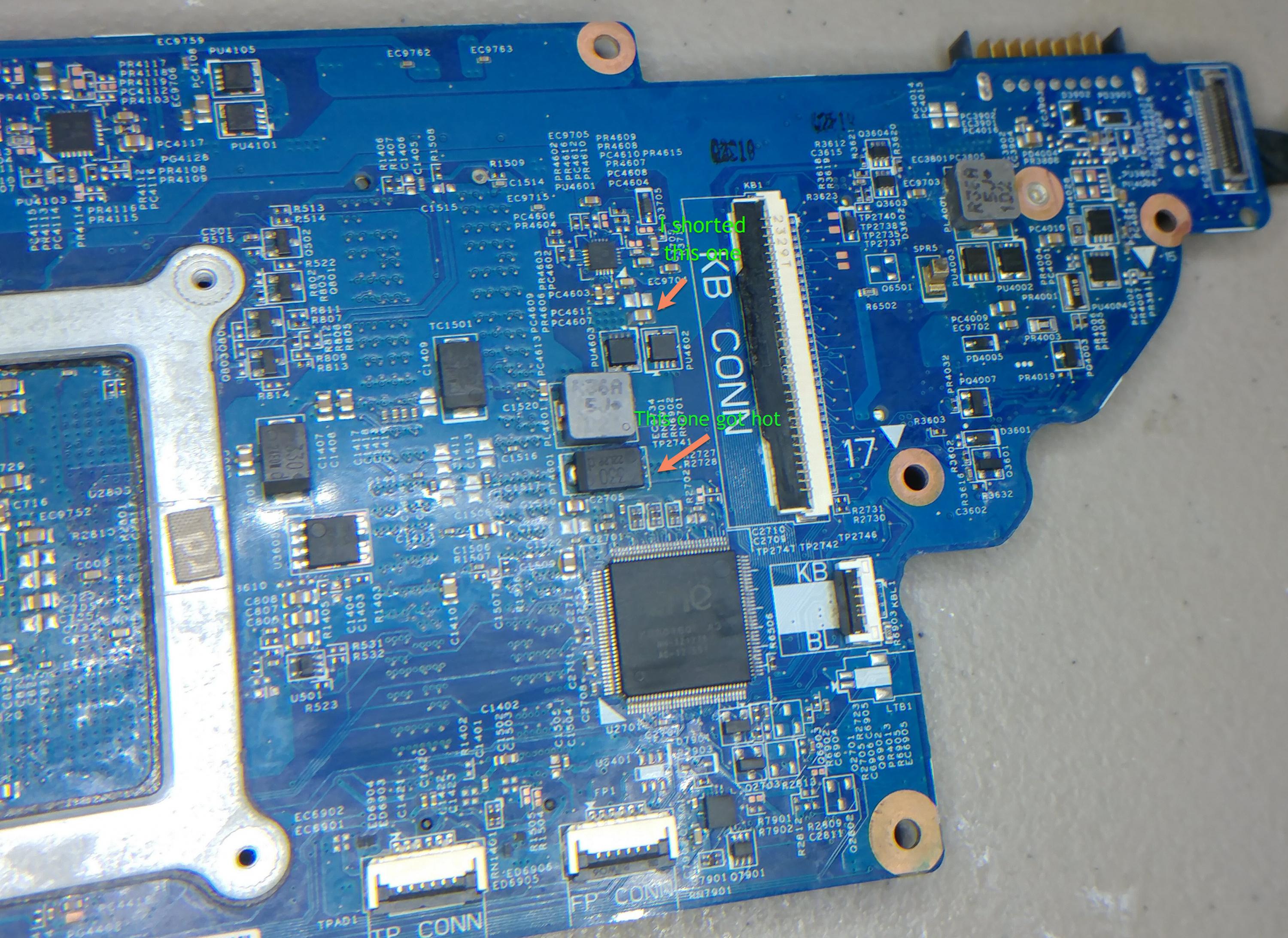

          Ok I have an update, apparently when I was checking the board I accidently shorted a capacitor with the dc in connector and resulted in no power. I shorted a cap that I touched and a diode 330 that I did not and replaced but still have no power. I bought a power supply to see if it could help me find a bad component. I checked for voltage on PU4004 AND PU4006. It appears that all pins have 3 to 4 volts except for pu4006 top pins have 19v. the volts are jumping back and forth by 1 on the 3 to 4 volts. I have not looked at the schematics just yet, I have been busy. I will get back once I have time.

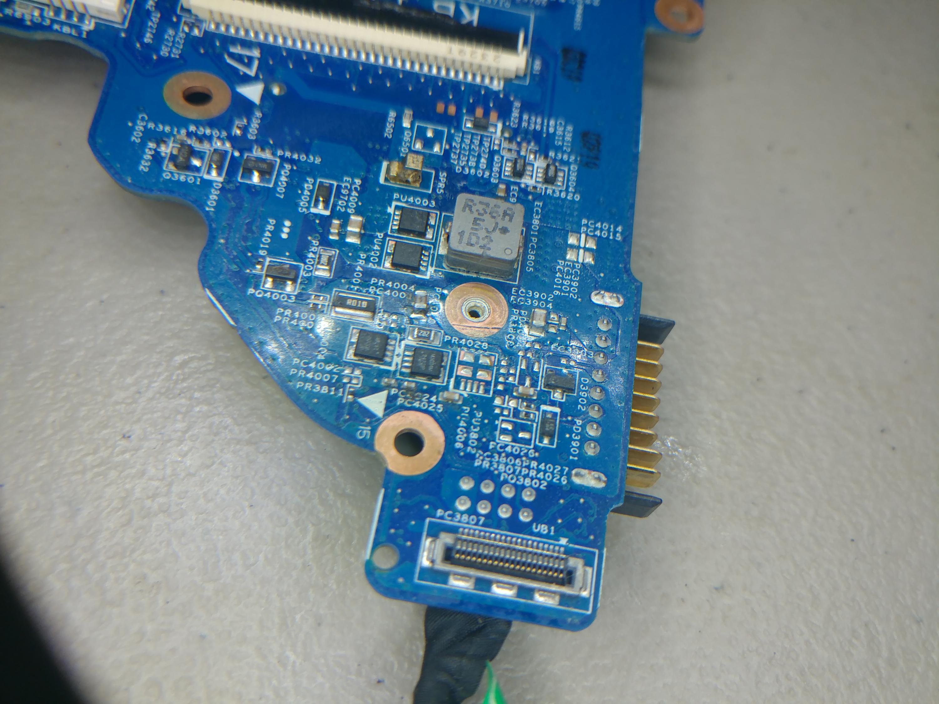

                    Ok, so I replaced the PU4006 and PU4004 and still no power. The reading on PU4006 leg 5 6 7 8 is 19v and the 1 2 3 4 are no volts. The reading on PU4004 leg 5 6 7 8 are .9 volts and leg 1 2 3 4 are no volts. The volts are not going up and down anymore. Would I need to use a power supply to load amps on PU4006?
                      • 21883
                      No ,don`t inject power just yet. Check volts on pin 6 of PU4001, then disconnect all power and test ohms to gnd on pins 1,2,3,4 and 6 .

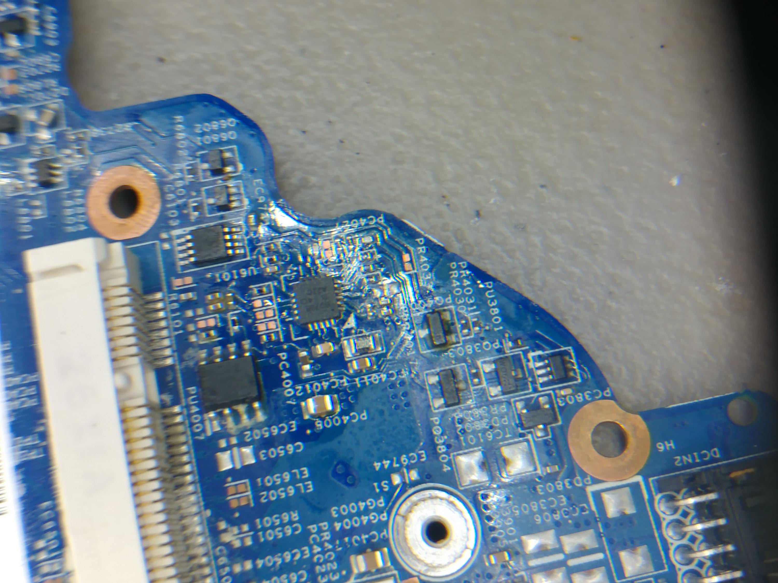

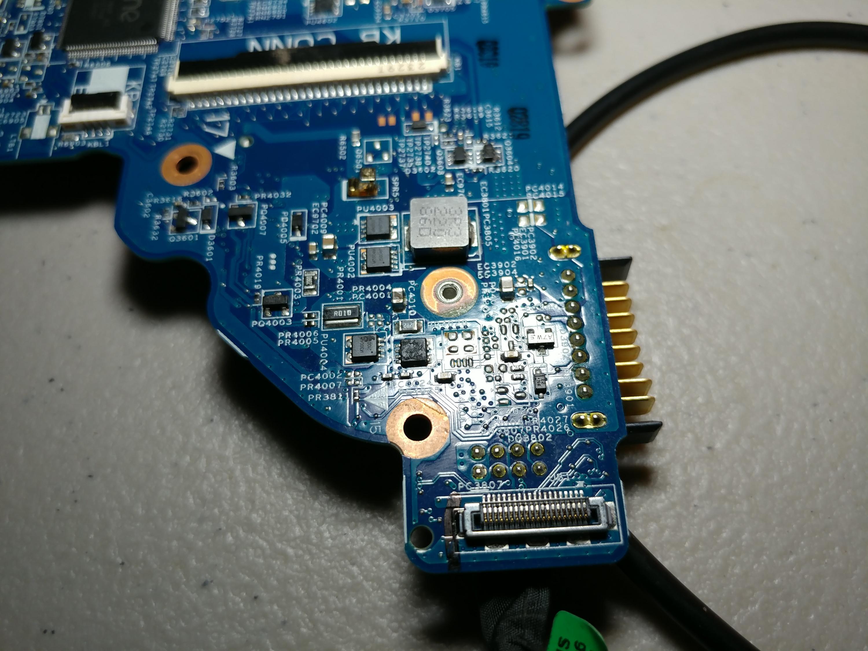

                            PC4010 looks burnt. SC2D2U25V5KX , 2.2uf 25V .Replace it and do the same tests.
                            EDIT: PQ4003 on the board looks like it has a burn mark on the top
                              PC4010 and PQ4003 looks like that because of the no clean flux I used, I thought I bought the flux I was looking for like they use at my job but it wasn't. I put too much thats why it looks like that, I left a note for that. I will try to clean it more. PC4010 I was going to replace but realized there was still 66 k ohms on the board, so I decided to put it back. I need to check SC2D2U25V5KX, Is this not shown on the picture or are you referring to PC4010? I will replace PC4010 just in case though.
                                • 21883
                                PC4010 is on the board.On your picture at post #12 it looks burnt or its not seated across both pads. PC4010 on the schematic has the part number SC2D2U25V5KX.You need to replace the BQ24738 , its not going to be easy though if you`ve never soldered a QFN IC before.Practice first on some other scrap boards,watch youtube videos, use plenty of flux and a fine tip on the soldering iron.
                                • alextech
                                  • Oct 2018
                                  • 38
                                  Thanks for letting me know to practice on that one, I will practice with some scrap boards before I change it. I replaced PC4010, should look a lot better now.

                                    Also I have a pic where the short happened and the BQ738 IC chip that I replaced:
