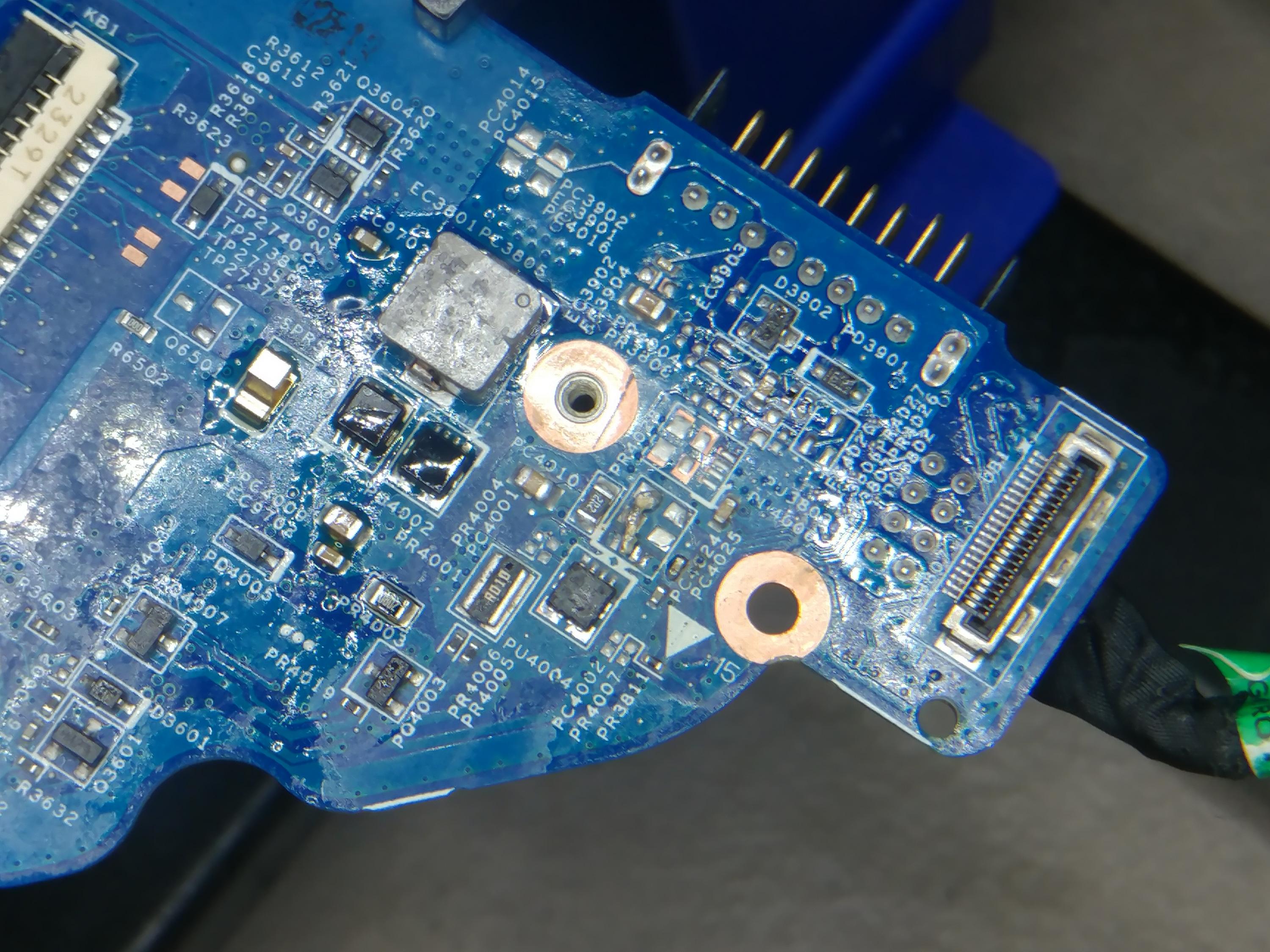

    If I inject 19v through the first mosfet, the first 3 pins of BQ24739, it get 18.5v. PC4016 has 3 volts, charger connector, pin 7 blow smoke if I inject on this capacitor once probed by DMM. I did not intended to inject on this capacitor on purpose btw. Also, having the first mosfet jumped causes spark to the DC IN charger. Any help would be appreciated.
    • on/off
      • Oct 2016
      • 333
      • Indonesia
      Re: HP dv7-7133nr No Video Problem Goya/Balen
      Originally posted by alextech
      1 4 ohms
      2 4 ohms
      3 4 ohms
      4 OL
      6 60 k ohms
      AD+_IN= voltage power come from adapter.
      DCBATOUT=DC or Battery output, come from battery if board install battery (as backup power), but mostly this TP (test poin) from adapter cause via Current Resistor. So ad+_in & dcbatout are power for system that feed for motherboard at first time connect via adapter or battery.
      Mean AD+_IN / DCBATOUT shorted to GND, you must find what the causing that line shorted first.
      Dont plug adapter or battery till shorted has gone.
      For more understand labeling on wistron PCB with help BV of motherboard.
      https://www.badcaps.net/forum/showpo...96&postcount=4
      Open it with:
      http://boardviewer.net/index
      https://openboardview.org/

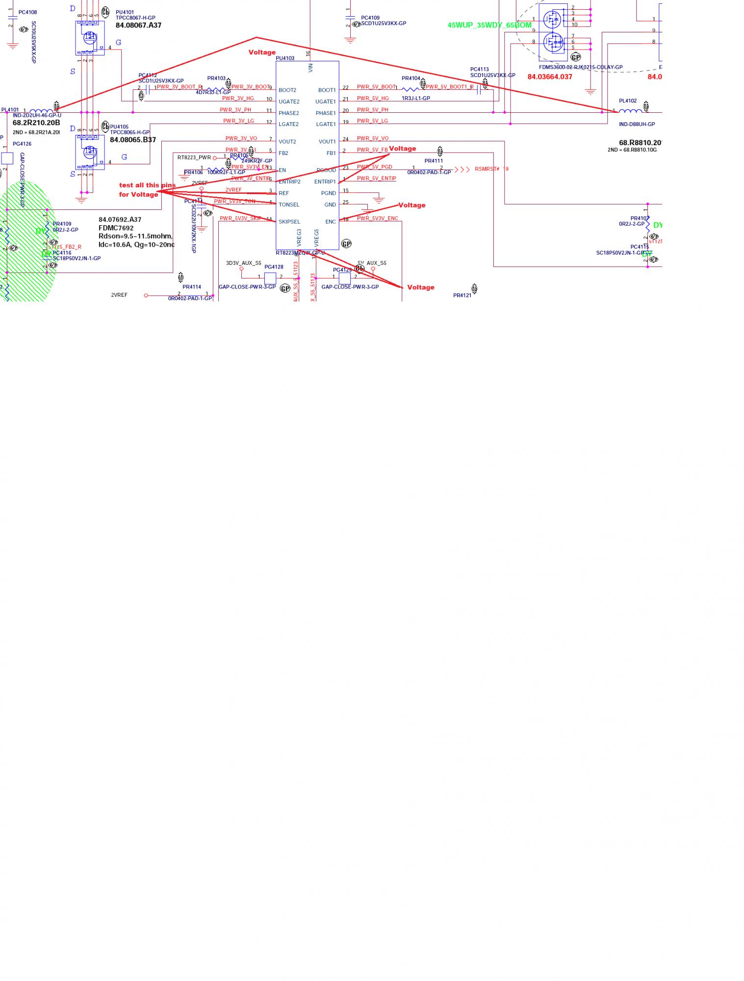

          ok alextech now test all this points you have to locate the area of strange noise also
          • alextech
            • Oct 2018
            • 38
            Ok I checked the test points and I do not really here any noise anymore, perhaps it was just on the DC-IN plug. I did talk to somebody about this issue and thought maybe it is a diode issue? Here is the result:

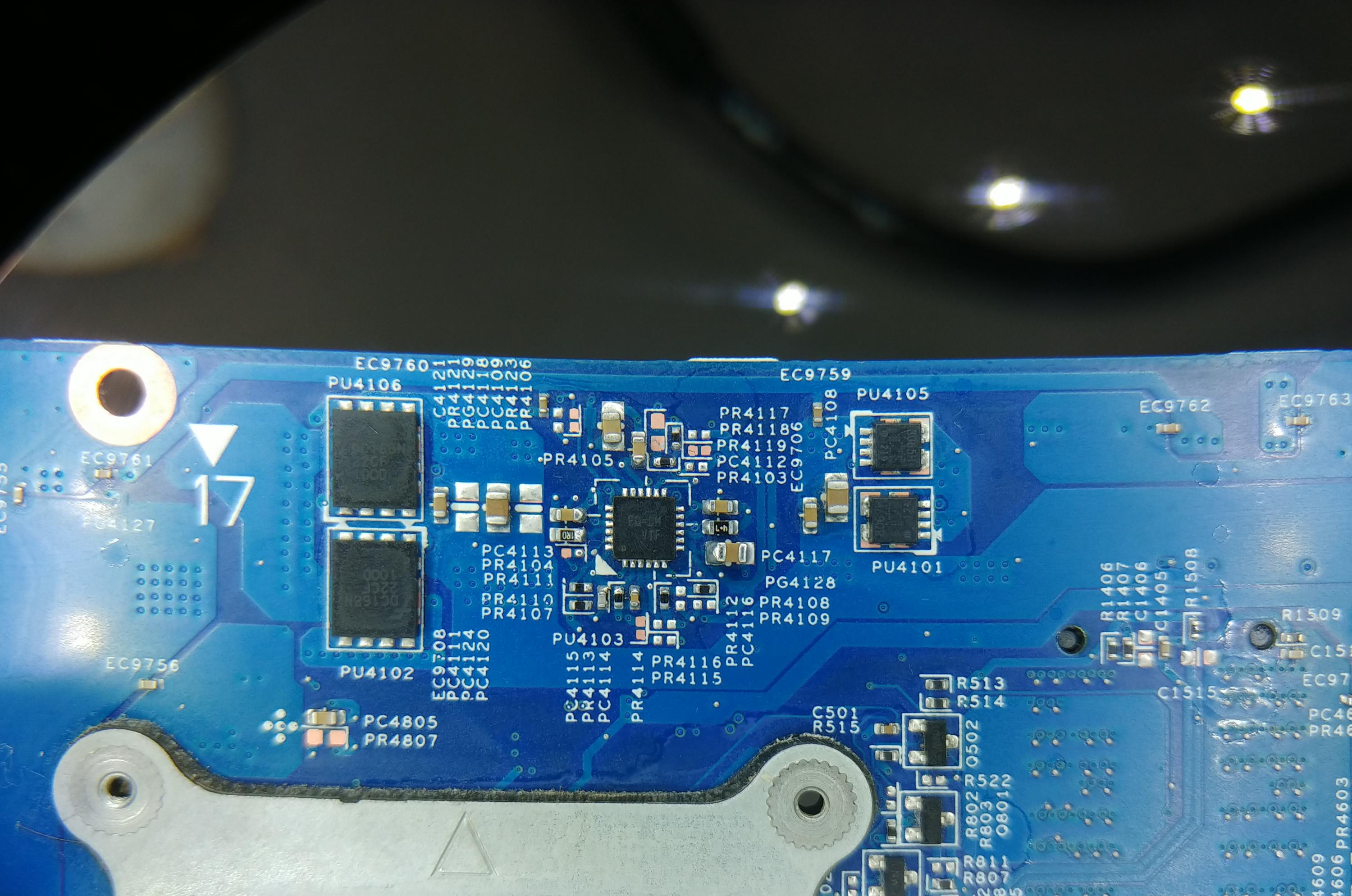

            PU4103 (PWR CONT)
            13: 5.4
            3: 0v
            4: 0v
            14: 0v
            1: 0v
            6: 0v
            8: 0v
            17: 0v spark reaction on red probe 1st try only

              PU4006 is still there or you have put a Jumper?
              PR4001
              1: Always 19v
              2: Intermittent 19v (doe’s the voltage Drops )
              PU4103 3V & 5V regulator is not working test pin 16 VIN it should be 19V
              pin 17 spark reaction that's bad test the cap pc4118 for short test pin 17 without any power Ohm

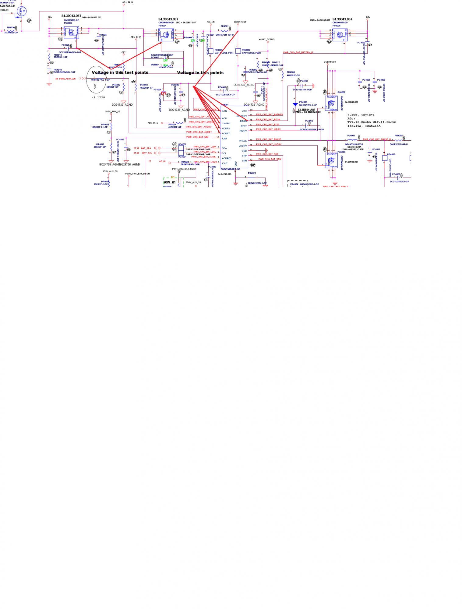

                  Check on short between B+ PU4005 any short to Gnd, FETs
                  The jumper you have put PU4006 pin 5678 to 123 only? Pin 4 no jumper
                  Here are the measurements you should get on this pins made on BQ24738
                  PIN 1 19.19V
                  PIN 2 19.19V
                  PIN 3 19,19V
                  PIN 4 25V
                  PIN 5 6V
                  PIN 6 2,6V
                  PIN 16 6V
                  Change PU4103 it’s not working or bad soldering
                  as for PC4118 ONE side is GND and read 0.03 ohms next side may be the is short in side dont' chance every time SMD compenents with out knowing the value send a pic of the IC that you have change

                      as for PU4005 is a N-Channel Fet place the Red Probe in either of pin 123 pins Source side & Black Probe in either pin 5678 Drain side test Value & Black Probe in pin 4 Gate Red probe in Source either of pin 123 for Value & Black Probe in pin 4 Gate Red probe in Drain either of pin 5678 for Value
                      PU4005 pin 5678 is not good PR4001 is Connected with this Fet @ need help from another BADCAPS MEMBER FOR THIS @
                      read the page 6 & 7 PDF

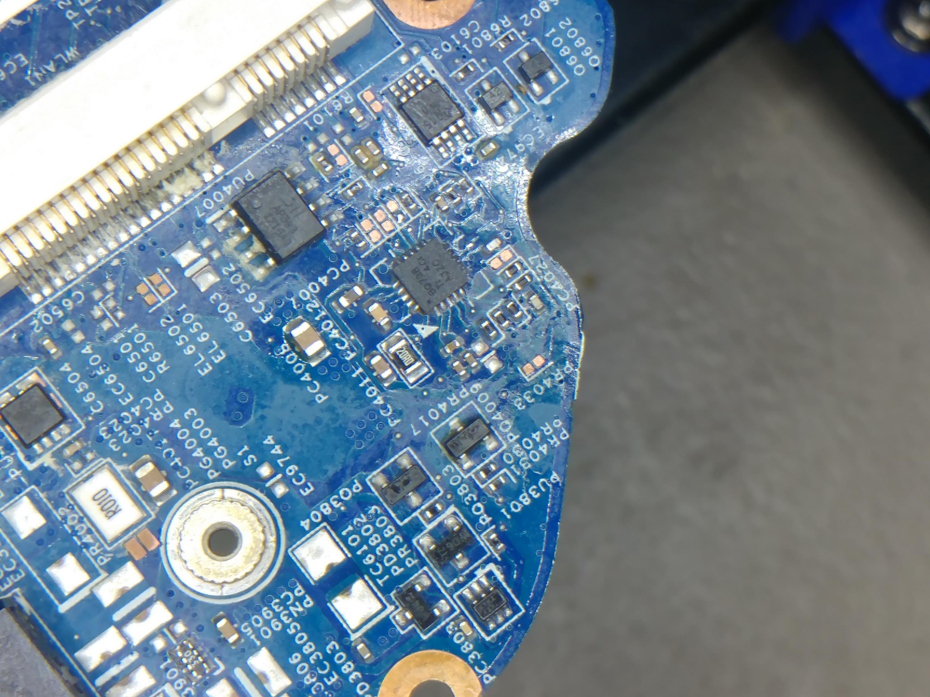

                            Ok I changed PU4005, also I noticed that when there is light on the charger there is about 5v on pin 17 and 2v on pin 2 3 4 and pin 8 has 3v. Then when the light goes off it has 0v.
                            • on/off
                              • Oct 2016
                              • 333
                              • Indonesia
                              #34
                              The Light on Charger???
                              or
                              The Light on DC jack???
                              Check resistance on DCBATOUT (Test point=PR4001)respect to GROUND
                              Would be help if you also measure on all grey coils (PL4xxx)
                              Also I'm noticed your DMM probe still Thick, when you troubleshooting problem on laptop and other device that have lot tiny component you should use needle probe.
