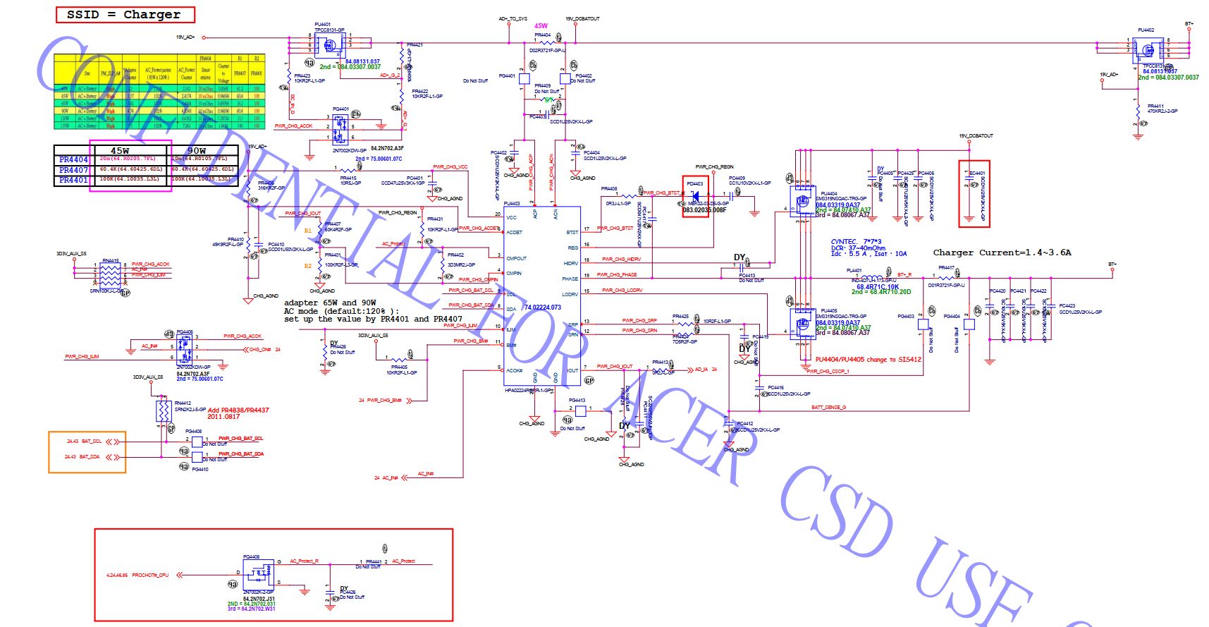

    Hello
    Ihave laptop Acer ES1-571 Not charging any more
    Please help me
    Charging Circuit HPA02224RGRR-1-GP
    thes is all voltage from charging circuit
    ACP & ACN & VCC
    19.22V
    ACDET
    2.6V
    CMPOUT & CMPIN
    0.20V
    SCL & SDA
    3.4V
    ILIM
    3.36V
    BM#
    3.38V
    ACOK#
    0V
    IOUT
    0.033V
    SRN & SRP
    2.71V
    LODRV
    0V
    PHASE
    2.71V
    HIDRV
    2.71V
    REG
    6.05V
    BTST
    5.93V

    Re: Laptop acer es1-571 no charging
    Lodrv and Hidrv reading doesnt seems good. Check Low and High side fets
        PU4404 is High Side and PU4405 is low side fet. I asked you to check them. Specially notice the voltage on pin4(Gate) of both the fets. I hope you understand now.

          Got the same problem, same model Acer Aspire ES1-571 DOMINO_BH MB 15300-1
          Replaced from donor MB PU4403, PU4402, PU4404, PU4405, PQ4406, PQ4401 no changes. Laptop works fine from charger and from battery, but not charging. Blinking orange light. Original battery not working - locked, tested with two new (known good) batteries, Not charging. Please any advice.
          My measurements:
          Charger BQ24737 PU4403
          Charger+Battery| Battery | Charger only
          1 ACN 19.5 | 14.94 | 19.50
          2 ACP 19.5 | 14.94 | 19.50
          3 CMPOUT 0.01 | 0.22 | 0.00
          4 CMPIN 0.06 | 0.00 | 0.06
          5 ACOK# 0.00 | 3.33 | 0.00
          6 ACDET 2.65 | 0.03 | 2.65
          7 IOUT 0.10 | 0.00 | 0.10
          8 SDA 3.35 | 3.35 | 3.36
          9 SCL 3.35 | 3.35 | 3.36
          10 ILIM 3.33 | 3.33 | 3.33
          11 BM# 3.36 | 3.36 | 3.35
          12 SRN 15.13 | 14.90 | 3.44
          13 SRP 15.13 | 14.90 | 3.45
          14 GND 0.00 | 0.00 | 0.00
          15 LODRV 0.00 | 0.00 | 0.00
          16 REG 6.07 | 0.23 | 6.07
          17 BTST 14.84 | 14.60 | 5.96
          18 HIDRV 15.12 | 14.89 | 3.44
          19 PHASE 15.12 | 14.89 | 3.46
          20 VCC 19.49 | 0.26 | 19.49
          Battery conector BTY1
          Charger+Battery |Battery | Charger only
          1 BT+ 15.12 | 14.90 | 3.44
          2 BT+ 15.12 | 14.90 | 3.44
          3 BAT_G 0.00 Goes to GND(battery present pin)
          4 BAT_IN#_1 0.3 | 0.30 | 3.33
          5 BATA_SCL_1 3.35|3.35 | 3.36
          6 BATA_SDA_1 3.35|3.35 | 3.36
          7 GND 0.00
          8 GND 0.00
