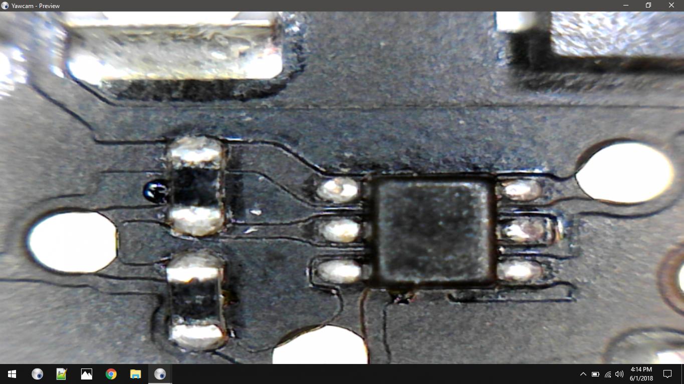

    Hello again, everyone!
    I have a MacBook Air motherboard, 820-00165-A that won't boot up. The computer spent an hour on the beach, which was plenty enough to fill it up with sand and/or salt. After that, it showed no signs of life, not even a charging light. I removed the motherboard and cleaned out all the salt, which had caused some damage to J6100 and U7090, so I cleaned up U7090 and just removed J6100. After cleaning I get a charging light which switches from green to orange, but it still won't boot. I also ran it through an ultrasonic cleaner, whcih didn't help. I confirmed that U7090 is working, it's properly outputting PP3V42_G3H.
    PP5V_S4RS3 and PP3V3_S4SW_SNS are 0V. The other S4 rails are fine, but just these two are 0V. Neither of them are shorted to ground.
    I checked on U7501, which creates PP5V_S4RS3 and confirmed that it seems to be working, as U7501 is creating PP3V3_S5_REG_R.
    I checked on U8050 and it's getting voltage in, but is not outputting PP3V3_S4SW_SNS. SMC_SENSOR_PWR_EN is 0V, so I suspect that U8050 is not being told to turn on, but I am unsure of that.
    I've attached schematics and boardview just in case anybody needs them!
    Does anyone have any advice on what to troubleshoot next? I'm at a bit of a dead end from what I know how to do.
    Thanks!

    SMC_SENSOR_PWR_EN might be Q5500 shorted or corrosion/smutz

      I checked it out, It's getting 8.6V from PPBUS_G3H, but not SMC_SENSOR_PWR_EN (as expected) and isn't outputting PBUS_S0_VSENSE. Also SMC_SENSOR_PWR_EN isn't shorted to ground (nothing on Q5500 is shorted to ground either). The area looks really good, I've attached a picture just in case, though!

                    Have a good look at all the probe points for liquid damage/corrosion. Have a look at J4800 pin 10

                      Pin 10 looks a little meh, but it gets continuity between both far ends (the far edge of the pad and the other side of the connector, if that makes sense) and isn't shorted to either of the adjacent pins. Also 18 and 17 look similarly meh, but test fine.
                      I checked out all the probe points and they all look fantastic, golden and shiny
