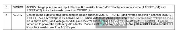

    I've got no DC jack light, when charger is plugged in. After presing power button the DC jack LED blinks 3 times and that's it.

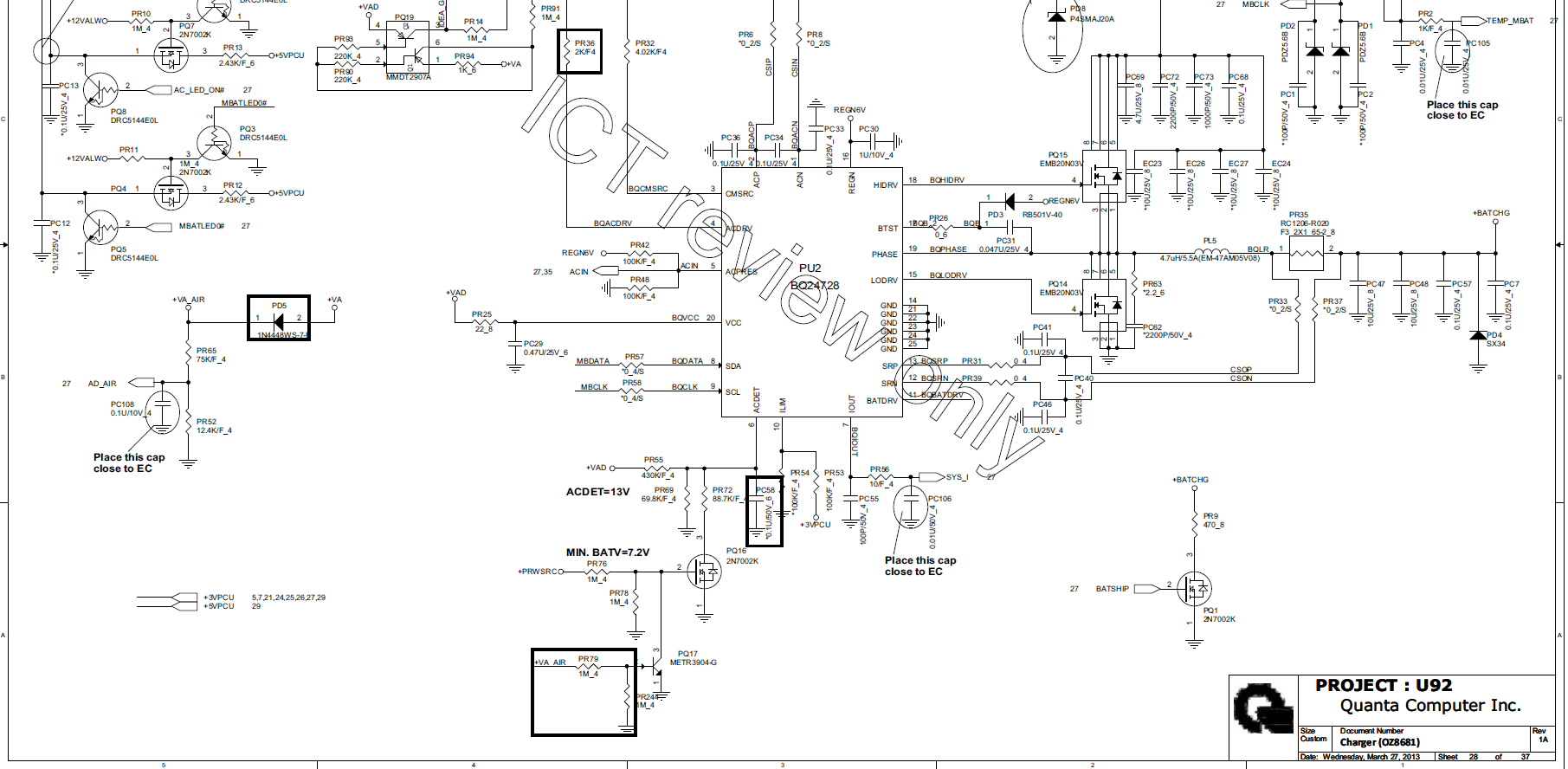

    So measured PU2 & PIN6 (ACDET) is only 2.7V...All other voltages on PU2 seems to be OK...
    Voltage on PR55 is 19V on one side & 2.7V on the other one...
    PU2 (BQ24728) voltages:
    PIN1=19V
    PIN2=19V
    PIN3=19V
    PIN4=25V
    PIN5=3V
    PIN6=2.7V???
    PIN7=0V???
    PIN8=3.3V
    PIN9=3.3V
    PIN10=3.3V
    PIN11=2.8V
    PIN12=2.8V
    PIN13=2.8V
    PIN14=0V (obviously AS GROUND)
    PIN15=0V
    PIN16=6V
    PIN17=6V
    PIN18=2.7V
    PIN19=2.7V
    PIN20=19V
    Also tried to re-flash BIOS SPI & replaced PQ16 & PQ17...

              can u share shematic
              There's schematic...

                        • 21963
                        Re: HP 15-n027sa DA0U92MB6D0 not detecting charger / doesn't turn on
                        PIN6 (ACDET) is ok .

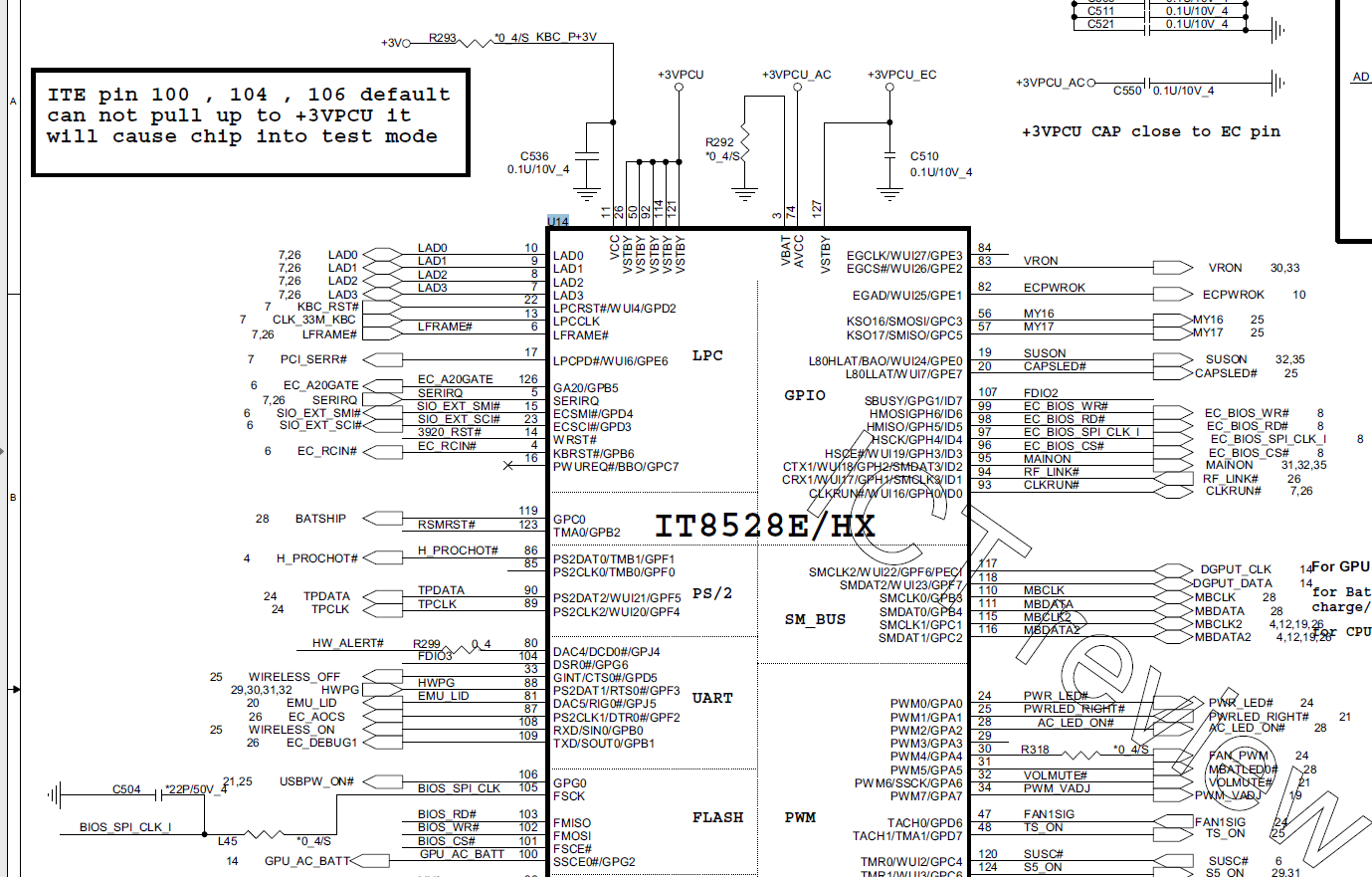

                              So the issue seems to be KBC (U14) or +3V rail as reads only 1.8V on PIN11 (VCC)...
                              I'm tired AF, so will update tomorrow...
                              • mcplslg123
                                • Jun 2015
                                • 7262
                                • india
                                Have you checked resistance to gnd on vcc pin of kbc?? Something must be pulling the voltage down from 3v to 1.8 v.
                                After a proprer measure you can try removing the kbc and then powering on mb(without kbc soldered) and observe the differences.
                                      KBC Voltages:
                                      PIN71=0.8V???
                                      PIN11=1.8V???
                                      PIN74=3.3V
                                      PIN127=3.3V
                                      PIN26=3.3V(assume all other VSTBY have correct voltage)
                                      Resistance on PIN11 is about 114KΩ
                                      • loser18
                                        • Nov 2013
                                        • 274
                                        I was giving you wrong voltage of PIN 11 on KBC...I was reading PIN12 instead...Just checked it under microscope...Really sorry about that...
                                        KBC:
                                        PIN11=0V
                                        PIN12=1.8V
                                        The +3V should be suspend voltage so 0V is correct...
