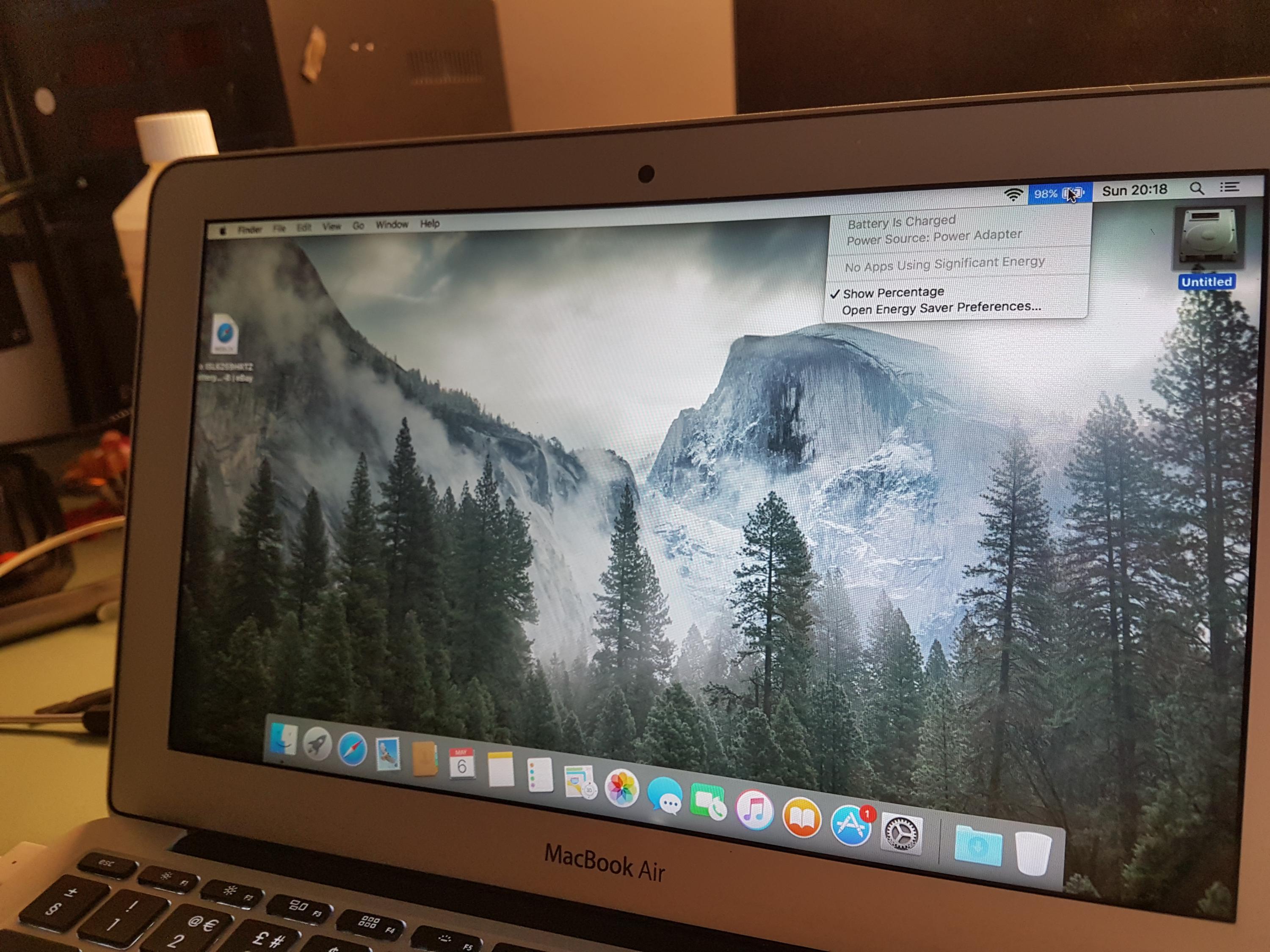

    Hello guys,
    Hopefully someone will shed me a light.
    I have this Macbook Air A1465 820-00164-A which seems to work on a charger but wont charge. Interesting thing is that battery icon shows it as charging and connected to a power source. But battery not taking charge and there is no charging light on the adapter either.
    It suffered a liquid damage with no traces of oxidation on the board.
    It turns on and qorks as expected apart than the charging issue.
    I am planing to order and replace the charging chip, and was wondering if anywhere else i should look first. Voltages provided seems to be okay.
    Schematic and board designs can be found here http://downloadsekarang123.blogspot....schematic.html
    Hope you guys will have better ideas than me.

    Re: Macbook Air A1465 Not Charging after liquid damage
    replace SMC, this IC is programmed
      Look at Louis Rossman, he probably has something about this...
