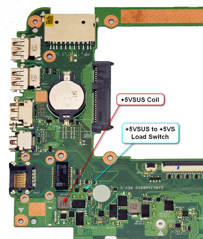

    So i've been working on a board of mine from an asus laptop. I've checked for shorts to ground which there are none. 5v 3.3v 1.5v and all power supplies are operating at their correct voltages. However when i got the laptop there was a blown SOT363 what looks to be a double mosfet. I've since replaced it but i still have issues. On the 5 volt rail, the fan does not spin, and one of the USBs doesnt power up. I checked the 5 volt rail there with my multimeter and it says 1.66Volts.
    Does anyone know what could be causing such a drop of voltage? Is there some kind of faulty controller that would cause it to be like this? For reference, the rail shows 1.66volts while the power supply coil on the board shows 5 volts. Any help would be much appreciated. Thanks!

    Re: ASUS G771JW 5 Volt switched rail undervolted/missing
    this seems simple to solve (probably). trace the rail from the 5v coil to the point of 1.66v. and find the point where it drops. use the boardview if it is available in the Internet.

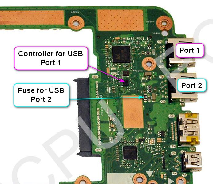

          The fan is supplied by +5VS. And +5VS is enabled by a load switch (RF4E080BN) connected to +5VSUS. Measure all pins of the load switch.
          USB port 2 is supplied by +5VSUS through a fuse. USB port 1 has additional device charging logic, and is supplied by +5VSUS through a controller / load switch IC (TPS2546). If your problem is with USB port 1, then measure all pins on the controller IC. If your problem is with port 2, then measure both sides of the fuse and/or fuse resistance.

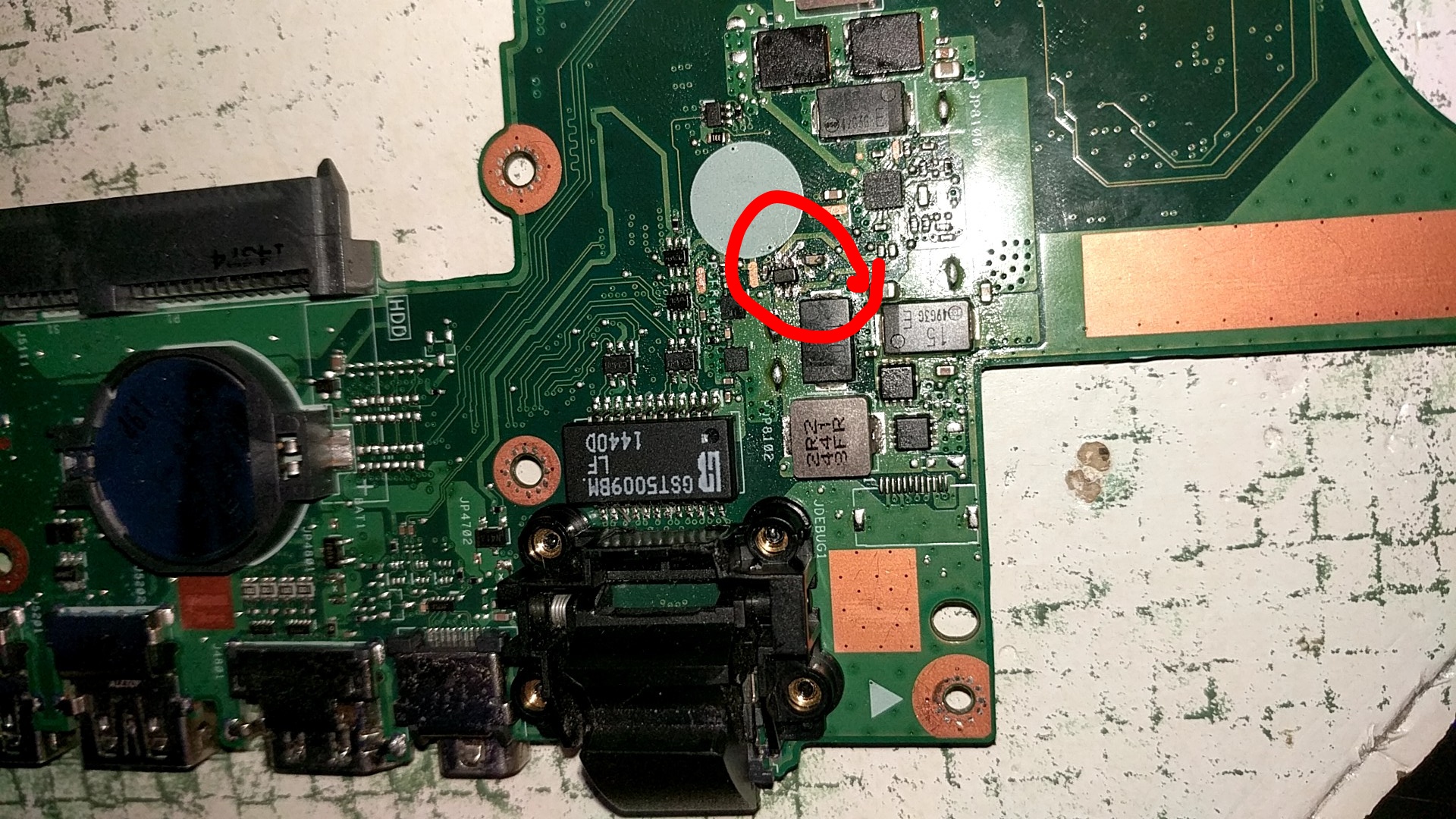

            I tested the load fuse and its the exact component you showed on the board. Before the load switch, there is 5 volts. After that loadswitch there is 1.66 volts. Ive shorted these pins and attempted to turn it on, and for a moment the fan spinned up but shut back off again (Likely as a protection mechanism).
            Perhaps this is relating to another component on the board that was visibly burnt and damaged, which i replaced with a P type sot363 double mosfet i pulled from another board. The pins of this blown presumed mosfet are tied to 5 volt, as well as the 260khz VCLK pin of the DC to DC converter. I have no clue what was supposed to be there, and if it could be the main issue. The original SOT363 that was there, is now a charred mess on my desk xD.
            I have no schematics, or any way at all to know what this SOT363 used to be, i presumed it was a P type mosfet given its location, but now im not even sure.
                I just googled for those images and then cropped them and added the annotations.
                You didn't measure pin 4 (the gate) of the load switch. But it looks like there is a bigger problem...
                The original component was a BAT54S and contains 2 schottky diodes. It's part of the charge pump circuit that generates 12V to be used for switching on various N-channel MOFSETs on the board (including the load switch that I asked you to measure). It absolutely must be replaced with another BAT54S (that "S" at the end is very important).

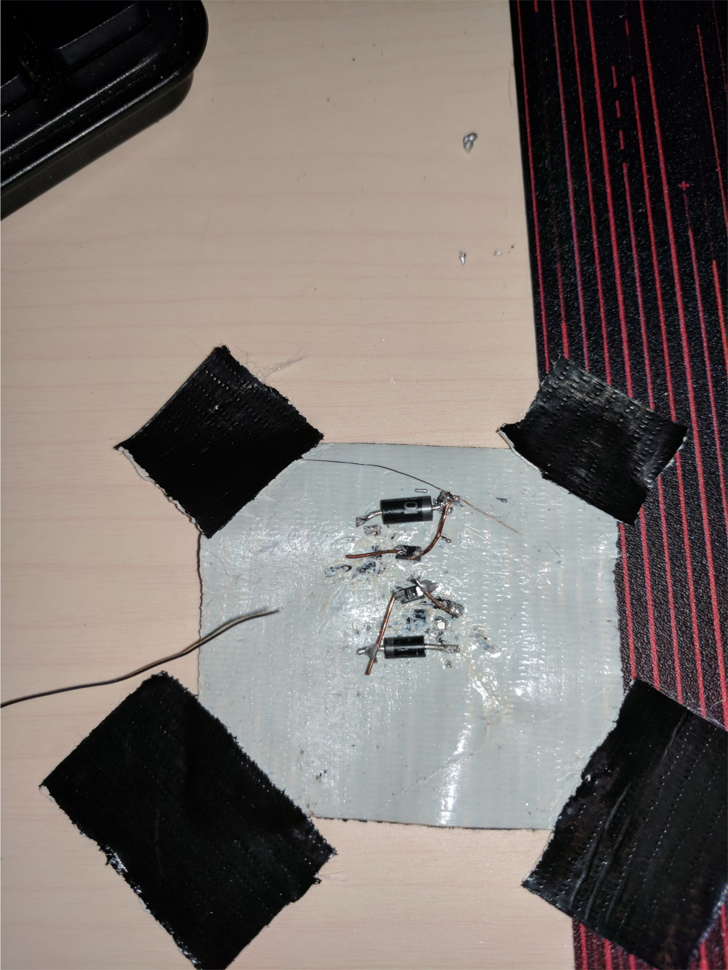

                                    By the way do you happen to have that motherboard diagram of the similar board? Unless of course you paid money for it or something then i understand.
                                    • spirman
                                      • May 2018
                                      • 22
                                      I dont have one of the components on me readily, but i managed to manufacture my own .
