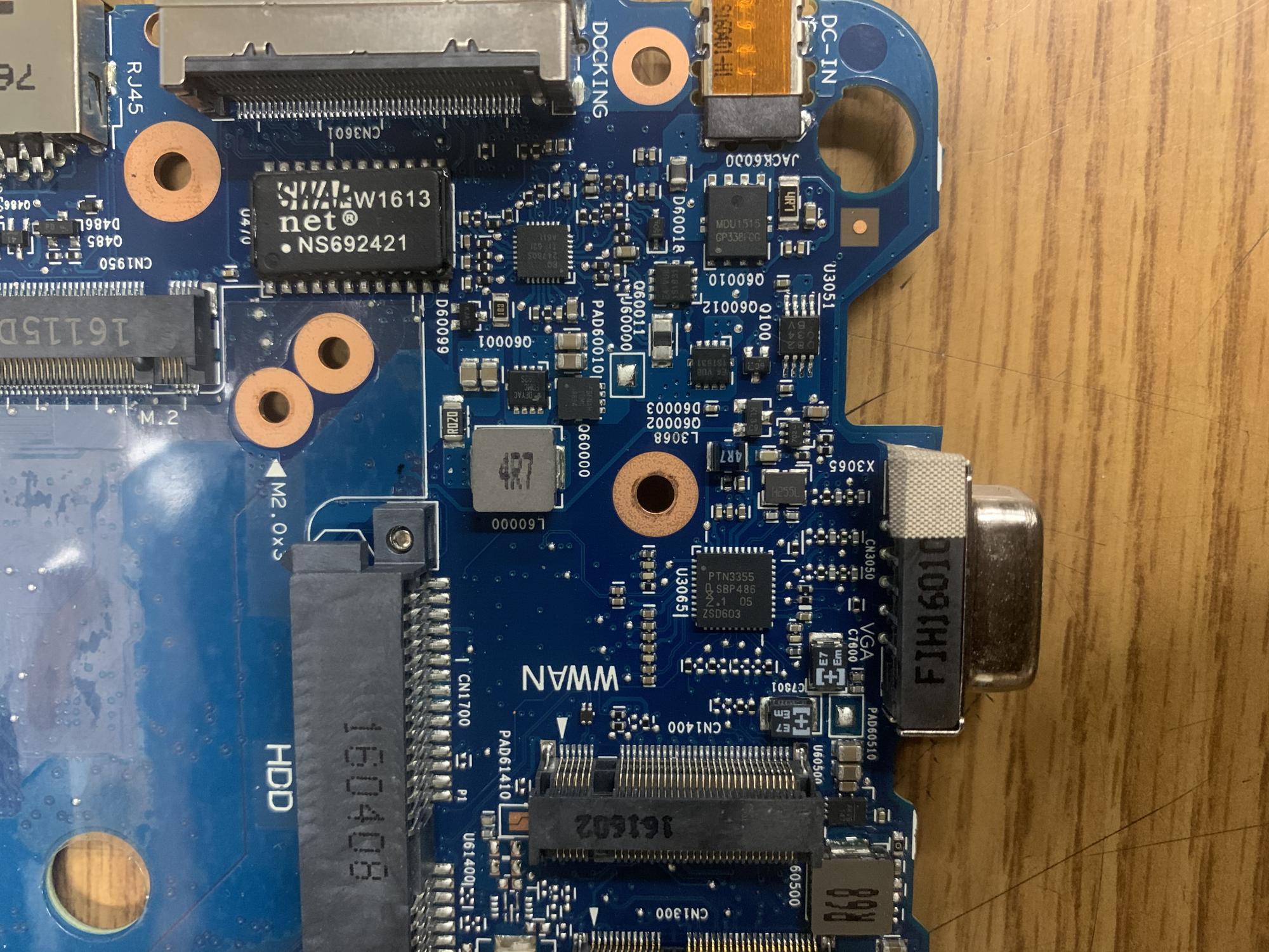

                I have a 640 G2, with the MOSFET at 060010 gone bad (19.5V in, but 0V out from any of the 4 pins on the other side). You've probably realised by my wording that I am no electronics guru! I know enough to know that is not good and am fairly good at swapping board chips
                On my board the MOSFET is an N-Channel Magnachip MDU1515URH, rated 30V and 20.8A.
                I would like to call upon anyone more experienced than me to ask, what chip can I replace this with? Can I exceed the Voltage? Can I exceed the rated amps? What are the risks?
                I need to buy a replacement from the UK, but can only find MDU1515URH from China (6-week wait!).
                I noted another poster showed his bad MOSFET and it was marked 8888 (is that an FDMS8888?). This is rated 30V maximum drain source voltage and 21A maximum drain current. Again, these are only available from China!
                If anybody can help me find a compatible chip which is available on UK ebay, I would be most grateful.

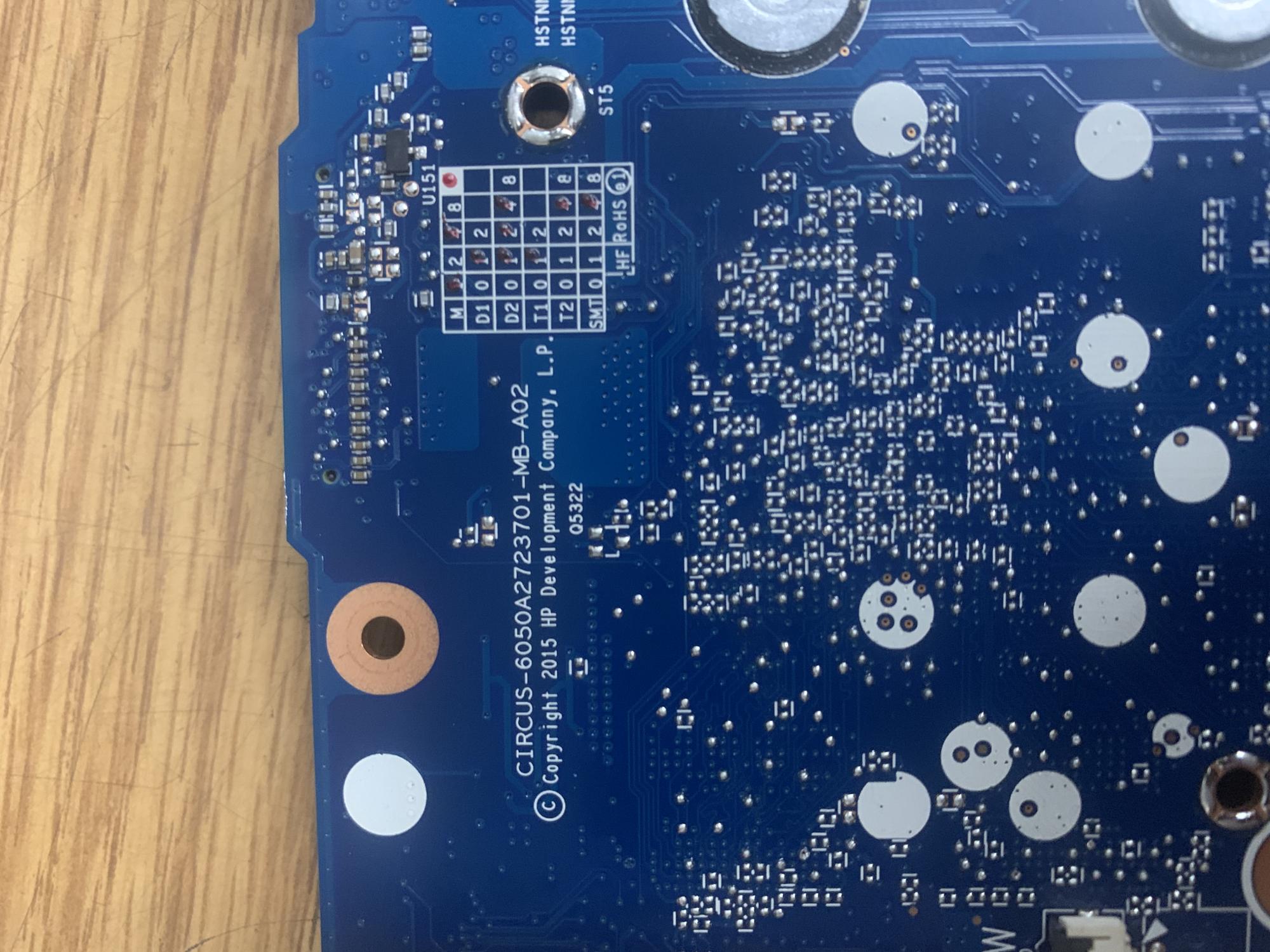

                          Re: HP Probook 640 G2 dead
                          I just got this laptop and it will not power on.
                          Power supply is good.
                          Can somebody let me know where some test points are?
                          I do have 20vdc at the 4R7 resistor next to the power plug.
                          The symptom is that the laptop will not power on.
                          Get just 1 flash on keyboard.. power Key and speaker wifi.
                          Its not battery or charger..
                          Tried it with battery and without battery.
                          will not boot up with Windows and B key plugged in without battery.
                          So.. i pulled the motherboard to have a look. I dont see physically anything wrong..
                          Not sure if its power issue or Bios issue.

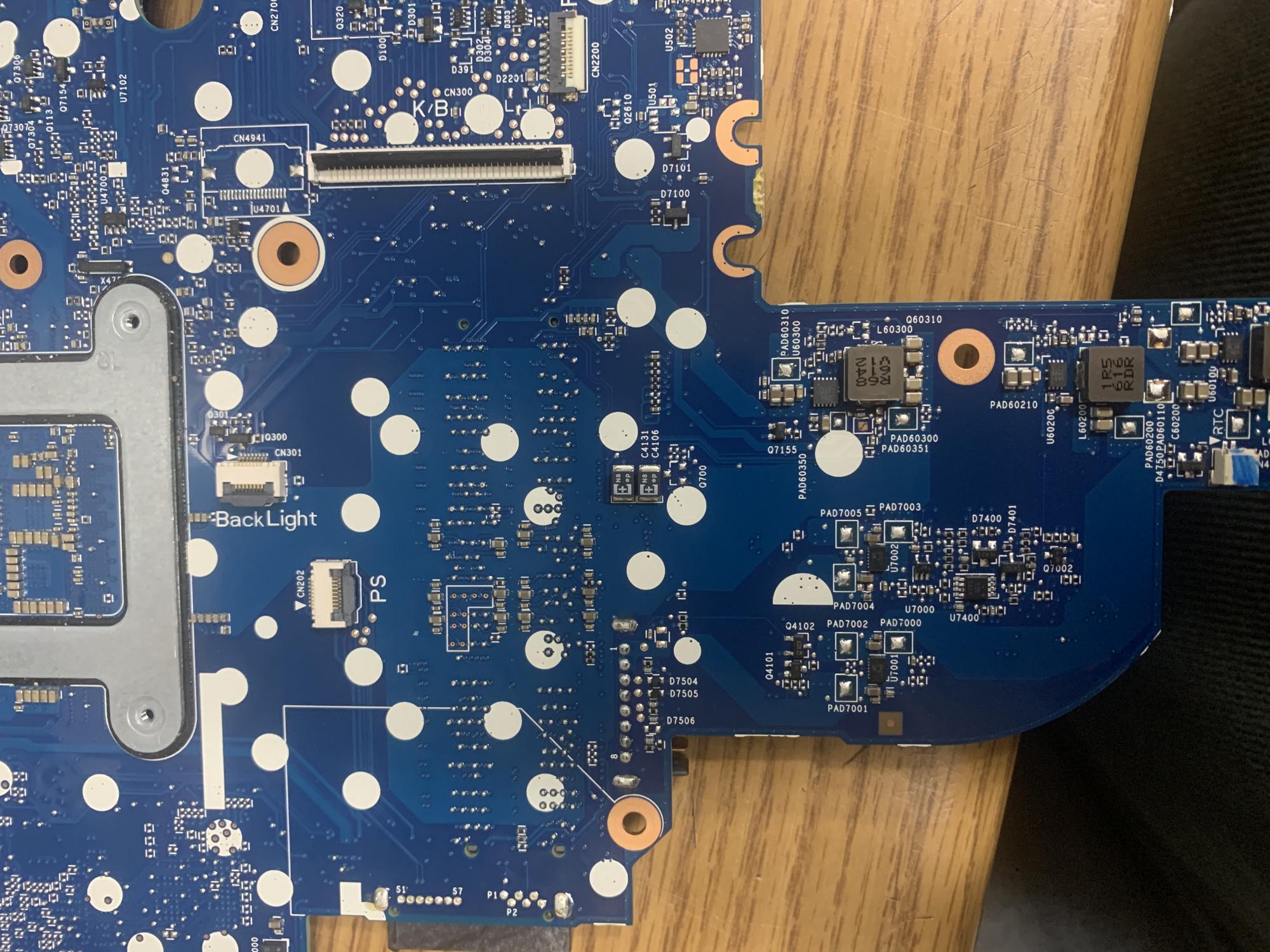

                            Pad 60800 has 1v.
                            Pad 60810 has 20v.
                            Pad 60500 has 0v.
                            Pad 60510 has 20v.
                            Pad 61410 has 20v.
                            Pad 61400 has 0v.
                            Pad 60011 has 20v.
                            On flip side of board:
                            Pad 1411 has 3.3v.
                            Pad 7100 has 1v.
                            Pad 4500 has 1v.
                            Pad 300 has 3.3v.
                            Pad 310 has 0v.
                            Pad 7005 has 5.25v.
                            Pad 7004 has 0v.
                            Pad 7002 has 0v.
                            Pad 7001 has 3.3v.
                            Pad 7000 has 3.3v.
                            Pad 7002 has 5.25v.
                            Pad 60210 has 20v.
                            Pad 60200 has 5.25v.
                            Pad 60110 has 5.25v.
                            Pad RTC60100 has 3.3v.
                            • Rockton
                              • Dec 2020
                              • 27

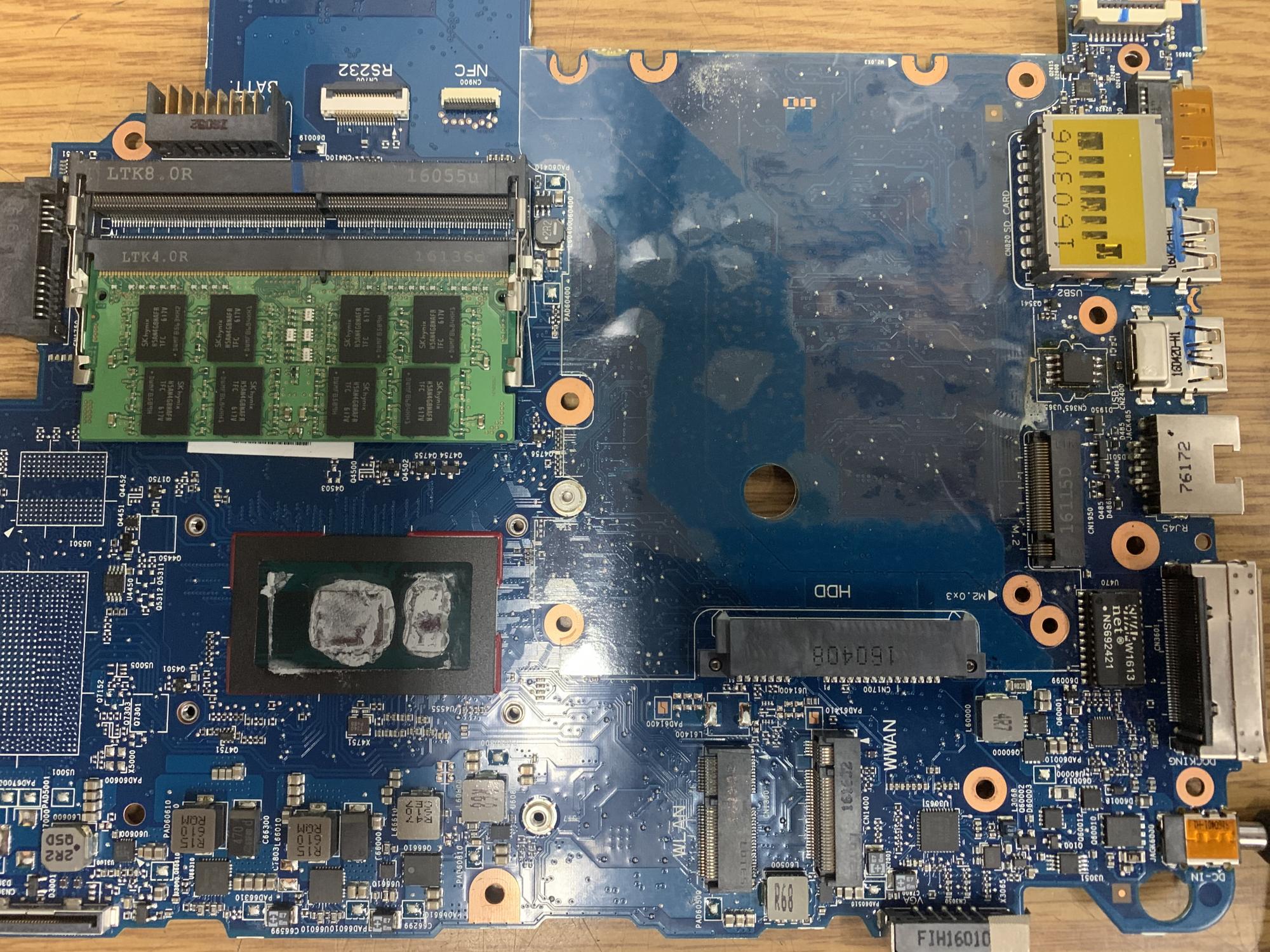

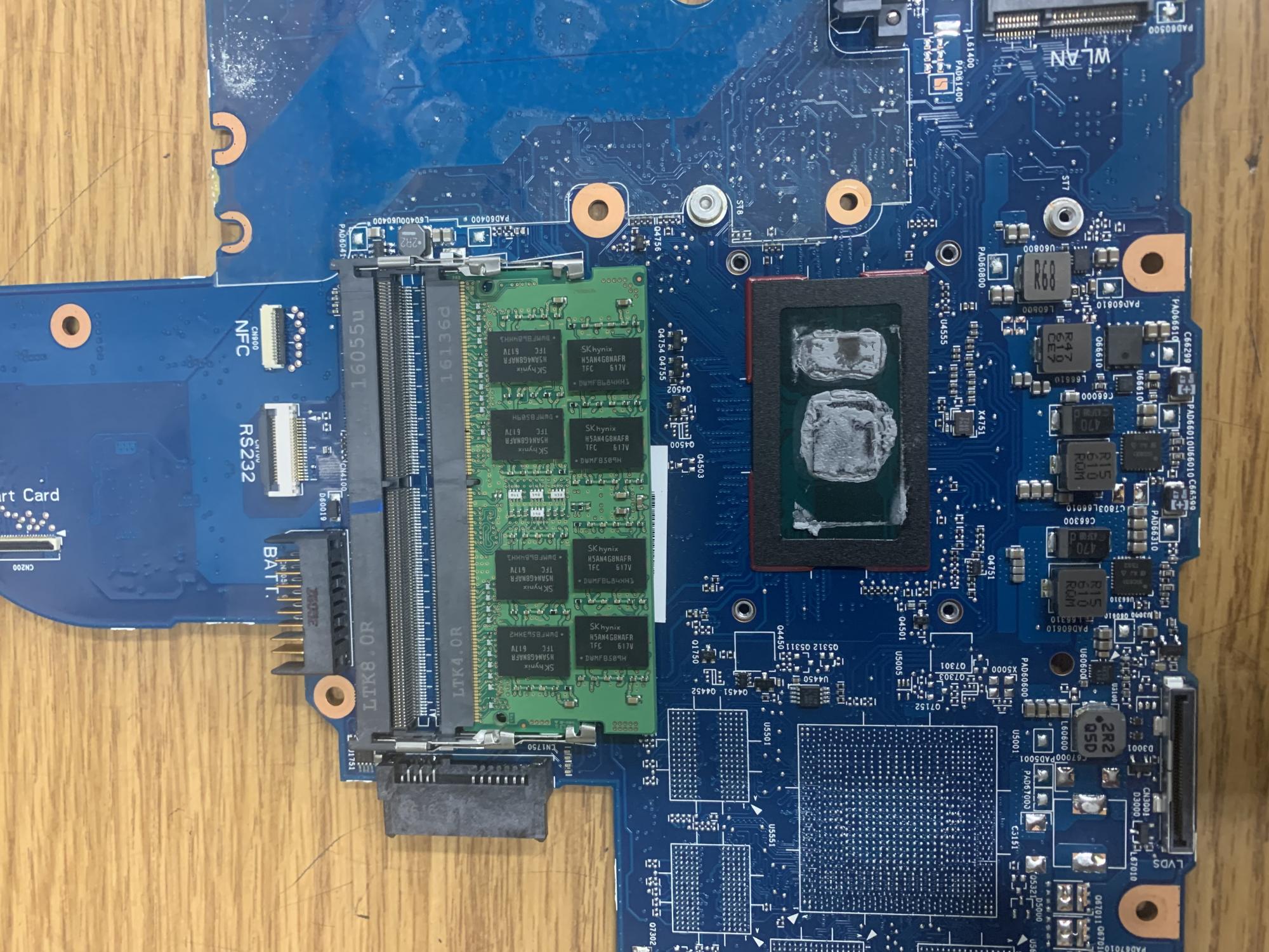

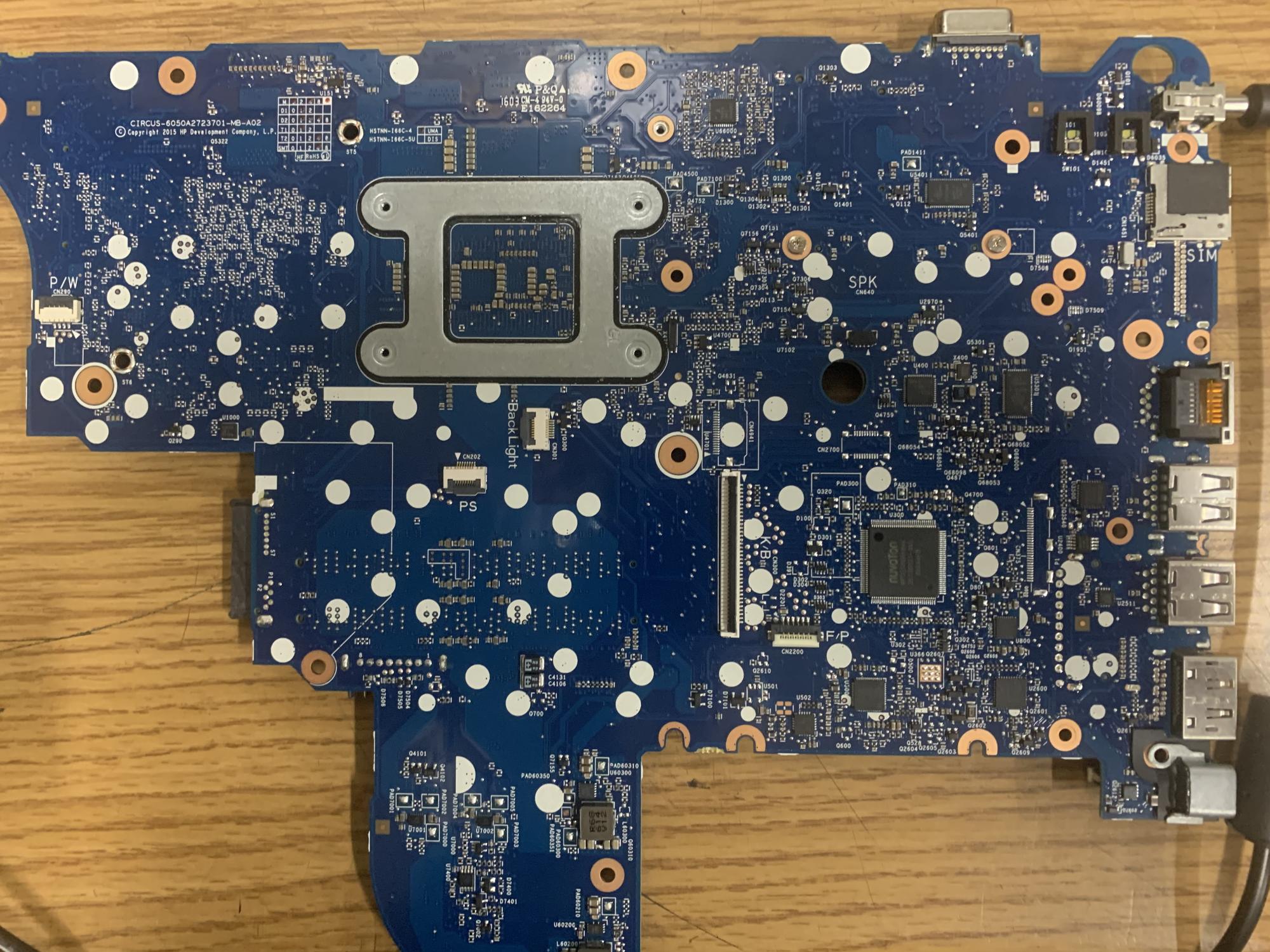

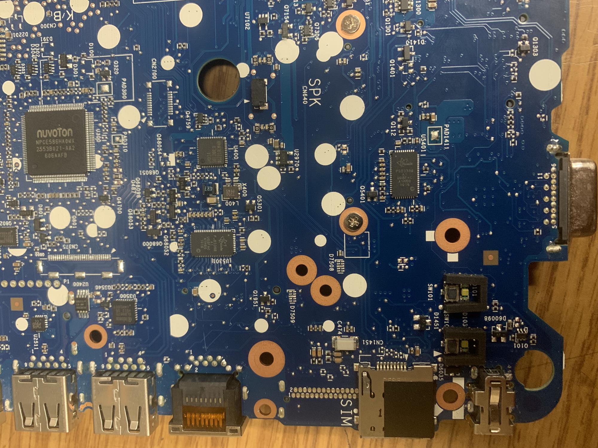

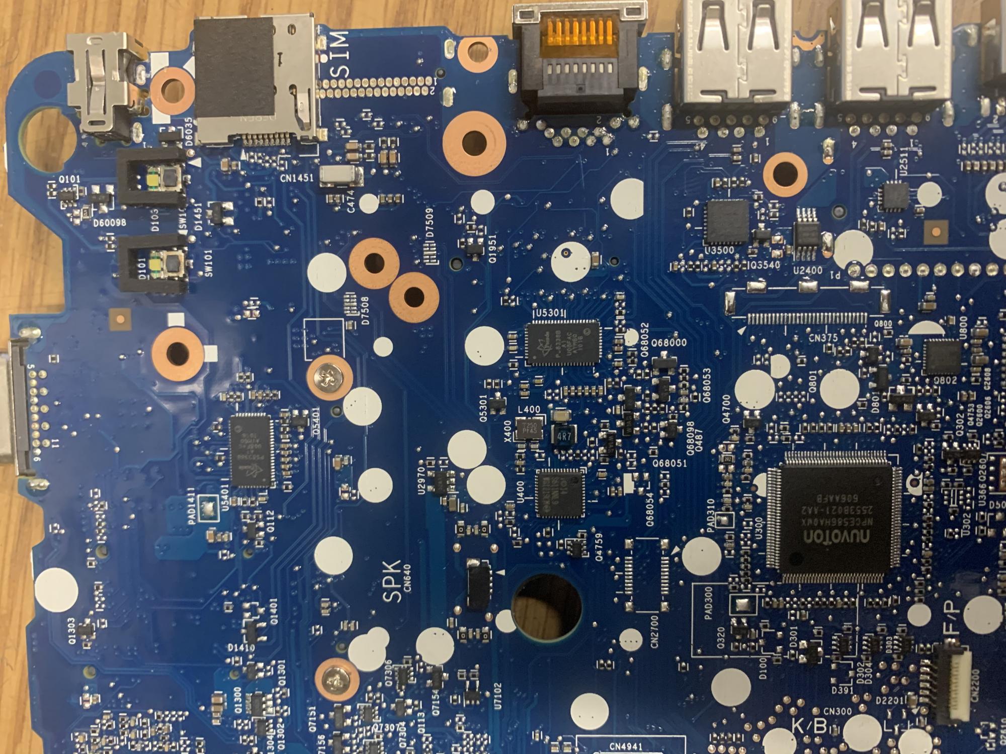

                              Picture of both sides of MB

                                060010 Mofset MDU1515 Has 20vdc on every pin except pin 4 which as 26 VDC
                                • mcplslg123
                                  • Jun 2015
                                  • 7262
                                  • india
                                  if it is dc-in mosfet, pin4 is supposed to be close to 25V. So no issue there.
                                  • Rockton
                                    • Dec 2020
                                    • 27
                                    Pin 4 is the gate voltage so I assume it’s going to some power control chip. . I am guessing that this mosfet is there just in case you plug in a power supply that’s not Center positive.
                                    I am curious about the 1 volt Pads.
                                    • mcplslg123
                                      • Jun 2015
                                      • 7262
                                      • india
                                      It goes to your charging Ic.
                                      • Rockton
                                        • Dec 2020
                                        • 27
                                        Ok. I figure the 1vdc goes to the CPU.
                                        So, I think my power to the MB should be ok as I got all the voltages.
                                        Therefore.. my problem might be in the startup chip or bios area?
