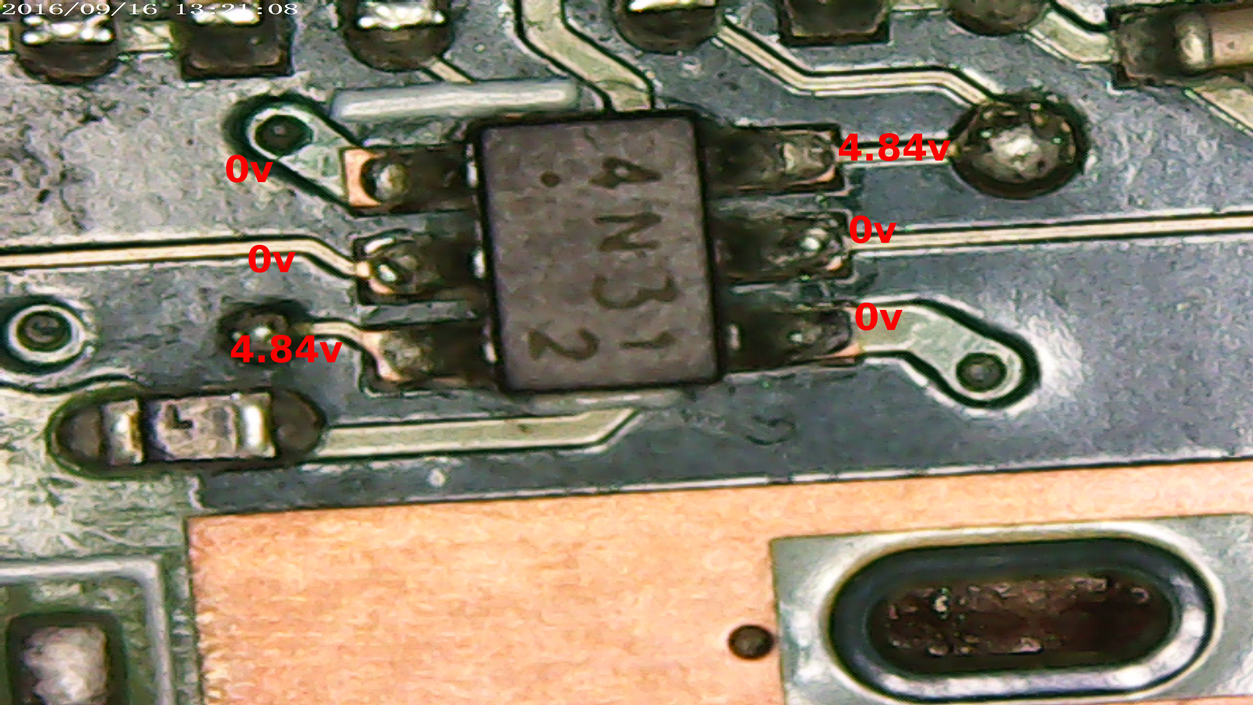

    I have this board, x453ma rev 2.0
    Power LED turns on and off inmediatly after pressing power button.
    I measured all the voltage on UP1589Q, attached image.
    How may I know if this IC is ok?
    No voltage (3.3v, 5v) on output coils.
    Any help or tips on this is very much appreciated.
    Thank you

                From the voltages you have taken on the UP1589Q, two signals are not good ENTRIP1 and ENTRIP2 must be lower than 4.5V to activate channels 1 and 2. If they are higher than 4.5V, channels 1 and 2 do not work. If you look at the repair guide on page 2, you have two signals controlling the UP1589Q, 5VSUS_ON and 3VSUS_ON, these two signals control ENTRIP1 and ENTRIP2 with two transistors in a single 6-pin package, you will find this chip near the UP1589Q, maybe you'll see the K1 mark on it. Measure all the voltages of this chip.

                  This is what I was able to measure
