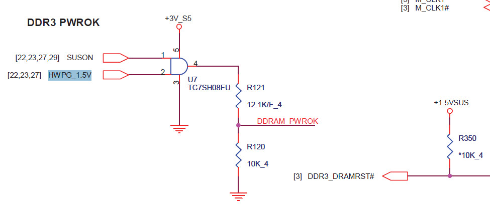

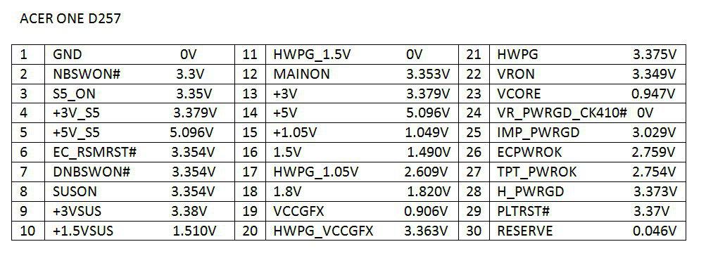

    I have this unit, I checked the voltages on the test point and all are ok, but when I check DDRAM_PWROK it is only 0v? Can you give me the right way of checking a unit that is no display and what are the testpoint that I really needs to test? I already reflashed the bios and reflow the IC but nothing change, I already replace other known ram but same issue. Power on this unit with its current read is about .420 Amp without ram .230 Amp
    This is the measurement I have read on the testpoints

    Hi, what voltages do you have on pins 1,2,4,5 of U7?
      Re: Acer One D257 ZE6 Power On But No Display

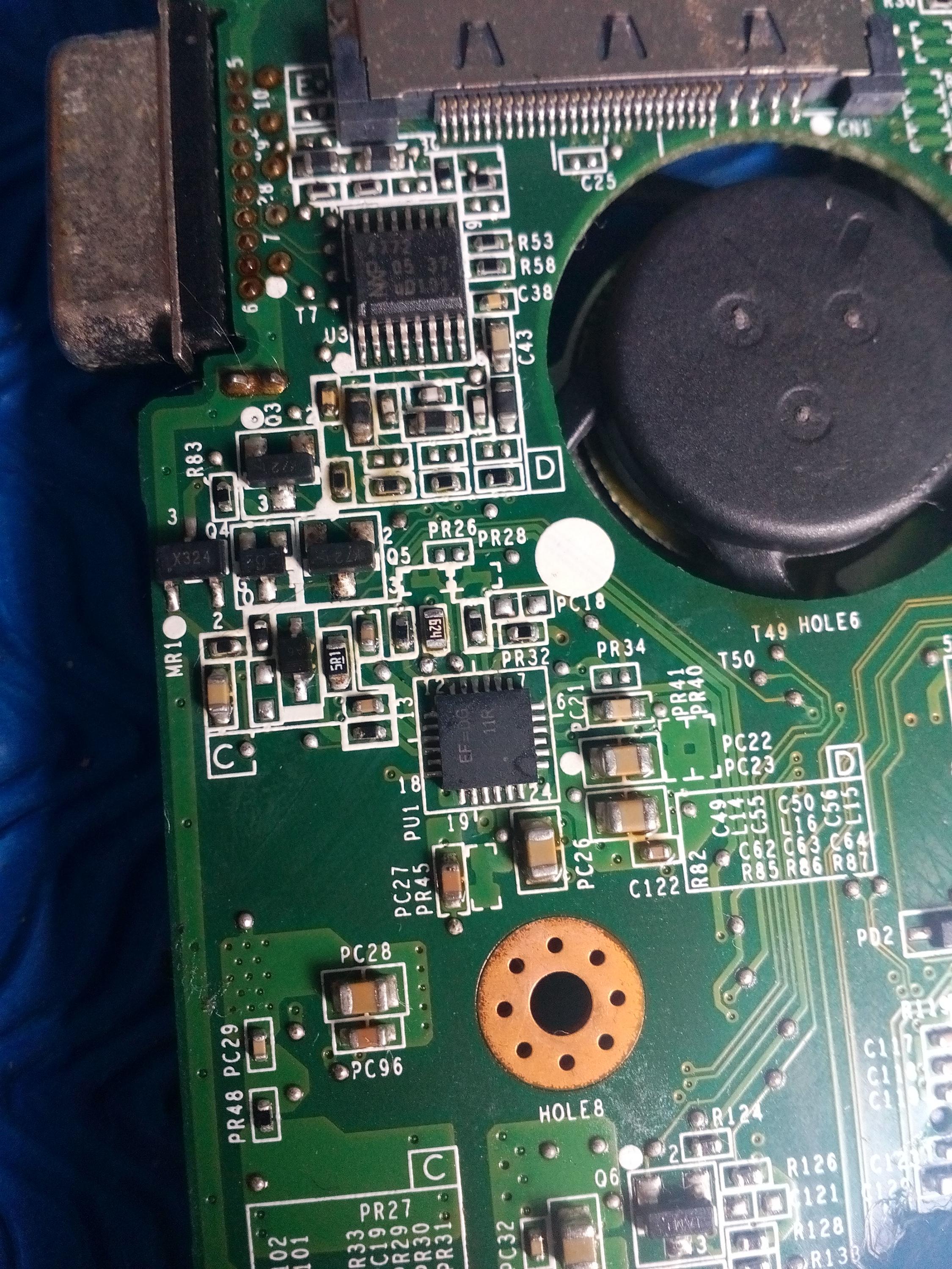

      Check or try replace PR30 (620kohm). Seem its common problem on this series, due sponge which covering led indicator was melted. Also clean all rest sponges on near are led indicator. Hope it work!

        Yeah you are right sir, PR30 have changed value from 620k to 6 megaohms
        U7 Voltages:
        Pin1 : 3.3v
        Pin2 : 0v
        Pin4 : 0v
        Pin5 : 3.3v
          So replace it. What I was understand if ton (pin 12) wasn't good condition due resistor was change value, HWPG_1.5 on pin13 will not appear, even that pin it was pull up from 3V_S5. I believe it will solve your problem.

              After replacing PR30 620K, the display is ok, thank you so much for the help guys. You save my day

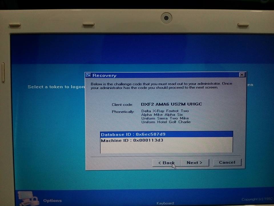

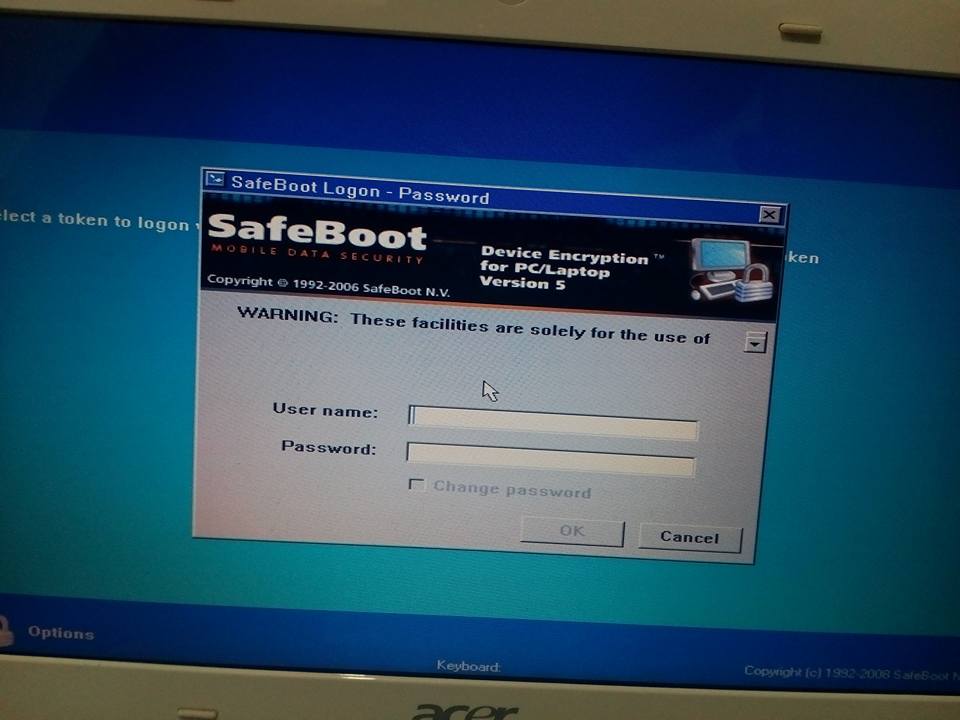

                It is the corresponding problem on this unit, Safeboot Mobile Security appears when I tried to replaced a new Hard disk because the original one is damaged due to continues power on and off while the unit is in no display. I already reflashed the bios but it is still remains.
                Unit is ok, it is a problem on the hard disk installed looks like it is from a server unit.
                Last edited by ronelex; 03-22-2018, 01:55 AM. Reason: Newly Installed HDD is the Culprit
