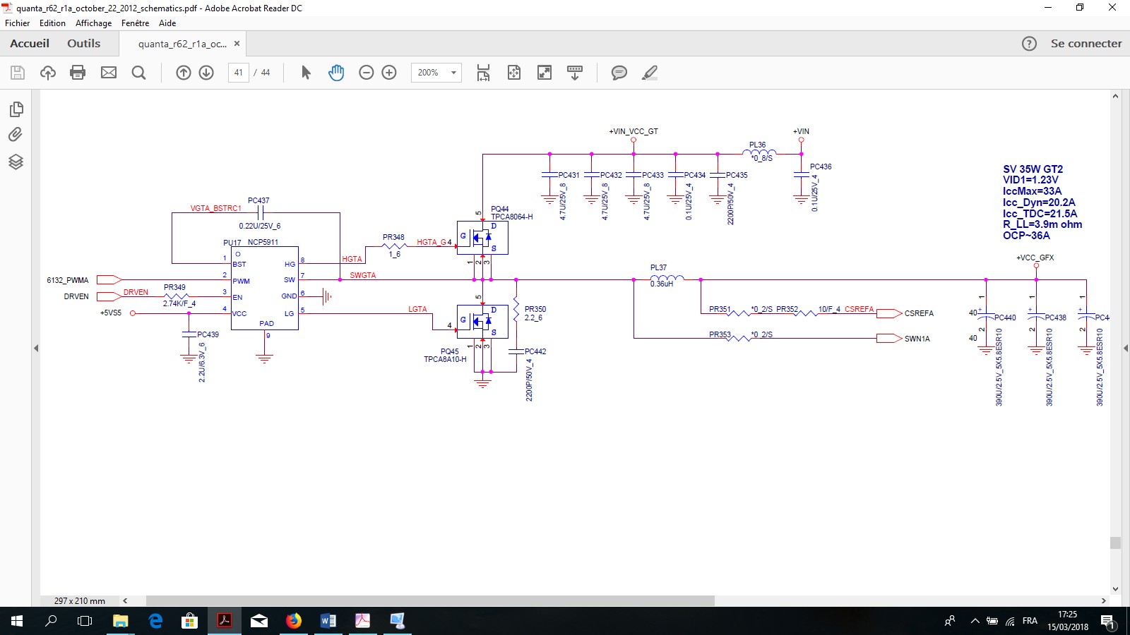

    Guys need help
    got here a problem with this MotherBoard
    DA0R62MB6E0 REV: E
    Hp 17-e047sf
    INTEL
    KBC ENEKB3940QF A1
    laptop starts up but no image found out missing voltage
    PL37 0V +VCC GFX Missing
    PL37 IN DIODE MODE 0.965 fluctuation
    PL37 in Ohms 23.00 K Ohms fluctuation
    PU17 IC
    Pin1 5V Pin5 0V
    Pin2 1.9V Pin6 0V
    Pin3 4.8V Pin7 0V
    Pin4 5V Pin8 0V

      schematic Pic

                    your problem has nothing to do with the bios
                    the IC PU17 has all the voltages necessary for it to work
                    the problem is the IC PU17 that is bad or has a short to the output
                    or either of the two mosfets

                      PYRY thanks for the reply i have test the 2 Mosfets they are good ,after the MAiIN Bios flash last option PC17 but i will wait

                          IC PU17 was faulty
