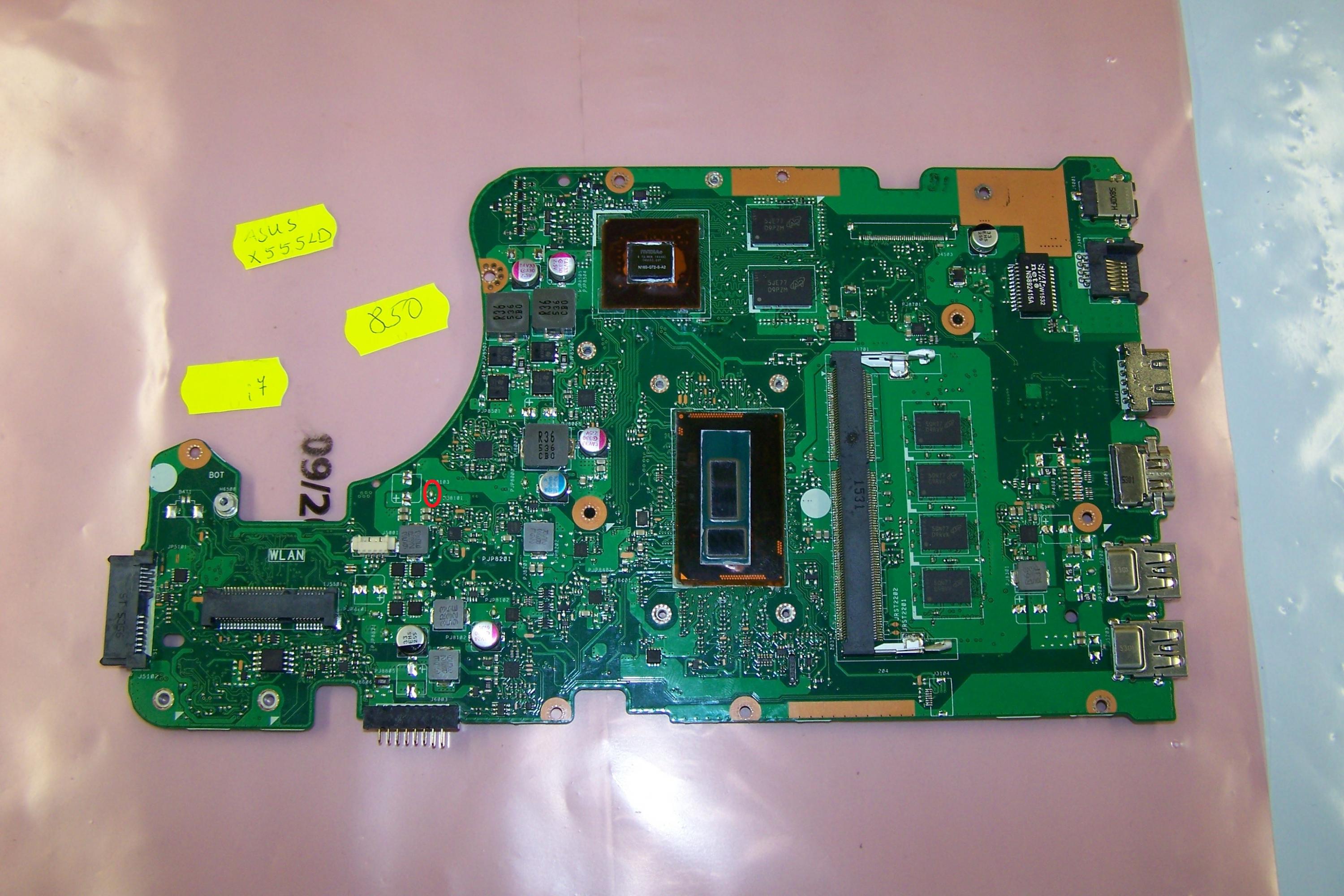

    help me please i have laptop asus Motherboard: X555LD 3.1
    wont turn on
    present Voltage :
    19v
    missing Voltage :
    5v
    3.3v
    * Test coil of 3.3v output i get 2 Ohm
    I Already removed the 3.3/5 ic and test i get same result 2 Ohm
    Where is the problem Exactly Please help me

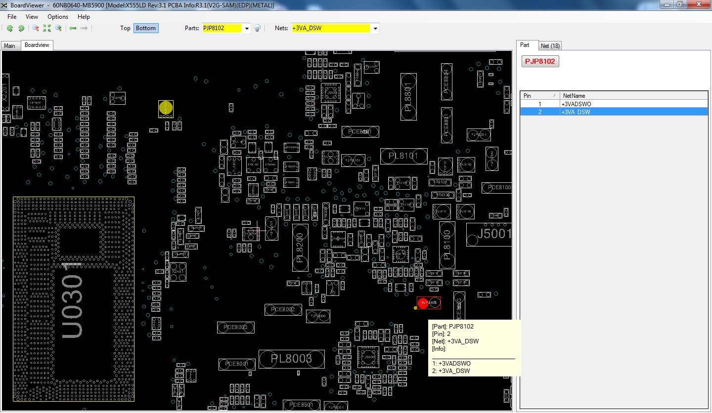

      hey Guys do any one have schematic diagram for this MB PLMotherboard: X555LD 3.1
        Re: laptop ASUS wont turn on
        I find only boardview
            I Confirmed That the step down circuit is good by Removing this Jumper and Allmost Always voltage came
            19v
            3.3v/5v
            3.3v Power Button
            Where is the problem exactly i don't know
