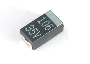

                Without a picture of the board i can't tell. If it's a round capacitor it could be an electrolytic or a polymer. If it is rectangular it is more likely to be a tantalum. Tantalum caps also fail short. They also have a habit of catching fire.

                  I don't have access to that board anymore, but I've attached a picture of what was there I think it is tantalum, as in the schematic it said POLY-TANT and it was rectangular, like the one pictured.
                  So I would just keep one test lead on ground and poke around (coordinately, using the schematics) with the other lead until I found the part that was shorted to ground, right?
