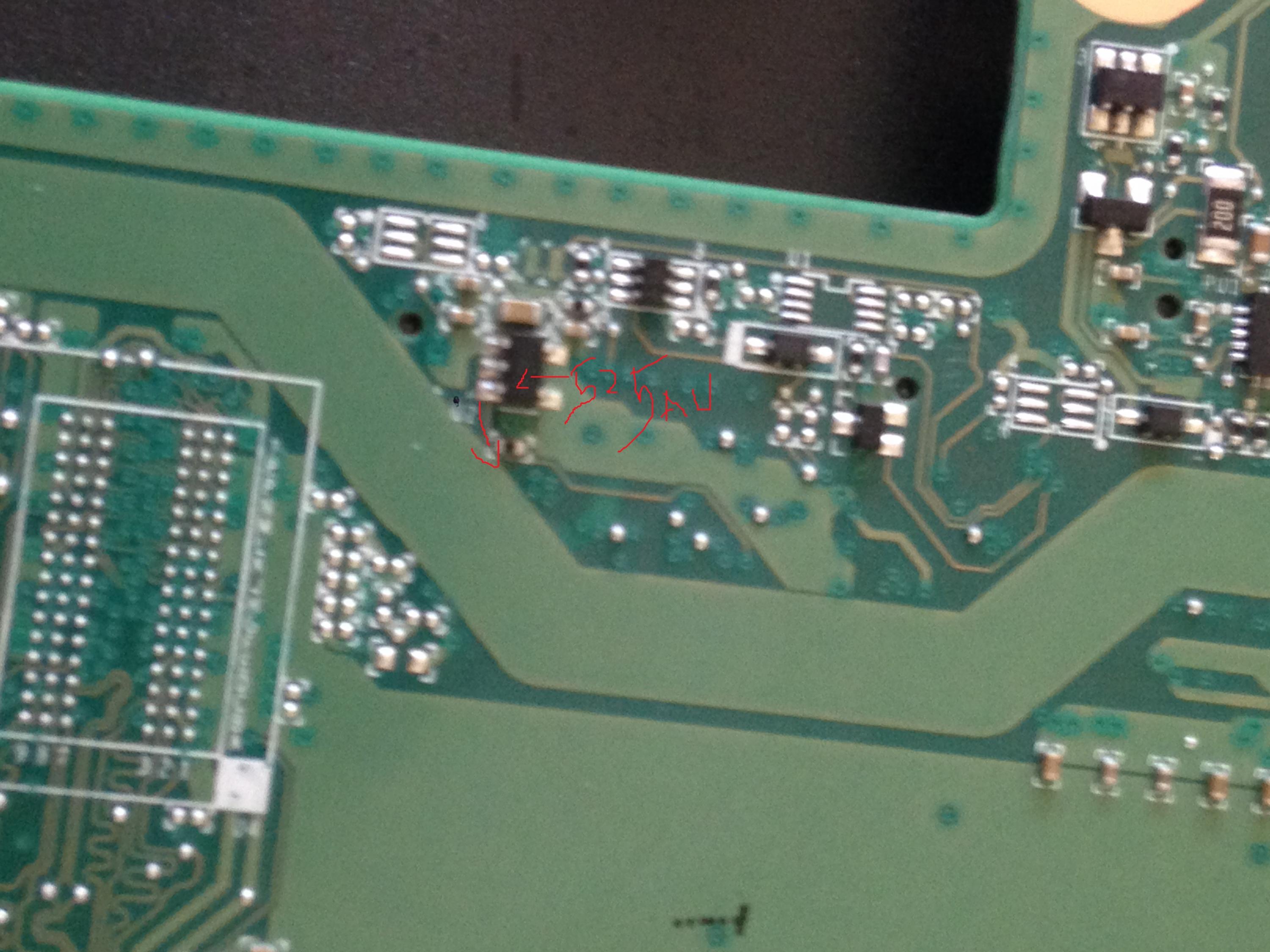

    thanks for the response jarotech yes there is a chip on the backside on the lvds connector it shows 525AU and when i used continuity on pin 35 yes its beeping it is connected

      Is pin 35 connected to pin 1 of this chip?

        Re: acer aspire ES1-432 white screen problem
        yes it is connected pin 35 to pin 1 of the chip
          Ok, you should have 3V on pins 4 and 6, what do you have on pin 3 and pin 1?
            this chip has five legs only 3 on the other side and 2 on other side.on pin 123 there is 0v but on pin 4 and 5 there is 3.3v
              I have the datasheet for the G5243A (523Ax), for this chip the enable pin 3 is active-high, if it is 0V, the chip is not activated. But you have a 525AU, I do not have the datasheet for this one, I don't know if pin 3 should be 3.3V.
                  genenerally input is 3volts and measure voltage at the output.
                  at the time display comes the output will be 3 volts ,it becomes 0 volts if screen trun white
                  if it happens like that,short the input and output of lcd vcc 5pin mosfet.use schematic to identify mosfet
                    thanks for the response arisravi do you mean i have to make a jumper form pin 4 or 5 to pin 3?the problem now is only a second shows good display and then it goes white and for a long time it goes black.i dont have schematic for this model
                          This is the schematics for the ES1-431, and the datasheet for the G5243A of the ES1-431. If you make a jumper from the pin 4 to pin 3 for your 525AU chip, you will bypass the function of the PCH_DISP_ON.
                            thanks for the datasheet and schematic.you are right pch_dip_on will be bypass if i make a jumper.i have attached the image of 525au chip on pin 3 there is 1 resistor and it measures 4.22kiloohms could it be this the culprit?
                              It's hard to say because we do not have the schematics for your ES1-432 and the 525AU.
