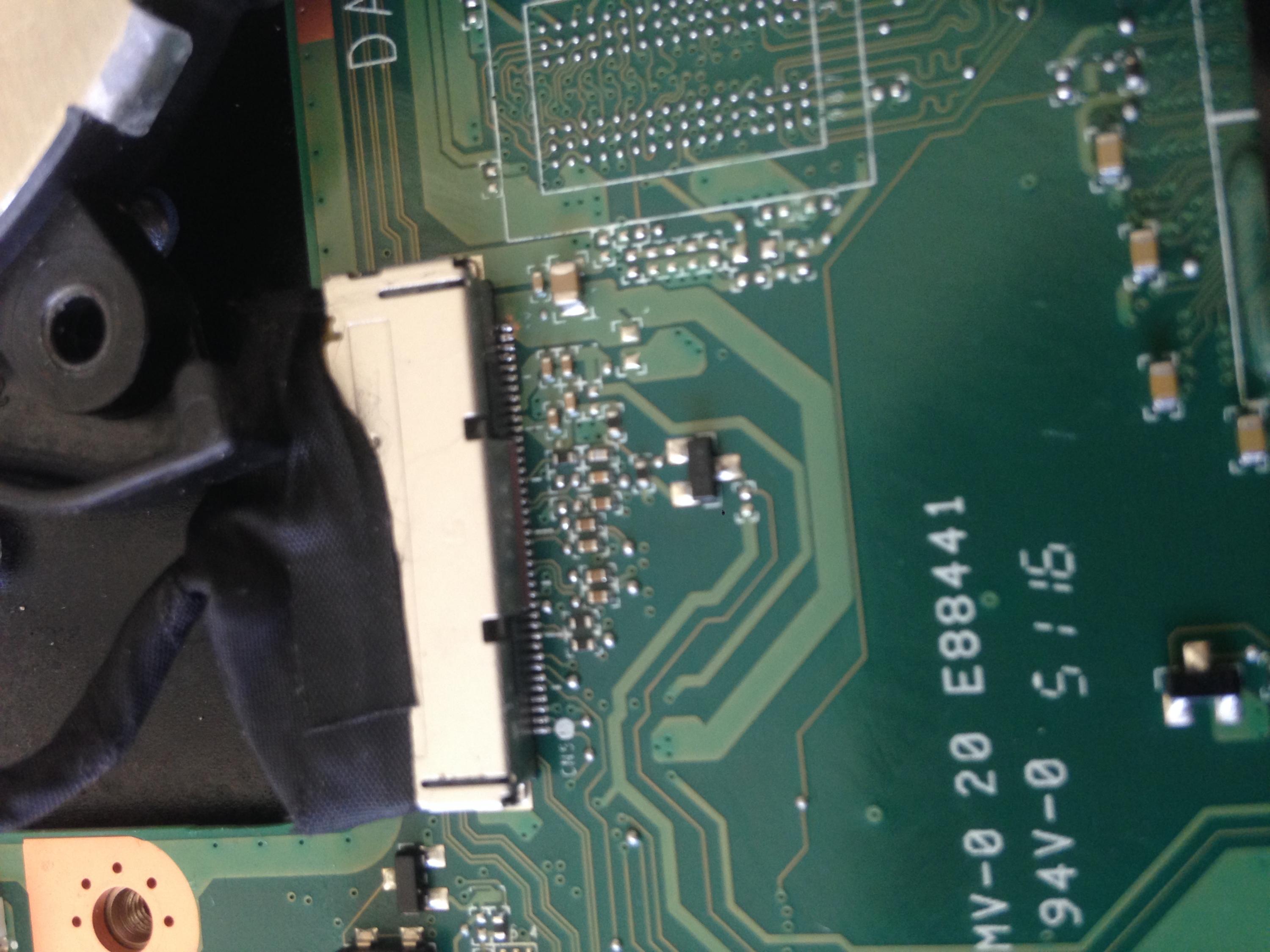

    Hi everyone!I need help on this Acer aspire ES1-432 DA0ZQFMB6F0 REV:F.The problem with this display comes on and after a few second it comes white screen,I already tried replace lvds cable and test screen on other motherboard both are ok but when i plugged in the screen with this motherboard it boots fine shows image,but a couple of seconds it shows white screen.Can anyone help me on this please

        This problem seems really strange. So solving it may take a long time. Inspect the board around the LVDS connector for any hot or corroded IC.

                    Now keep track of voltages on the LVDS connector to see which pins have voltage change when the display switches from being OK to being white and report the pin number. Take a lot of care not to make any short on the LVDS connector.

                        It would help if you take a photo of the board area from the GPU to the LVDS connector.

                            still i haven't solved this issue does anyone have a schematic for this model please.attach is the image of the lvds connector can someone help me please

                              Hi, what voltage do you have on pin 35 of the LCD connector when the screen is white?

                                thanks for the response on pin 35 0v when white screen

                                  I have solved similar issue before and it was due to the LCD_VCC voltage, look for the transistor supplying that voltage and replace it. Or send the board model so that I can help you out with the schematic

                                    Thanks for the response board codeA0ZQFMB6F0 REV:F in the image above i have uploaded there is one transistor before the ceramic caps could it be that one?

                                        Follow pin 35, what is connected to it? Do you have a chip written 523A on it?
