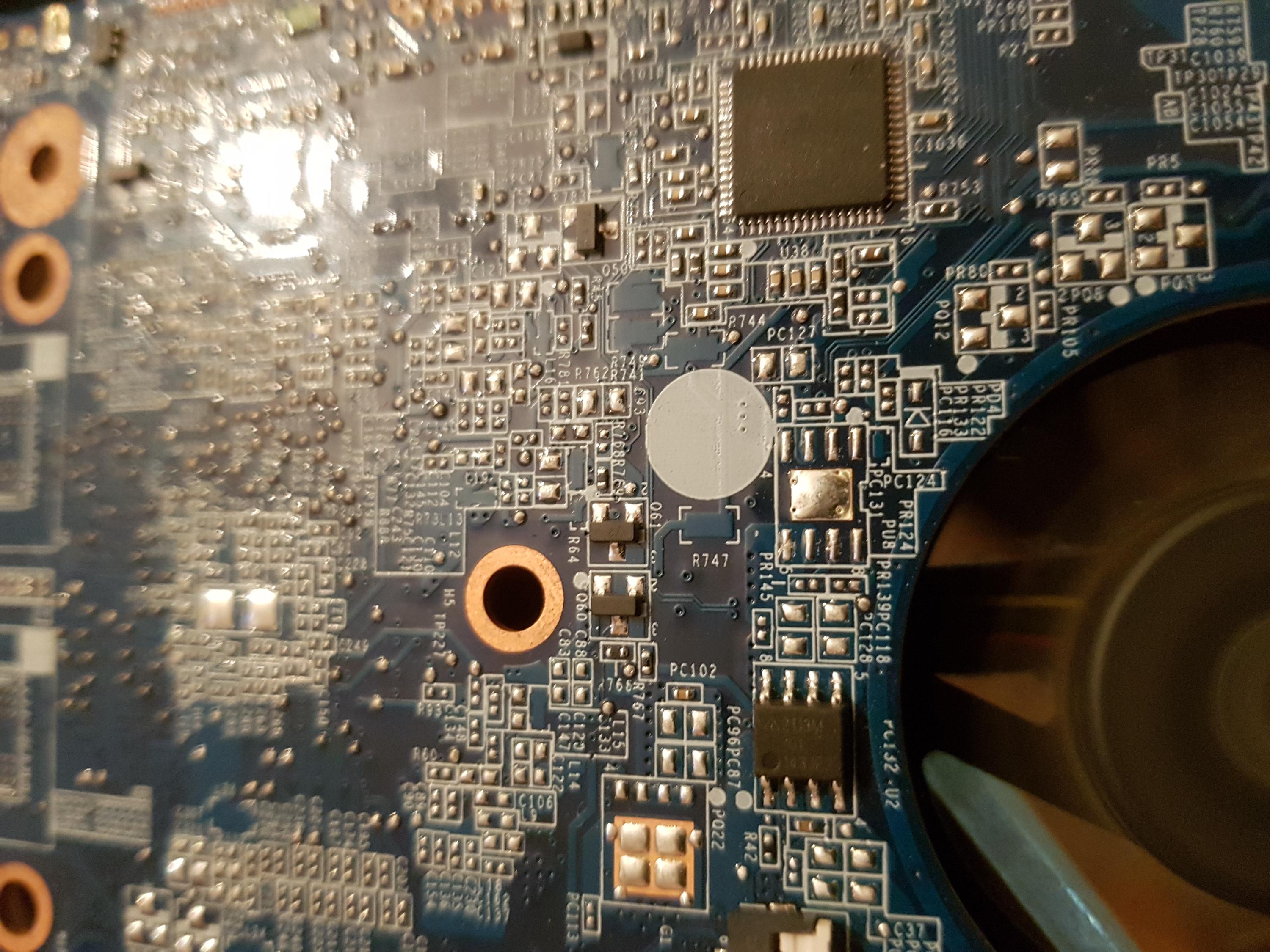

            Re: Hp g6 r23 motherboard fault

            Pu8, pu5, pl22, pq1, pq22 were all bare solder pads with no components fitted, picture attached.

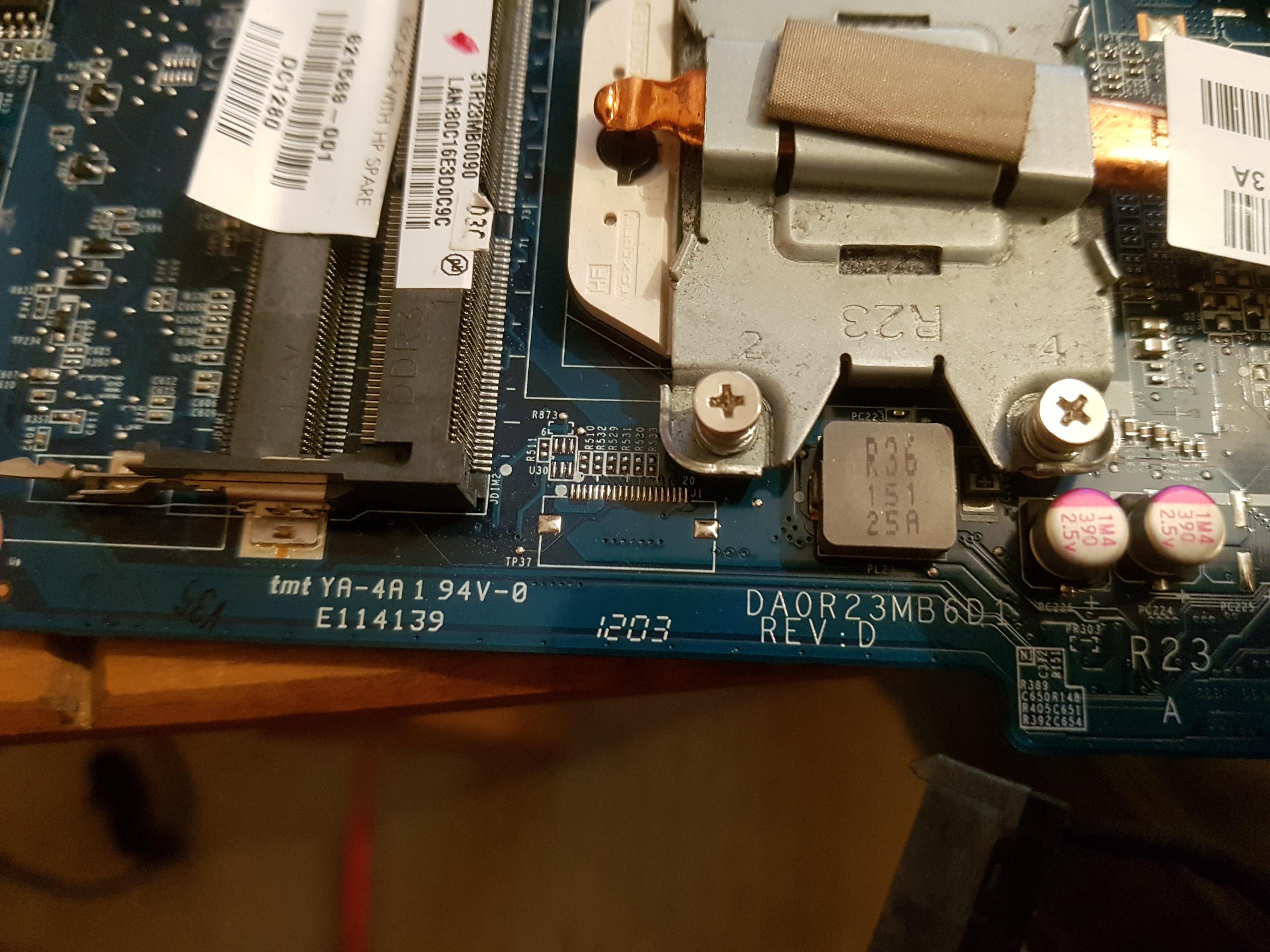

            I also have attached the model of the motherboard incase the schematic is for a different board or is it normal to not have some components fitted? Ie is the schematic for several variants of board?
              The missing components are for the discrete GPU only. This is probably because you don't have a discrete GPU on this board.
