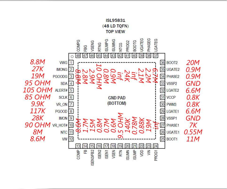

      Just measured again pin 38 and pin 39, now have 930 ohm resistance between them..strange..if power it up again, will be shorted if i measured again.
      Btw i measured resistance to GND of all pins with CPU removed..
      Low resistance at pins 4,5,6,10,19,45 is that ok?

        The best way to determine if that sort of resistance is good or bad is to have a 20000 counts multimeter for better acuracy (but a 6000 will also do) and check a working board then note the results so you know what to expect next time. Or, maybe advice from someone who already found out the correct values.

          Check resistance of these pins on a working motherboard, different IC(ISL95836) ,different pin assigment but the same pin usage, and all are low resistance, so its normal..

                It is shorted because probably of discharge circuitry. That is Normal. Check all your coils for resistance relative to ground.

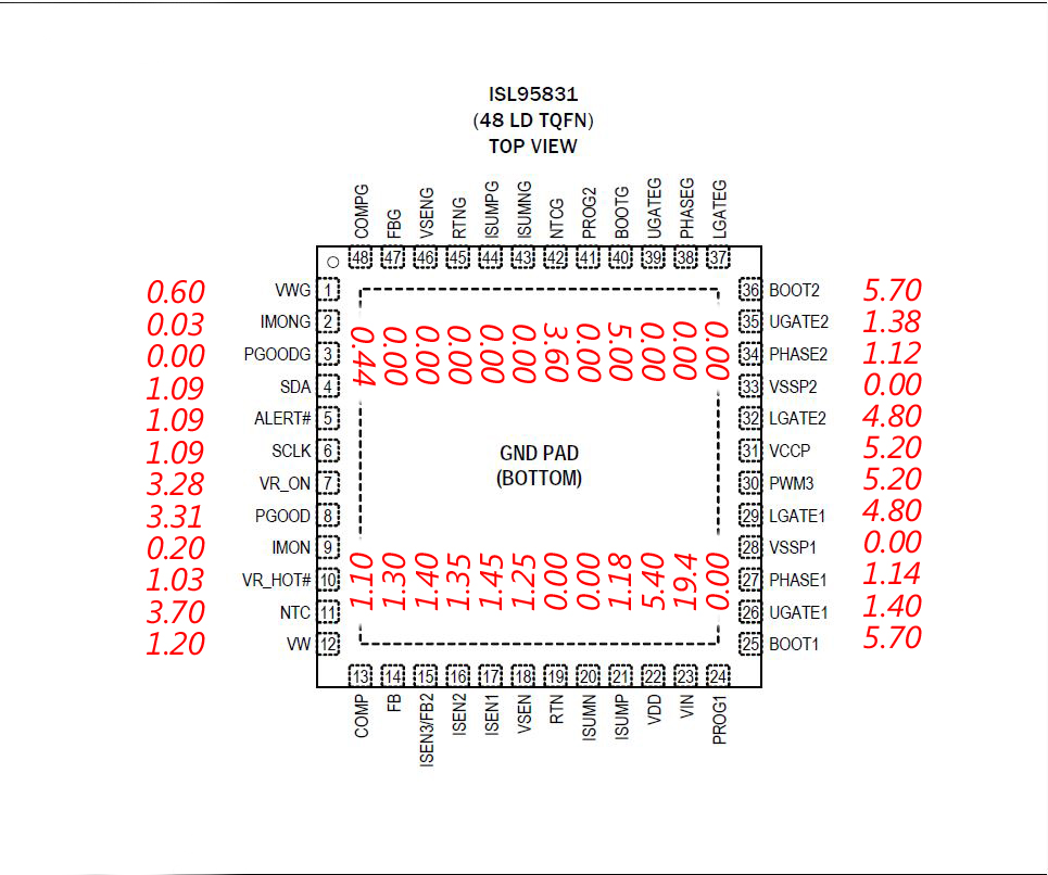

                            Re: Asus A15HC shorted CPU voltage
                            Hello again
                            I also attach voltages of each pin when power is on(before shutting off and on loop)
                            Why pin 1 and pin 48 has low voltage, comparing with pin 12 and pin 13?
                            Maybe the reason for no VR2 output?
                              Try another cpu and reprogram bios. Phase 1&2 output ok, pgood high, everything should be good with it.
                              Also PCH might be bad.
                                Hello again
                                One year past and decide to start troubleshooting it again, finally the problem was from bad bios, i had test that before, read bios and verify commands was success, at hex editor was looking ok so i move on to this, but now after i reprogram it, as khaahk suggest, system is up and running
                                Thanks everyone for help, problem solved!!
