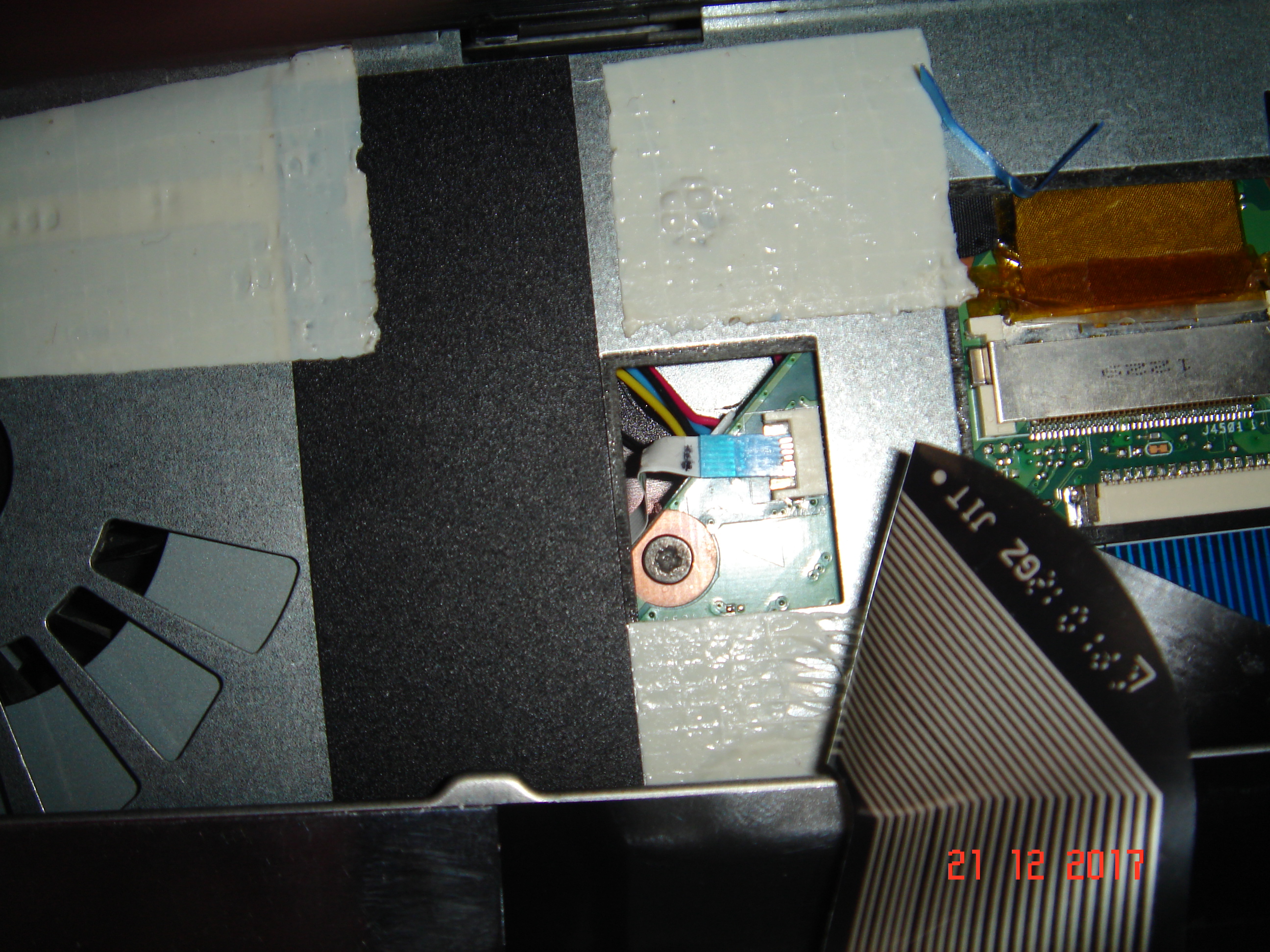

which idea to socth the ffc cable in place
  • passete
    Living=Sharing
    • Jun 2015
    • 487
    • France
    any tips are welcome
    thanks guys
  • tibd
    • Oct 2014
    • 189
    • Sweden
    Re: which idea to socth the ffc cable in place
    ur best choice is to buy ffc Cable connector, but important to know the pitch and how many pins. to avoid melting Clean the board of old solder, apply leaded solder and heat to melting pont Before attaching the connector. That way u have the pins left to solder.
    Other choice is to remove old connector, solder the Cable then directly to board after stripping Cable end (using solder iron to strip the plastic.
    • atsio
      • Oct 2013
      • 819
      • Greece
      Find a thick enough plastic cut it to size and use it to squeeze cable connections in place in the connector.
