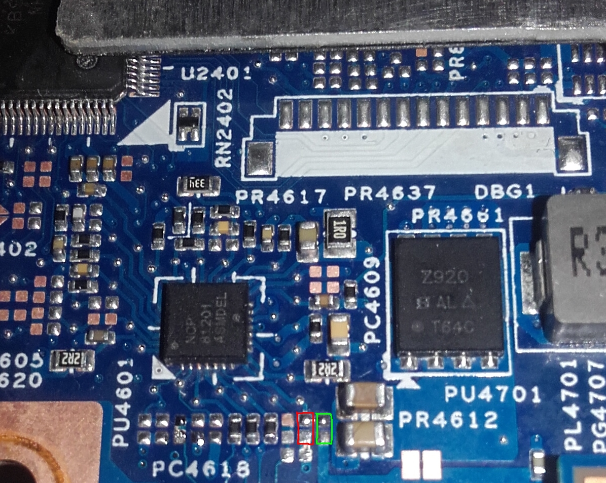

    Hi
    i have this MB with water damage.
    I need the value of the capacitor (red rectangle) and resistor (green rectangle) in the attached picture.
    Thank you

    Try using the attached datasheet. Let's hope the pinout is the same, there is an application schematics inside. I can't see really well on the picture (check that with multimeter in continuity mode) but if your components are connected to pin 7 of the controller, this would be C82 (10nF) and R40 (1k) in the application schematics.

      Re: HP mainboard Panini BSW 15288-1
      Thank you.
      My IC is not exactly the same but of the same "family"; components are connected to pin 7 indeed, so i think i will try the values 10nF and 1kohm.
      Thank you again.
