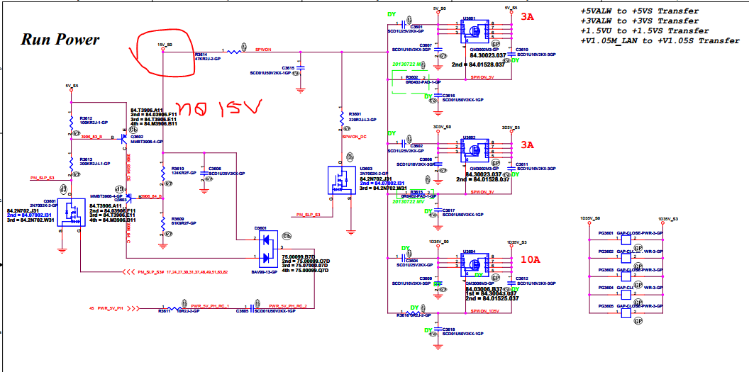

    HP Probook 450 G1 charging white LED Continuously flashing after plgging the charger. I've programmed with fresh bios but still same problem. No 15v in run power section. Some days ago I got a probook 4540s with same problem. I couldn't fix that. Anyone here to help me?
    The schematic is attached with a picture of 15v of page no 36.

              Can someone explain where or how this 15V is generated? Looks to be related to SPWON.
                • 20898
                Re: HP Probook 450 G1 charging white LED Continuously flashing
                That looks like a typing error, it should be 5V_S0 .Look at page 2 of the schematic. SWITCHES , inputs 5V_S5 Outputs 5V_S0

                  That is good to know, that some schematics have typing errors. A while ago, I had one HP schematic with also 15v. Yes, it did measure 5 volts and with no voltage divider I couldn't figure where it came from.
                  Thank you for the learning experience.
