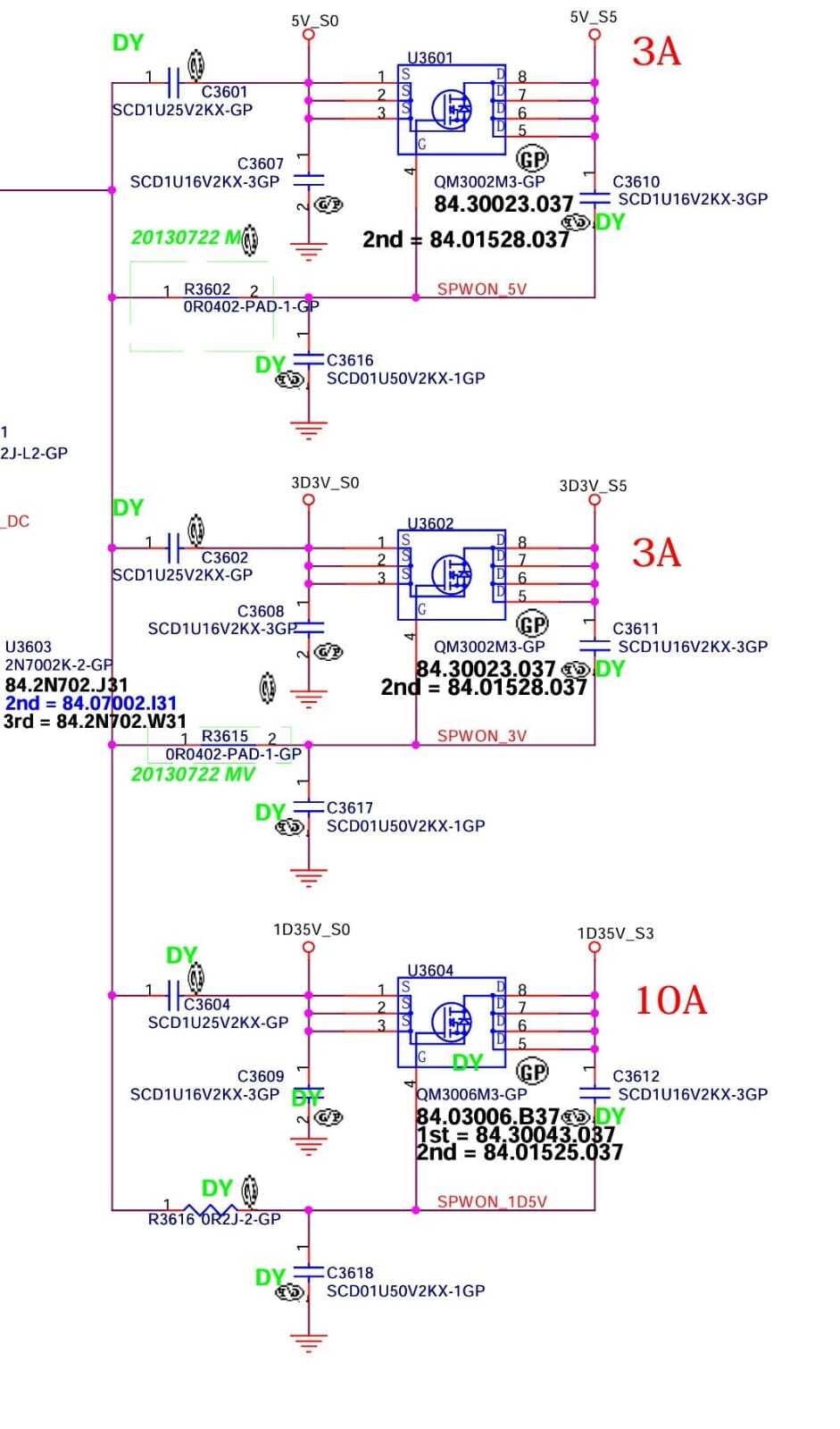

            I mean, does it show an image on the screen?
            What i meant by secondary supplies is this, from page 36, the 5V_S0, 3D3V_S0 and so on

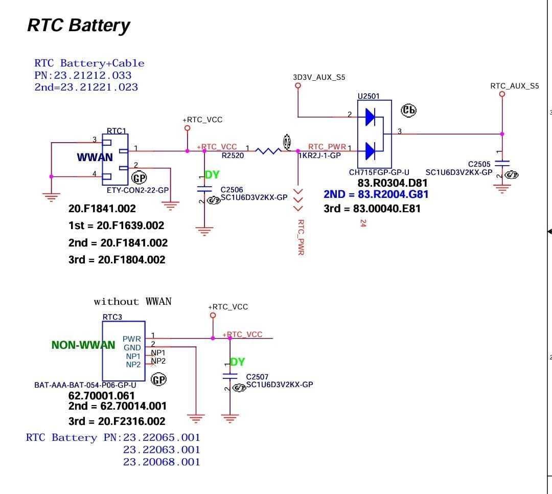

            Also check the RTC voltage, RTC_AUX_S5, page 25 of the schematics, at the output of the dual diode U2501, should be 3v
