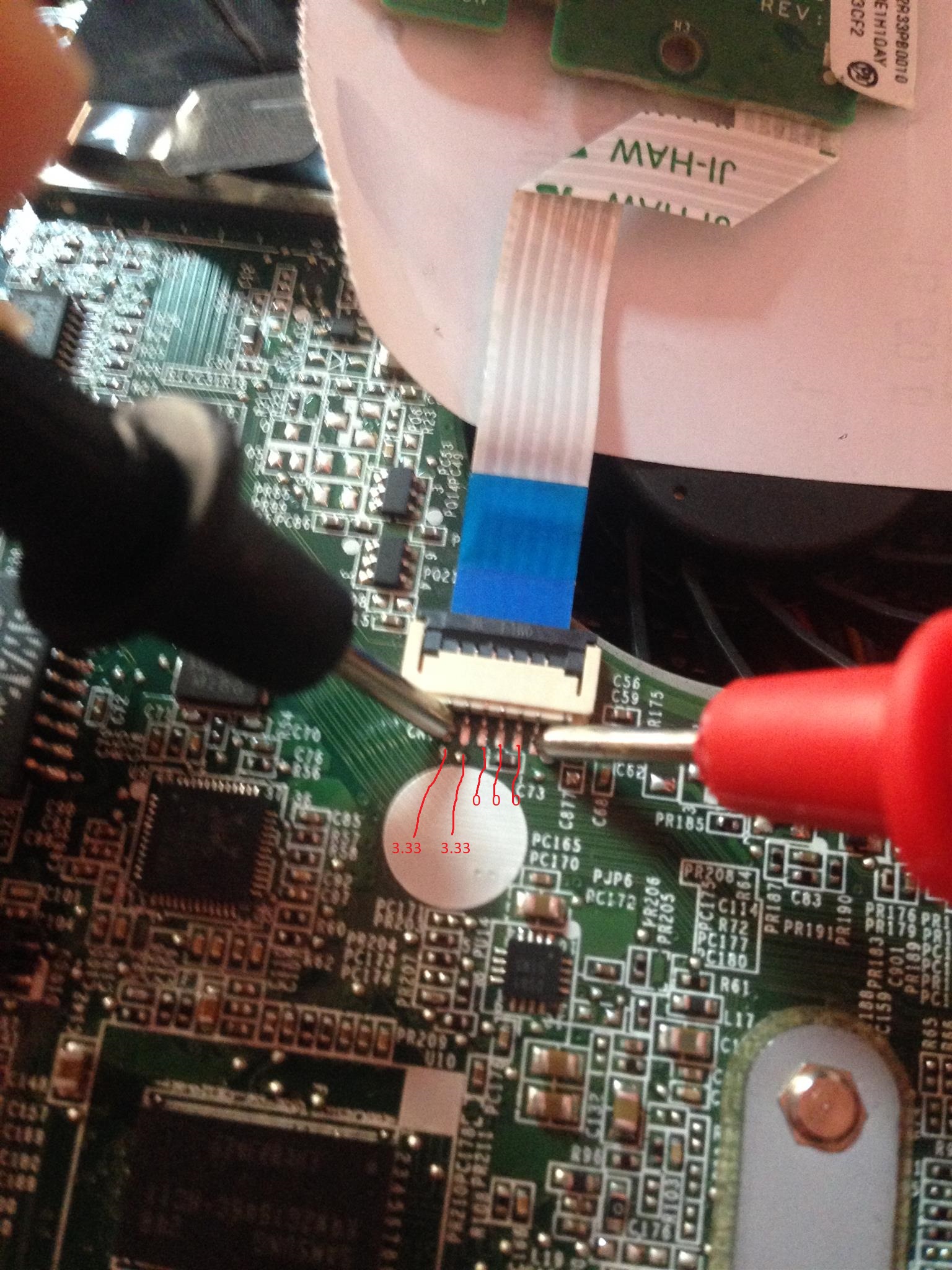

    Hello people,
    i have issue with my laptop, which i can`t repair alone. Problem is : laptop will not start, led light on the dc port is on when is connected to the adapter , after pressing the start button nothing goes on, no fan spinning , no lights coming on (except power port , which is always on). Sometimes (randomly) laptop will start just like that. After that i can use it as much as i want, i can switch it off and on , no problems. if i leave it for awhile off , then same issue, wont start again. I have it already dissembled , so at the moment i`m testing motherboard + lcd + power button + ram. From what i can check with the multimeter so far i can get 19.4v after the power port (picture 1), then at the start button i can get on the first 2 pins 3.33 but nothing on the rest of them. I`m not really sure if i do the measure as it should be done, so if you have patience to explain me how and from where i should start checking components on the motherboard i will appreciate any help, thank you in advance

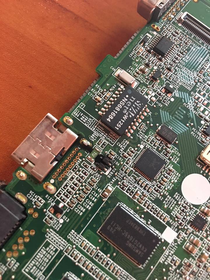

      only thing i could find that i don`t like it is this picture, its HDMI port

        Re: hp pavilion g6 da0r33mb6f1 rev:f starting randomly
        clean it properly....it is just dirt but can be the source of your problem..
          cleaning didn't help, any other suggests ?

              I don't think this is southbridge or PCH problem, more likely to have something to do with EC/KBC, but most likely some liquid damage, could be resistors or an intermittent solder connection. Got a schematic for the board?
                thank you for your help. yes i do have the schematic but i dont know how to read it or what to look for. What i have found so far is that under the keyboard and little on the CD/DVD have a sticky black dirtiness , could be a coffe or cola. Interested is i cannot find anything burn on the motherboard(except the picture ive attached near the HDMI), i got microscope so i`ve check it well.
